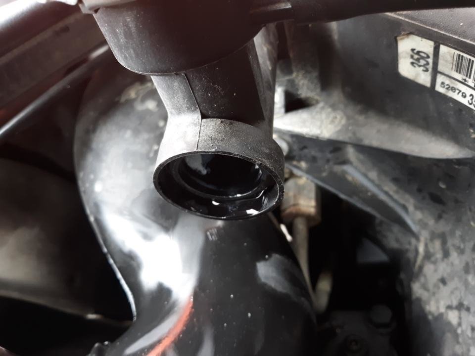

I'm leaking coolant and missing a piece to a part and I dont know what it is.

Can you post a couple more pictures for me to view? It looks like the filler neck but need to be sure.
Saturday, October 19th, 2019 AT 8:18 AM
  • 52,797 POSTS
It looks like the filler neck for the radiator. I attached a picture for you.
It is part of the radiator itself. The entire radiator needs to be replaced.

Well, my dad has the same kind his is the same way. He said a seal is missing.
Saturday, October 19th, 2019 AT 8:28 AM
BRANDON MARTIN
  • 21 POSTS
Someone says rubber expansion plug.
Saturday, October 19th, 2019 AT 8:35 AM
  • 52,797 POSTS
No, it is part of the filler neck for the radiator. It is not available for purchase. It is part of the radiator itself and the radiator has to be replaced.

No, I mean do you have a whole picture of the same radiator? And is the filler separate thing the actual radiator cap?
Saturday, October 19th, 2019 AT 8:49 AM
  • 52,797 POSTS
The picture I attached shows it is part of the radiator. The piece that has failed is circled in the picture.
