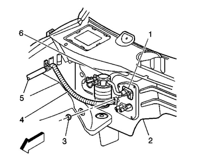

i have a leak running down the firewall on the passenger side of the vehicle. it is in the location of where the heater hoses go through the firewall. i do not see any leaks at the hoses.
Apr 23, 2018 at 3:22 AM

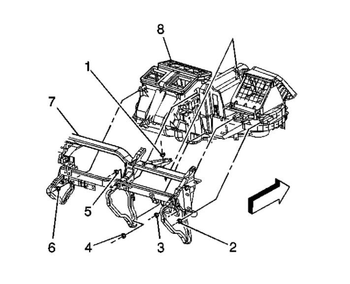

I attached the procedure for you for the replacement of the heater core.
https://www.2carpros.com/articles/replace-heater-core
HVAC MODULE ASSEMBLY REPLACEMENT
TOOLS REQUIRED
- J 43181 Heater Line Quick Connect Release Tool
- J 39400-A Halogen Leak Detector
REMOVAL PROCEDURE
1. Drain the engine coolant. Refer to Draining and Filling Cooling System (Body Vin Code 6) Draining and Filling Cooling System (Body Vin Code 3) in Cooling System.
2. Recover the refrigerant.
3. Remove the I/P carrier. See: Dashboard / Instrument Panel > Removal and Replacement > Instrument Panel (IP) - Carrier Replacement
4. Reposition the heater hose clamps using J 43181.
5. Disconnect the heater hoses from the heater core.
6. Remove the retaining nut (3) from the accumulator (6) at the evaporator (1).
7. Disconnect the accumulator (6) from the evaporator (1).
8. Disconnect the evaporator tube (4) from the evaporator (1).
9. Disconnect all of the electrical connectors to the HVAC module assembly.
10. Remove the HVAC module assembly.

HEATER CORE REPLACEMENT
REMOVAL PROCEDURE
1. Remove the HVAC module assembly. See: Housing Assembly HVAC > Service and Repair
2. Remove the heater core access cover screws.
3. Remove the heater core access cover.
4. Remove the heater core (2) from the HVAC module assembly (1).
INSTALLATION PROCEDURE
1. Install the heater core (2) to the HVAC module assembly (1).
2. Install the heater core access cover.
3. Install the heater core access cover screws.
Tighten the screws to 1.9 N.m (17 lb in).
NOTE: Refer to Fastener Notice in Service Precautions.
4. Install the HVAC module assembly.

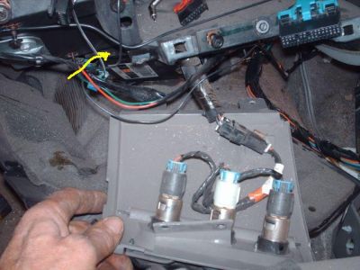

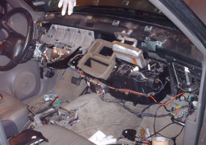

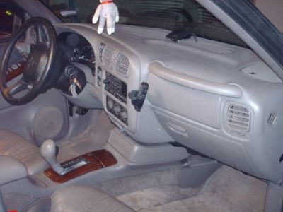

FWIW, HAYNES is absolutely USELESS for this particular repair. If anyone has any questions regarding this heater core repair, you can email me: j.foster62@juno.com 10 hours to CAREFULLY remove dash. 6 hours to reassemble. Get a new heater core ($185) from the Stealership using your VIN! Otherwise, an aftermarket ($77)will probably not fit in the heater core saddle.
https://images.2carpros.com/forum/automotive_pictures/38677_Envoyheatercore_replcmnt_017_2.jpg
https://images.2carpros.com/forum/automotive_pictures/38677_heatercore_2.jpg

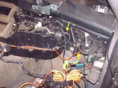

Hopefully he's getting email notices re: this post. I'm sure he's fixed it by now. There were THREE vacuun lines that i recall. One of mine did cbecome undone, however I caught it before reassy. All 3 are accessable with dash board in place. The 1st which I "caught', is located next to the gas pedal. It pulls off a balck tube coming from the firewall as soon as you pull the dash out(probably the same one he missed)
https://images.2carpros.com/forum/automotive_pictures/38677_Envoyheatercore_replcmnt_009_1.jpg
. The other 2 are behind the glove box. One to the left (next to the blend door actuator) and the other to the right.
https://images.2carpros.com/forum/automotive_pictures/38677_Envoyheatercore_replcmnt_015_1.jpg

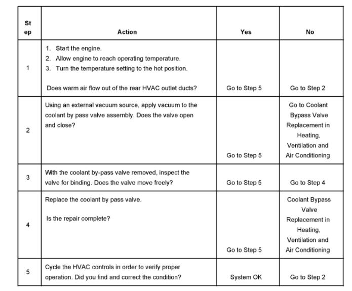

That is all good information.
I attached a flow chart for vacuum issues.
Thank you for using 2CarPros.
