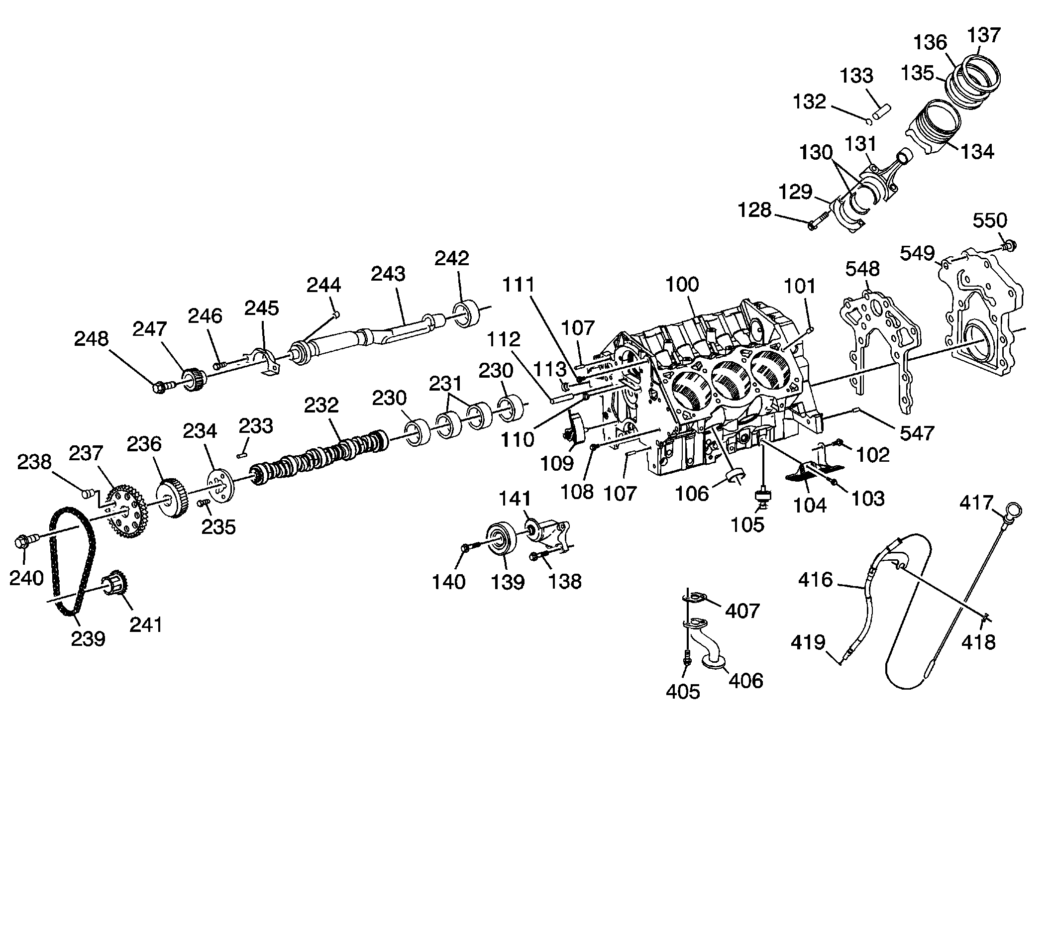

Coolant is pouring out as quick as you can fill it. The coolant is coming out from under the engine. It is not the water pump, any hoses or the elbows. All have been replaced. Also replaced the upper and lower intake gaskets. Only thing I can think of is freeze plugs? The leak is about center of the engine and puddle on the frame cross bar. Very difficult to see the source but it appears to be between the intake manifold and valve assembly.

It could be a freeze plug. I have attached a picture of the engine block and its components. It shows where the engine block expansion plugs are located. Here is the list of parts. It is long, sorry.
Engine Block and Components
100 - Engine Block

106 - Engine Block Expansion Plug

Let me know if this helps
