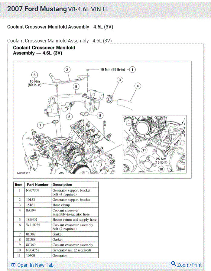

What can leak under the intake of these v8 engines? It just developed a leak. Once it gets to optimum temperature, I see a leak coming from the back of the motor, and I looked under the intake, and I see some rust and some water from that leak.
Dec 31, 2021 at 5:34 AM
  • 110,244 POSTS

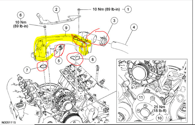

I suspect you have the 4.6L V8. There is a coolant cross-over on the rear of the engine that can be leaking.

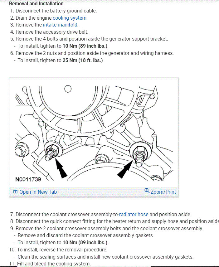

If you look at pic 1 below, I highlighted the cross-over and circled all the places that could leak. Check those areas first.
If you find it needs to be removed to fix the leak, pics 2 and 3 provide the directions. You will also need to remove the intake manifold.
Let me know what you find or if you have questions.
See pics below. Note: If you have a 5.4L, let me know.
Dec 31, 2021 at 3:38 PM

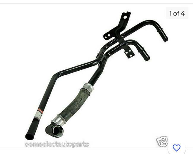

So, most videos show the two hose change, which is easy unclip and remove the bolt. What about the steep one on bottom how is that changed?

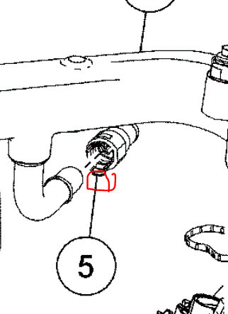

I attached a pic below. Is that the one you are referring to, the heater supply hose? If it is, that is a quick connection. Gently push in on the connector and remove the push pin I circled. Then, pull it off.
Be careful removing it because there is a rubber O-ring in the connector. If it gets damaged, it will leak.
Let me know if this helps.
See pic below.

No, i mean the other hose that is partially metal on the bottom of this connector, it's a ling on.

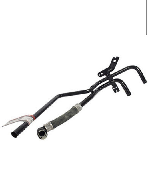

This hose to the left which comes with the other hose, where does it connect? It's mostly metal. It lies down on the bottom underneath the other one a d connects from front to back.
Jan 7, 2022 at 10:16 PM
  • 110,244 POSTS
One is a heater return and the other is the heater supply hose. It goes from the heater core under the intake and to the back of the water pump.
Jan 8, 2022 at 3:16 PM
DIVIDES
  • 903 POSTS
Yes, that is it. Is there an o ring where it attaches behind the water pump? Couldn't find anyone replacing it and how to remove it.
Jan 8, 2022 at 10:42 PM
  • 110,244 POSTS
On one end will be a quick connection. On the opposite side, there is an o-ring. That portion is at the rear of the water pump. Before you install the new o-ring, make sure to lubricate it with coolant. That hose will then be bolted into place.
Take care and let me know if you have other questions.
Jan 9, 2022 at 9:52 AM
DIVIDES
  • 903 POSTS

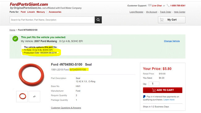

Got it out. Looks like the back of water pump that connects to lower metal pipe has 2 o rings, can you find out what is the part number?
Jan 10, 2022 at 4:56 AM
  • 110,244 POSTS
Yep, there are two. If you look at the pic below, I attached a pic and the part number. The part number, W704593-S100, is a Ford part number. I'm sure you can find one that works the same in a different brand and for less money.
I hope this helps.
See pic below. Note: I just picked the first Ford dealership that came up to show you. Neither 2CarPros nor I have anything to do with them. In other words, I'm not trying to make money. LOL
Jan 10, 2022 at 8:06 AM

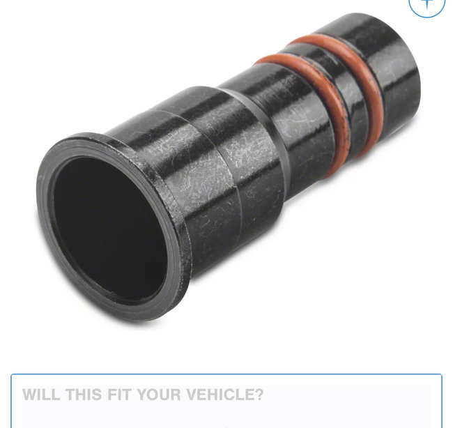

Lol, thanks. What is this here that i see whenever i search for it?
Jan 10, 2022 at 8:19 AM
  • 110,244 POSTS
That appears to be the receiver of the hose you are replacing. Do you recall seeing it when you removed the old hose?
Jan 10, 2022 at 12:58 PM
DIVIDES
  • 903 POSTS
You mean the receiver from behind the water pump? If so, only partially cause the bigger part is still behind the water pump and in front of the block.
Jan 10, 2022 at 6:51 PM
  • 110,244 POSTS
If possible, could you take a pic of what you are seeing and upload it for me to see? It would help me. Also, the pic you provided will be on the opposite side of the replacement tube.
Jan 11, 2022 at 11:10 AM
DIVIDES
  • 903 POSTS
I see where it goes, water pump has to be removed, i won't need to i just wanted the right size o rings as no one seems to have it and many are different sizes. They fir right. Thanks for your help.
