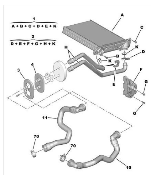

I have checked the engine oil and it looks good. Not mixing at all. Is it possible for the heater hoses to be the ones leaking? If so, where are they located in a Peugeot 3008 2013.

Yes, it is possible to have leaks from the heater hose(s) A pressure test can determine where leaks come from. Is your car/SUV model the 308 or 3008? You mentioned both in your question.Thanks again for using 2CarPros.

The two heater hoses will be connected to the heater core tubes that run through the firewall.It will be an insulated connection in the firewall.I'm not sure if your car is a right or left hand drive car due to your location but it will always be on the firewall opposite from steering/brake controls. I've attached a picture below for reference.Not sure if correct.Hope this helps and thanks again for using 2CarPros.
