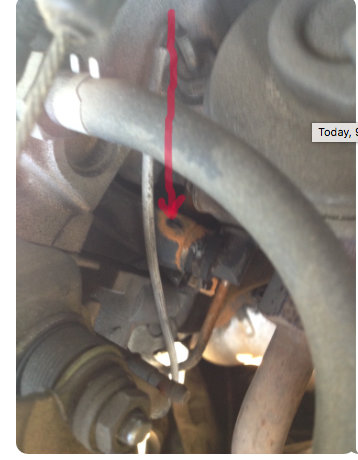

Have a lot of coolant leaking from a hose connected to the engine. I need to identify the hose and if it is a pricey repair or not. you can see fluid bubbling out of it. coolant is gone. Had the car towed.
Leak is coming from area in center of photo.

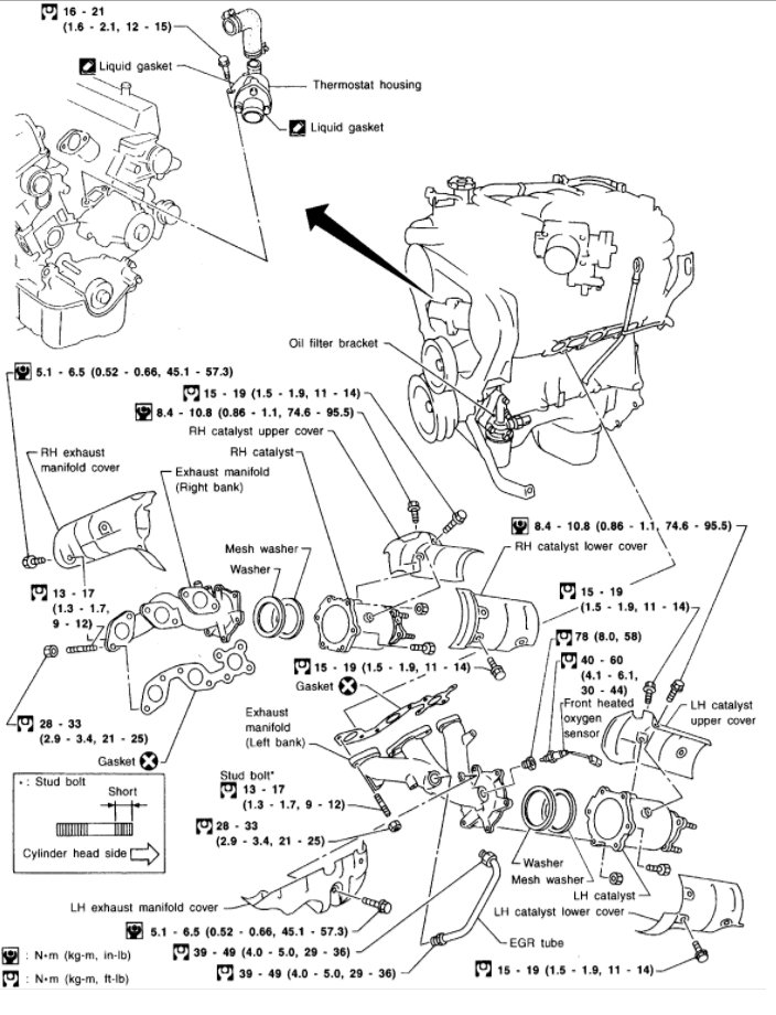

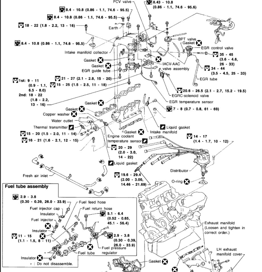

Nice job on the pic, it looks like the intake will need to be removed to replace the hose. Will you be doing the repair yourself? If so here is some diagrams (below) to help you see what you are in for when doing the job.
https://www.2carpros.com/articles/replace-intake-manifold-gasket
and
https://www.2carpros.com/articles/car-is-leaking-coolant
