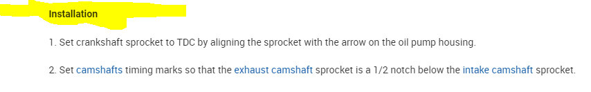

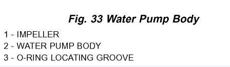

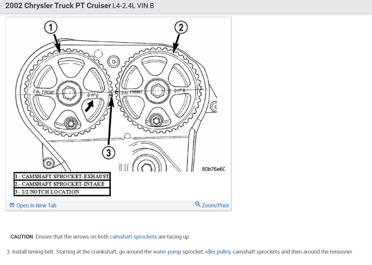

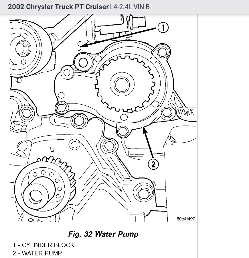

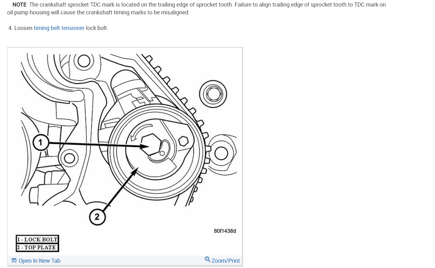

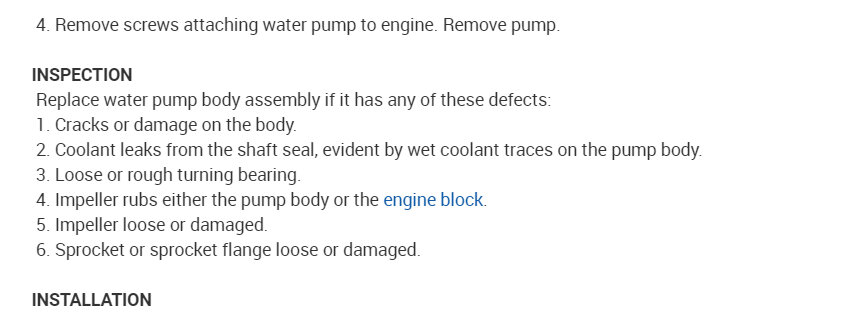

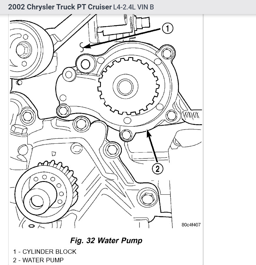

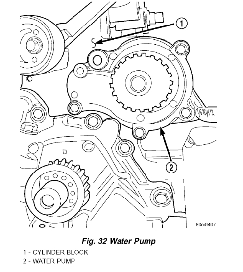

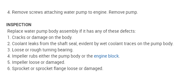

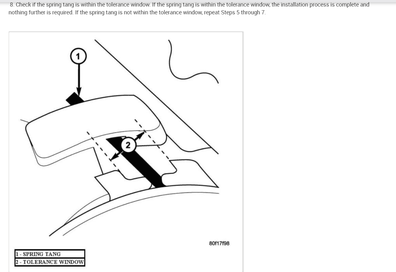

While driving home, the car began to overheat. Drove 5 miles to get home. Once parked/cooled, I filled the coolant. The cruiser was leaking coolant. I believe it is the water pump. I have purchased a new pump but would like a guide on how to replace it.
Feb 20, 2023 at 3:57 AM
  • 55,433 POSTS

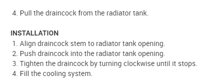

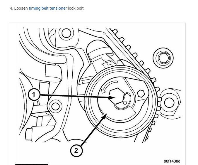

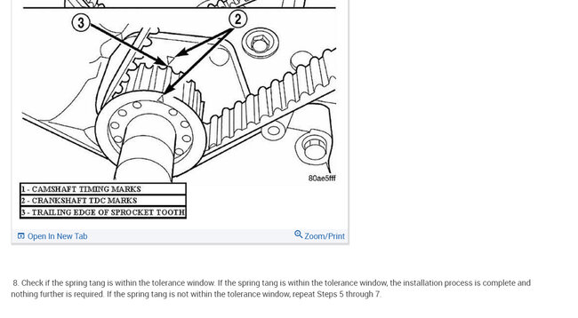

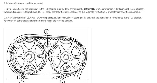

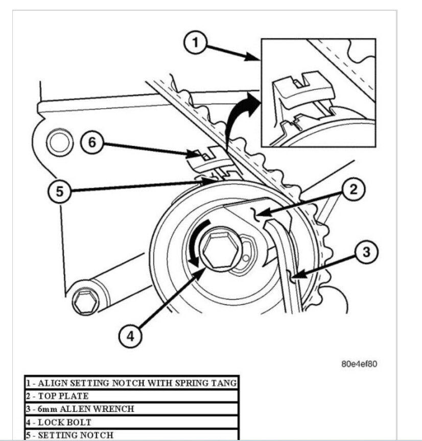

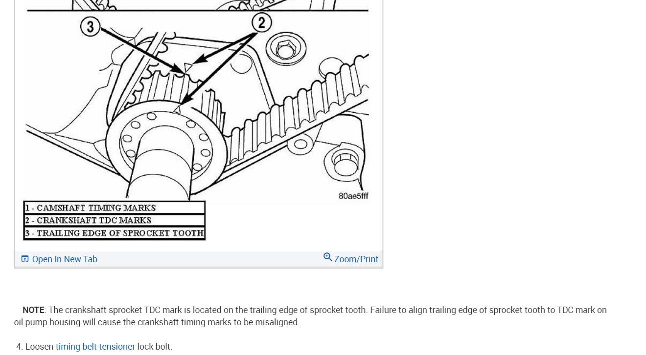

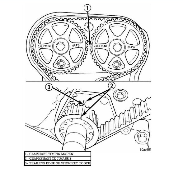

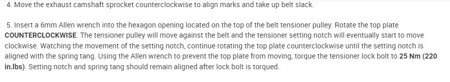

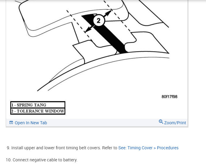

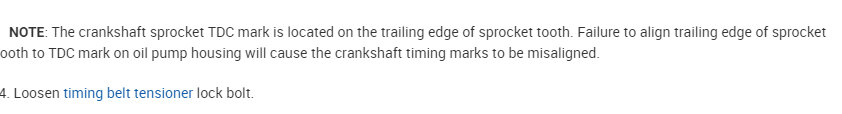

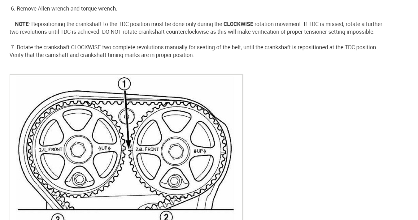

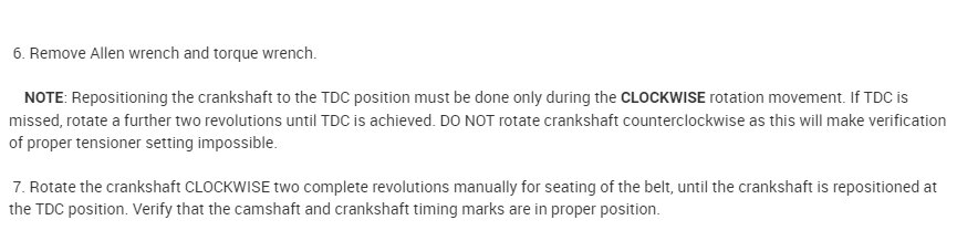

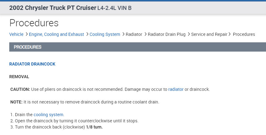

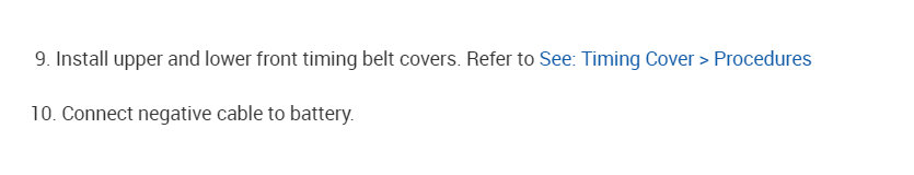

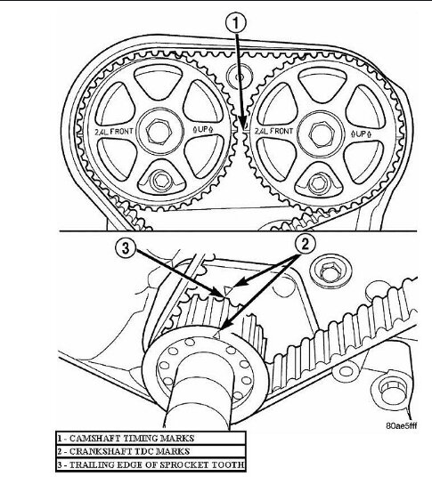

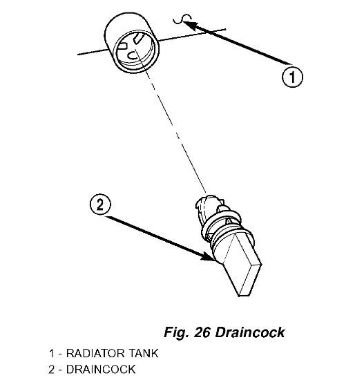

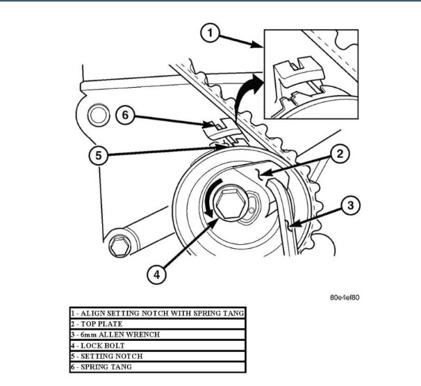

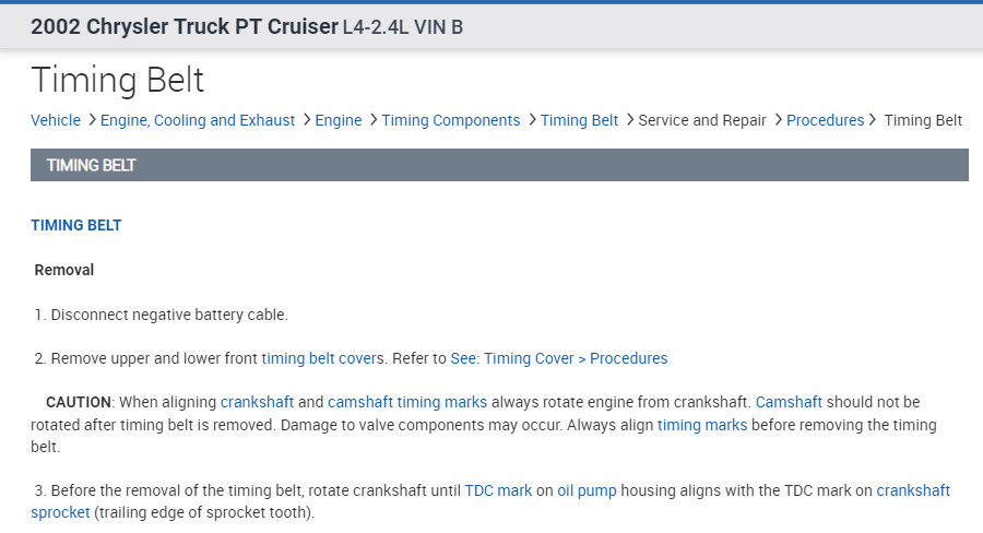

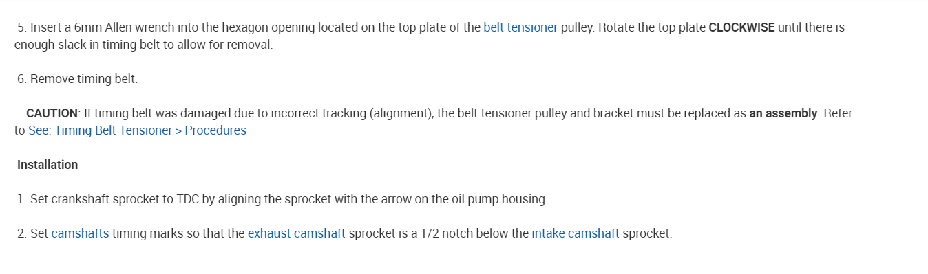

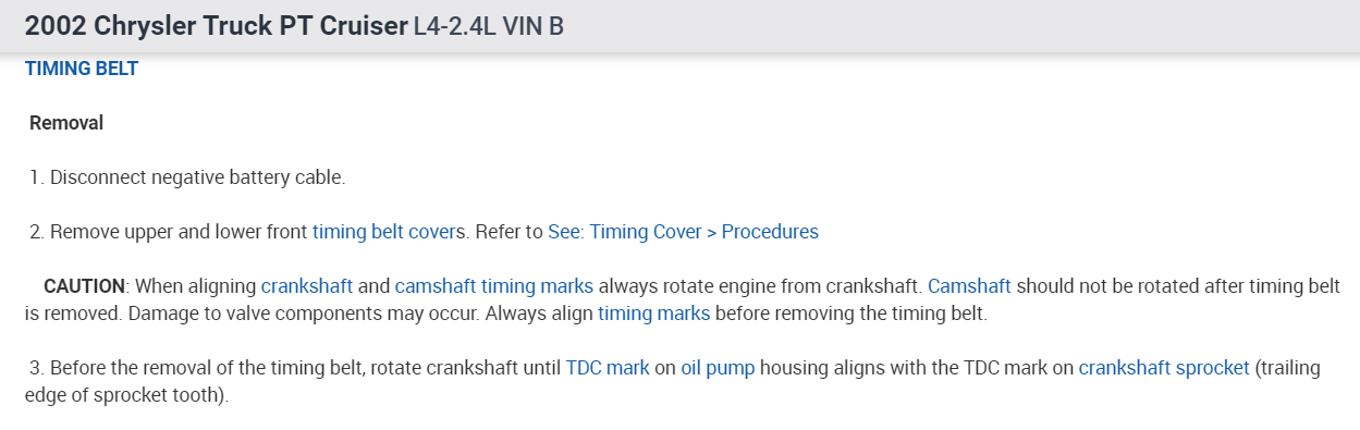

The water pump is driven by the timing belt so the front of the engine must be removed to do the job so I would get a new timing belt and tensioner as well. Here is how the job is done in the images below which includes the timing belt marks. Start by disconnecting the battery and draining the coolant. Then remove the serpentine belt and timing belt cover.
Feb 20, 2023 at 10:40 AM
  • 110,244 POSTS

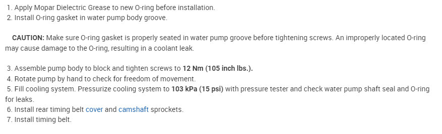

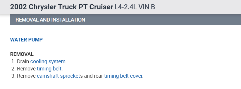

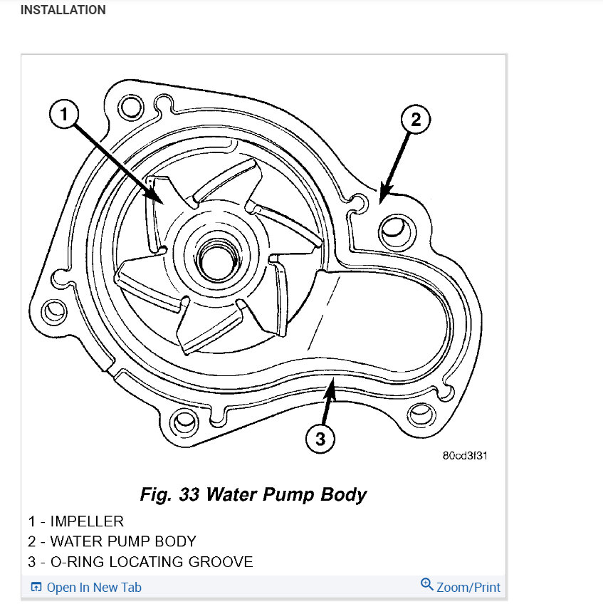

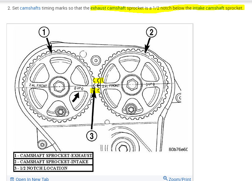

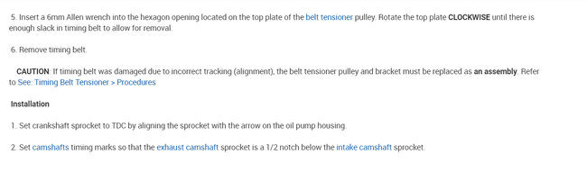

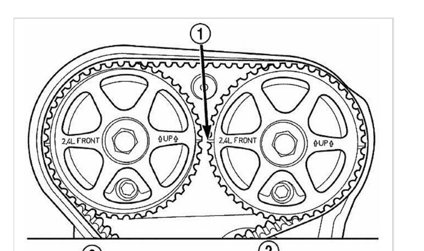

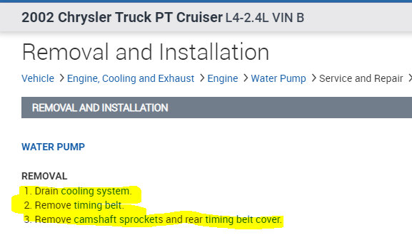

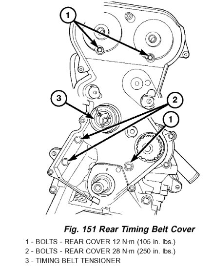

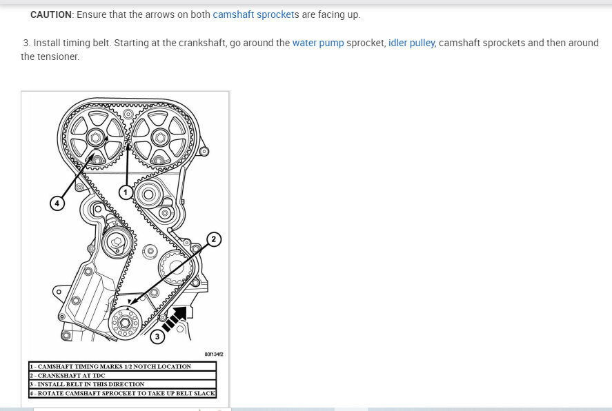

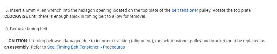

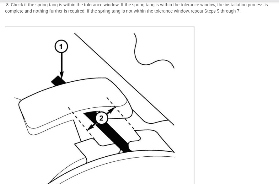

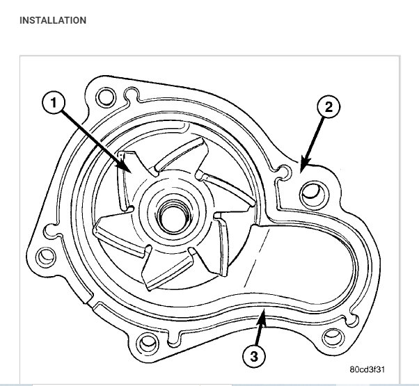

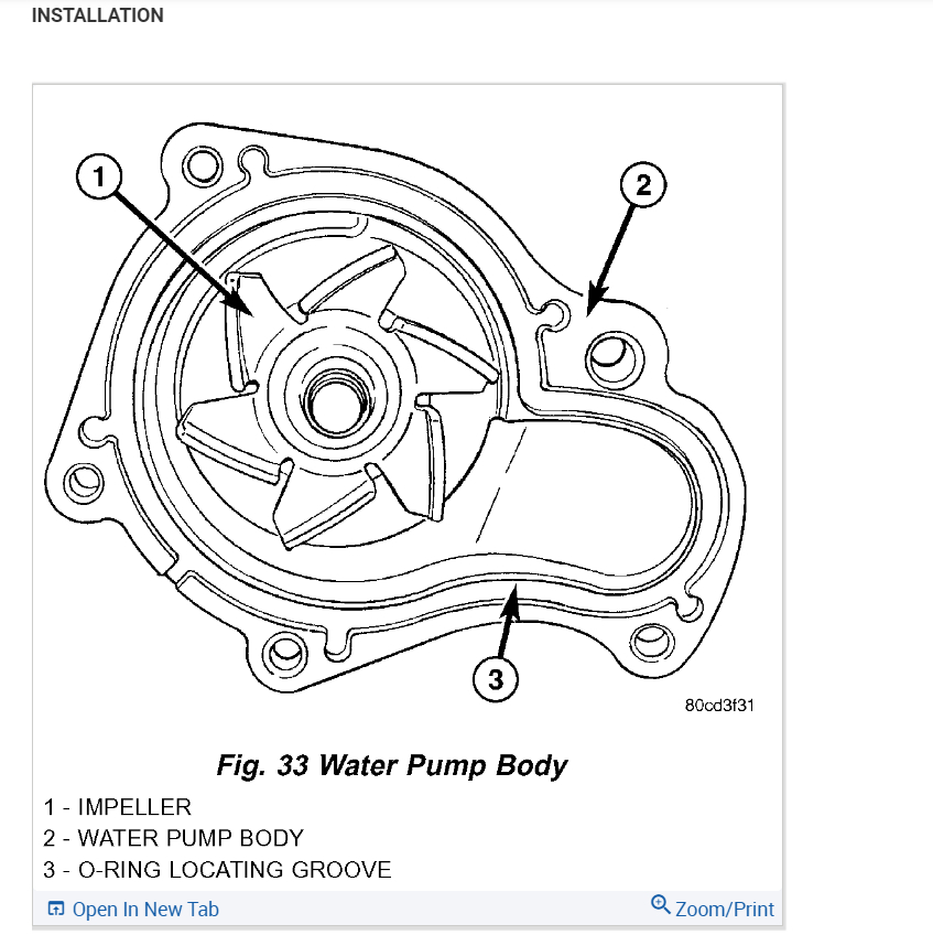

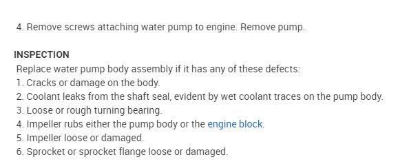

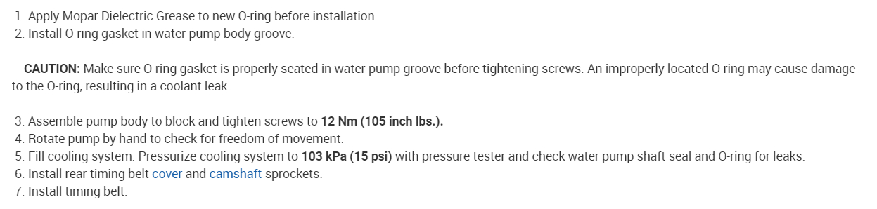

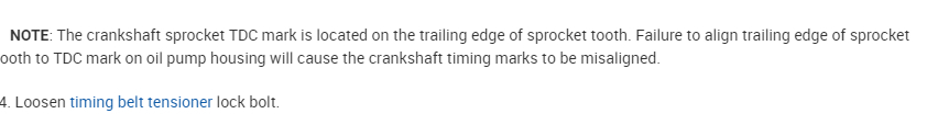

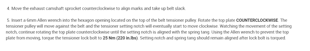

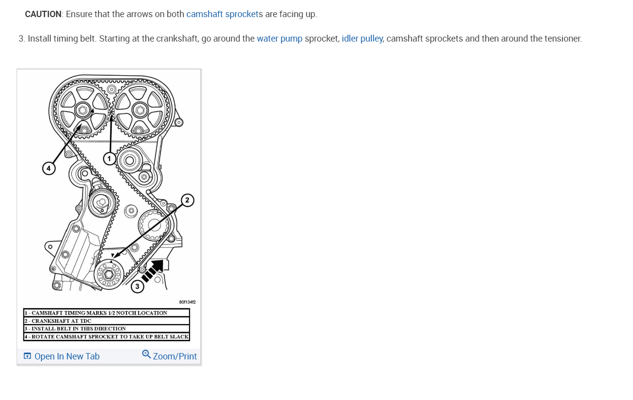

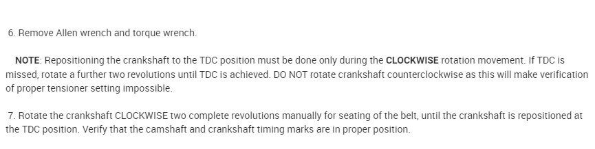

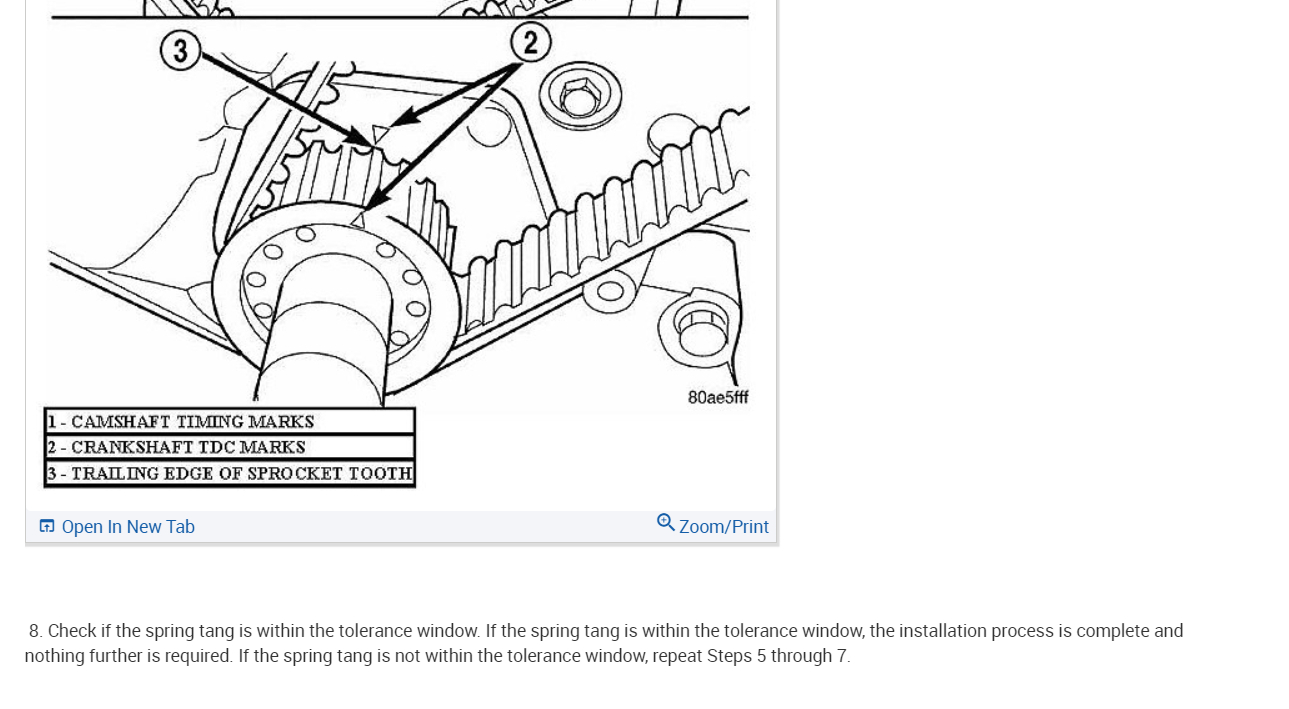

To replace the water pump on this vehicle, you need to remove the timing belt. There are several steps to this and other steps that will need to be taken. I will attach all of them below. Note: The first 6 pics are the actual directions for the pump itself. The remaining pics are the directions related to removing the timing belt, removing the rear belt cover and cam gears, draining the coolant, and so on.
Before you remove the actual timing belt, make sure the marks are aligned as mentioned in the directions. Otherwise, it will be more difficult to time it again.
As far as the water pump itself is concerned, it is easy to install. It's the process to get to it that makes it more difficult.
Take a look through the directions below and let me know if you have questions or what I can do to help.
