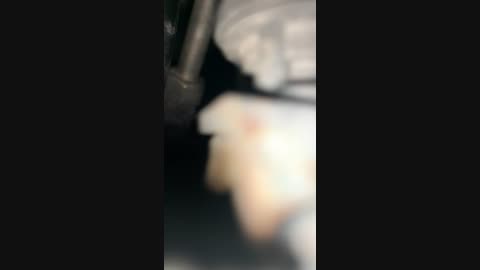

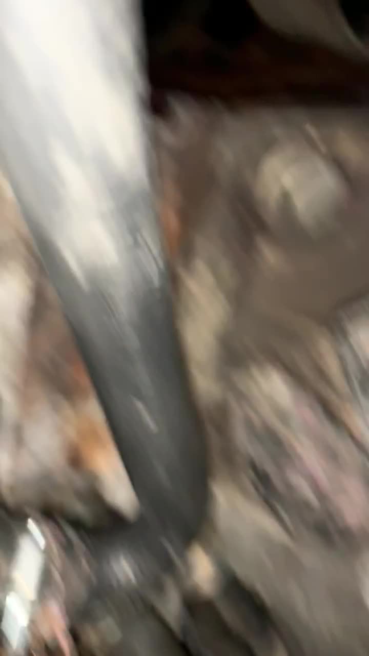

Had a coolant leak and changed the temperature sensor housing. Thinking all problems were solved but now coolant is leaking even more. Coming from about middle of engine in rear. In the video you can see the new housing in the top of the frame. But what is that stalagmite of coolant hanging? About right under exhaust manifold.

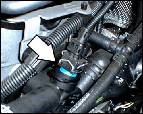

If it is in the rear of the engine, did you replace the coolant flange? Is that where you replaced the sensor? See picture below.
If that is what was replaced, did you replace the o-ring on the sensor? When you replaced the clip that holds the sensor in place, was there excessive play in the sensor?
You should pressure test the system to see exactly where the leak is located. I will tell you that if you did not replace the o-ring, that could be the problem. Here is a link that shows how to pressure test the system:
https://www.2carpros.com/articles/radiator-pressure-test
As far as what you are seeing, that is dried out coolant.
Let me know,
