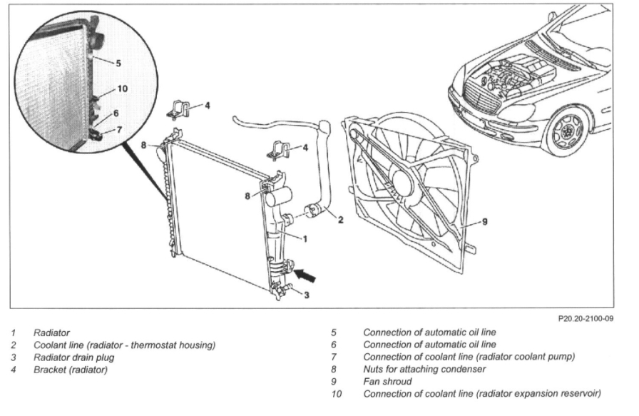

  • 55,399 POSTS
Yep the temperature sensor can cause the fans to come on too late causing the nine to over heat so You are on the right track for that. I think I would do the radiator in it as well becasue it can be block internally or externally.
Here are a couple guides and some diagram (below) to help you get the problem fixed.
https://www.2carpros.com/articles/how-to-replace-a-car-radiator
and
https://www.2carpros.com/articles/engine-overheating-or-running-hot
I believe it is a 35 torx for the tensioner arm.
Please let us know what happens and upload pictures or videos of the problem.
Sep 16, 2017 at 7:31 AM
