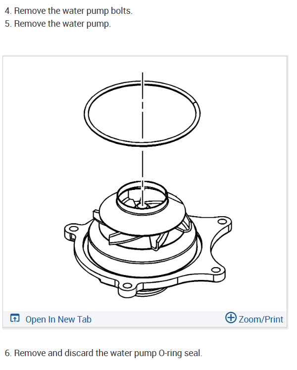

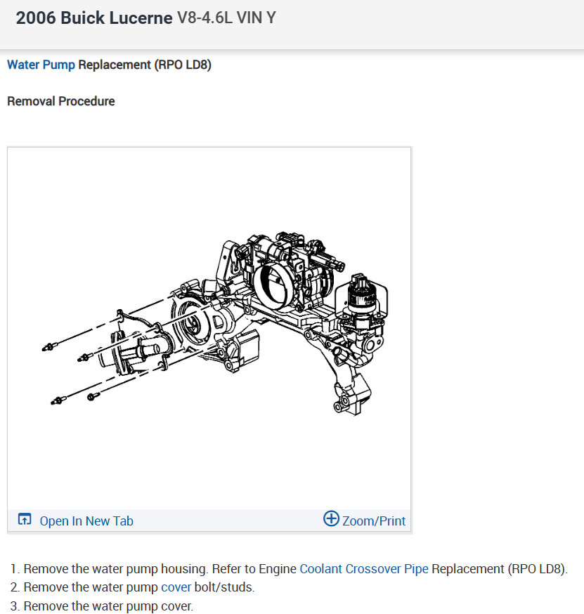

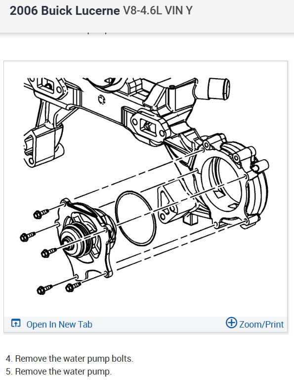

I can't see the leak in the video, sorry. Can you look at the video you uploaded to confirm? It sounds like the water pump is leaking, here is the location of the pump so you can confirm this is where the coolant is coming from. also, this guide can help:
https://www.2carpros.com/articles/car-is-leaking-coolant
Check out the images (below). Please upload pictures or videos in your response of any problems so we can see what to help you with.

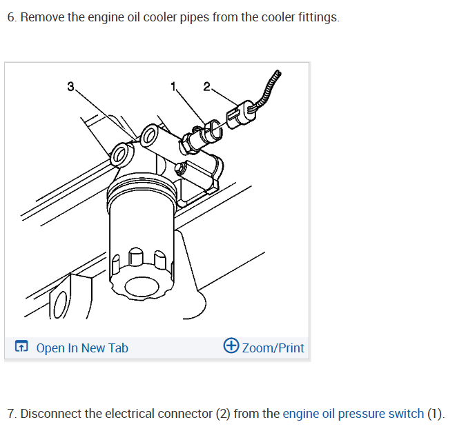

So, it’s interesting though, because the link you sent says that both types of coolant leaks will cause the engine to overheat. I’ve driven the car as much as 35 minutes in one stretch and the temp never exceeds half on the gauge.
Also, I can see the leak in the video, but it is just a slow drip, so it may be difficult to see the drops of coolant. However, it is clearly leaking from right above the oil filter. Do you know what type of leak would be in that area? Is there a freeze plug in that vicinity?

  • 54,832 POSTS
It depends on how low the coolant gets if the engine will overheat or not. It could be the head gasket leaking externally, I would raise the car up and use a flashlight and an extendable mirror on the stick to pinpoint the leak, I don't see a freeze plug on the block near the oil filter adapter. Check out the images (below). Please upload pictures or videos in your response of any problems so we can see what to help you with.

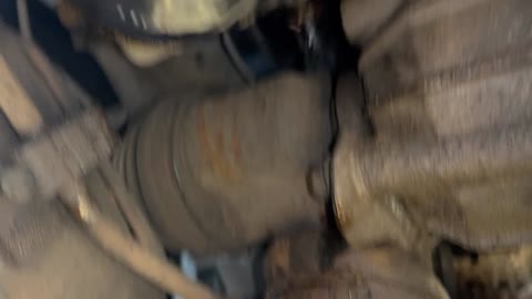

DSCHWINDT
  • 49 POSTS

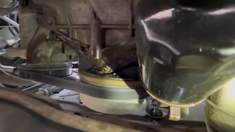

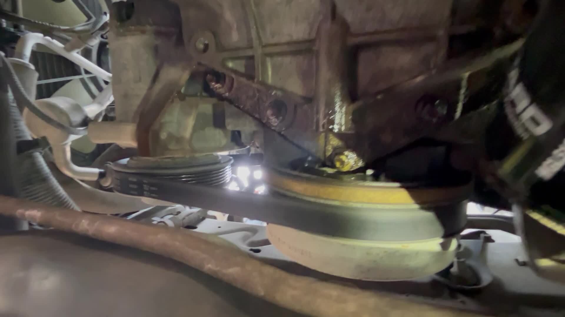

Let me know if you can see the leak in this video, and if you may know the source.

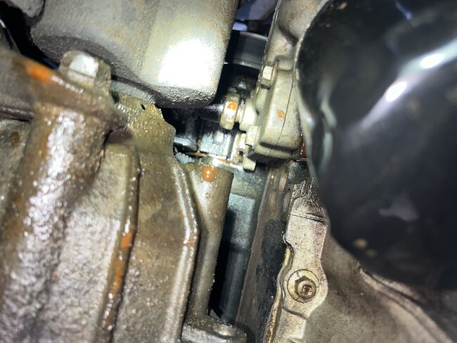

DSCHWINDT
  • 49 POSTS

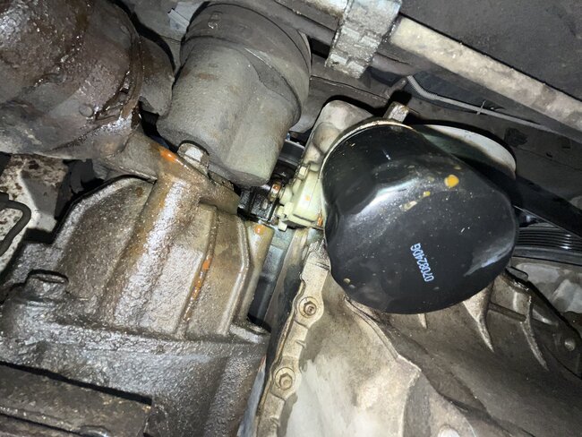

Here are a couple photos. Hopefully they help.
Dec 23, 2024 at 1:17 PM

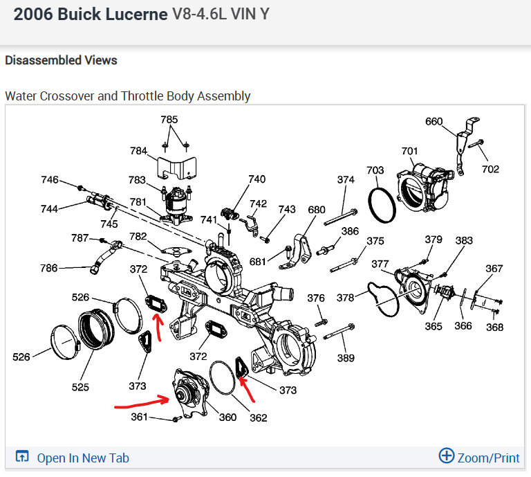

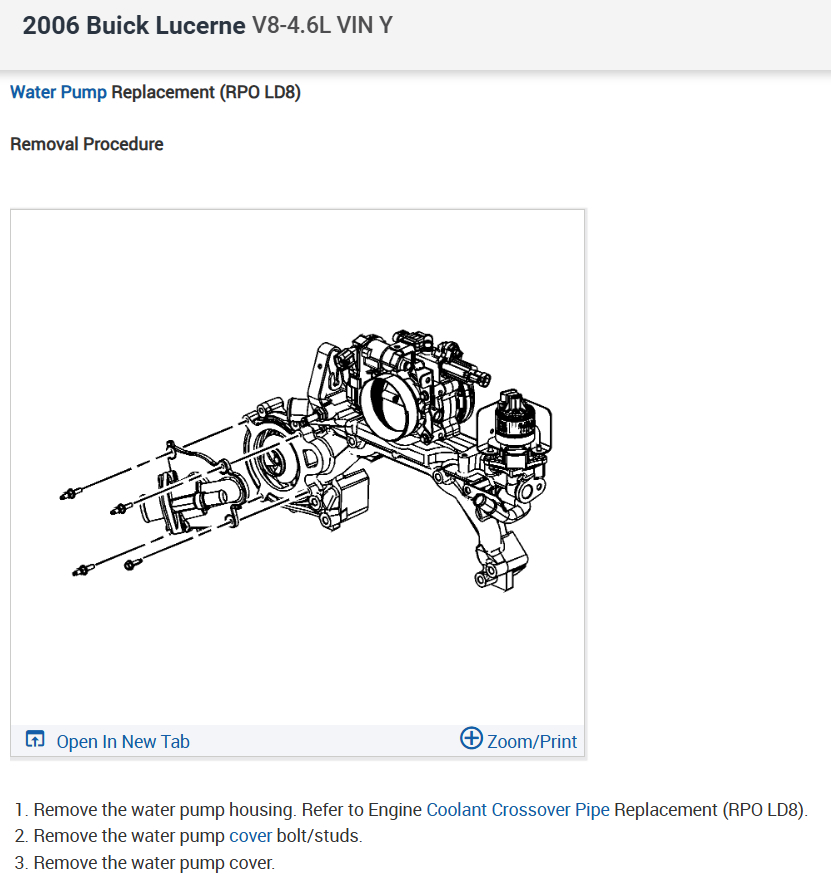

  • 54,832 POSTS
Thanks for the video and images. it looks like the front coolant crossover tube/gaskets/water pump is what is leaking you will need to disable the engine front and then use a pressure tester to help pin point to the leak. Please check out the images below to see what I am talking about. Check out the images (below). Please let us know what happens.
