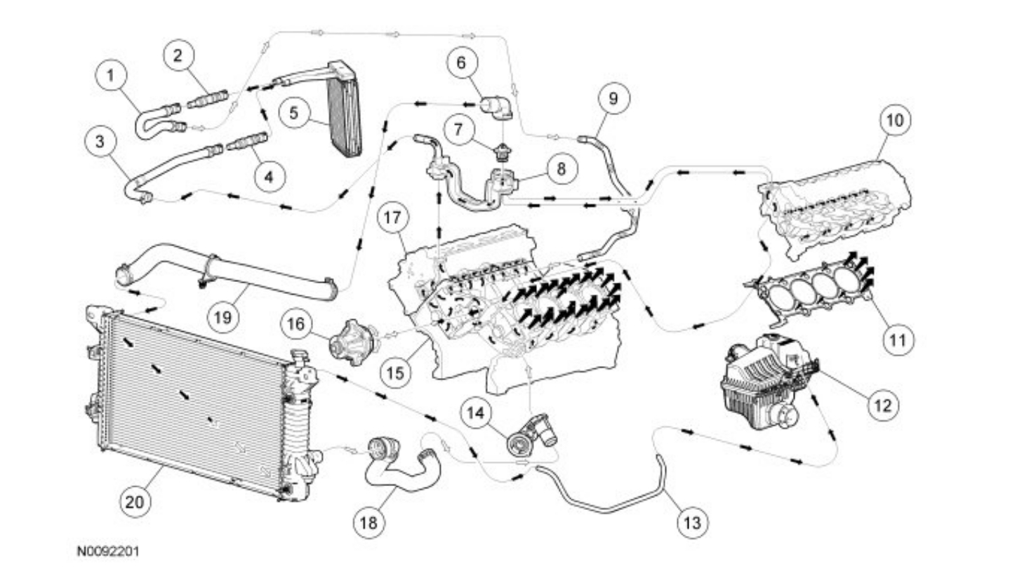

Need to know which hose is the inlet and which is the outlet hose?
2019 FORD EXPEDITION
61,870 MILES • AUTOMATIC
TC CARNEY
Apr 20, 2023 at 5:00 AM
  • 55,381 POSTS

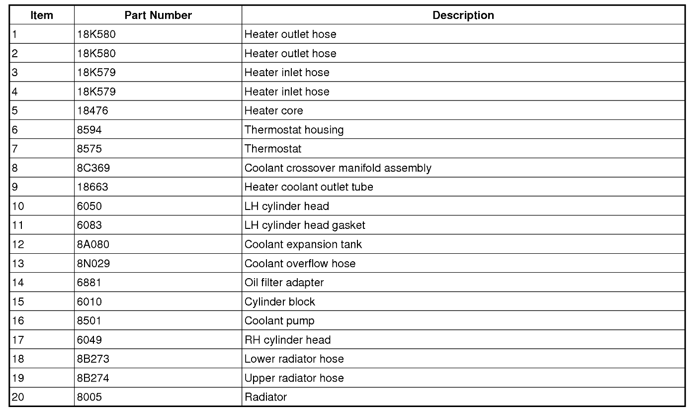

Sure, the upper radiator hose is the outlet hose while the lower radiator hose is the inlet hose. Please check out the images below. If you have a coolant leak this guide will help you find it.
