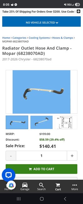

Coolant is leaking from hose in middle front underneath the van. Each side is clamped onto a silver nipple. There is no other attachments to the hose . Just a black hose and clamps and a mesh black sleeve. I can’t find out what part it was removed from in order to search the hose . It looks similar to an upper rad hose but it’s not on the top of the car it’s underneath the bottom in the middle and it doesn’t have a black plastic tip on the end. It’s just a tube.

This?

Yep, that looks like what they are describing, this part is made from thin metal and can corrode causing the leak. Good find BLACKOP555 :)
