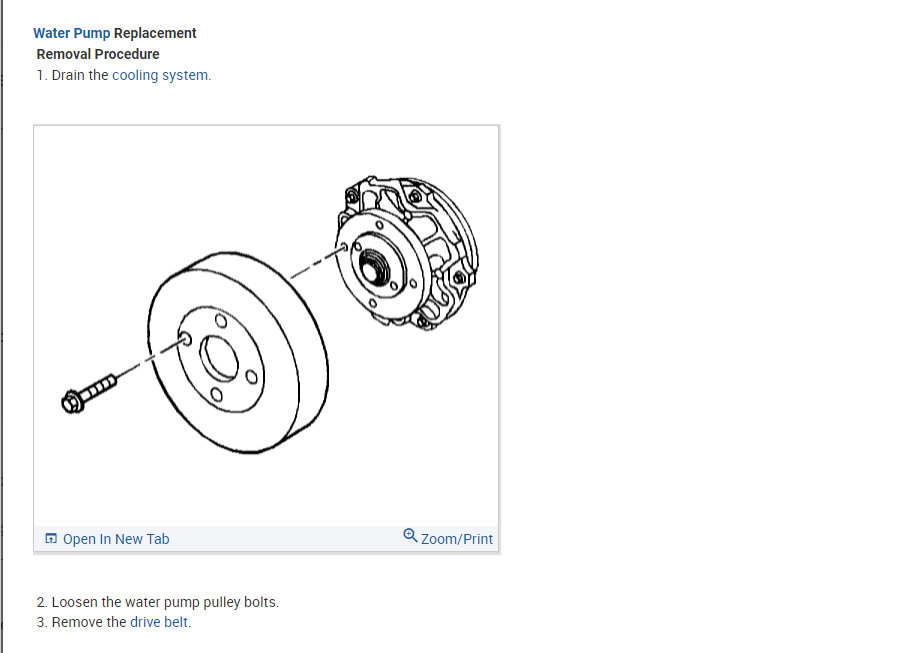

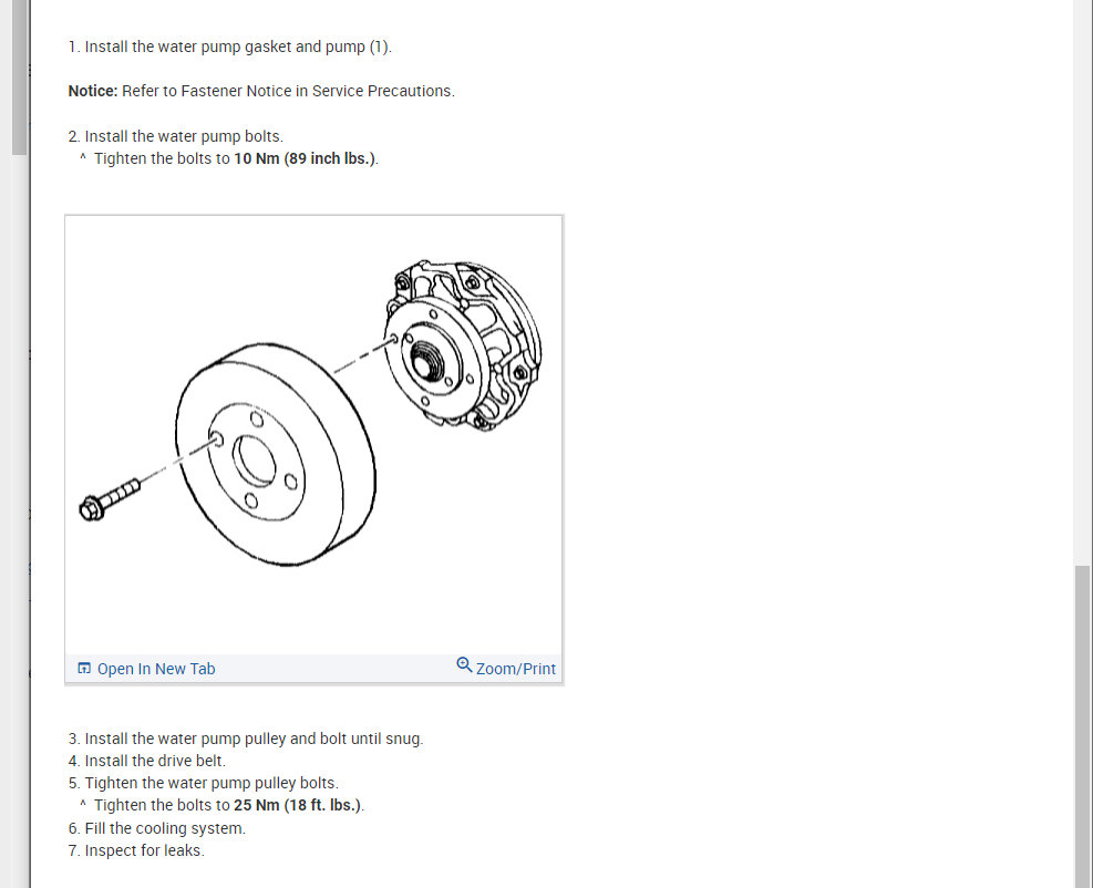

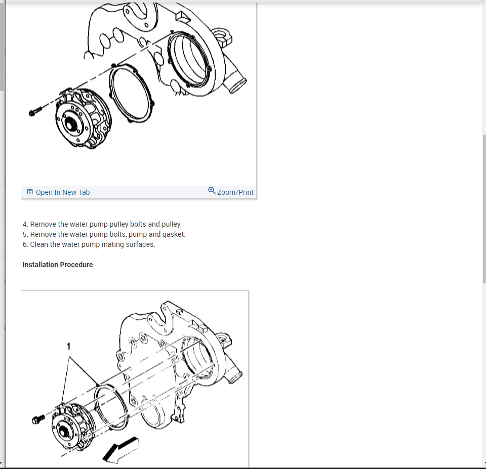

More than likely this is a water pump issue as they have a weep hole in the bottom that will relieve pressure at times but when the seal behind it fails, it starts to drip coolant. Also, it could have overheated and pushed that seal out which will cause it to leak all the time.
Here are a couple guides that will help with this but we need to start with pressure testing the system to see if it will hold pressure and then inspect for the leaks while holding pressure:
https://www.2carpros.com/articles/coolant-leak-symptoms
https://www.2carpros.com/articles/radiator-pressure-test
Below is the process from the manual that will help with replacing the water pump as I suspect that is the issue. Please run through this info and let us know what you find. Thanks

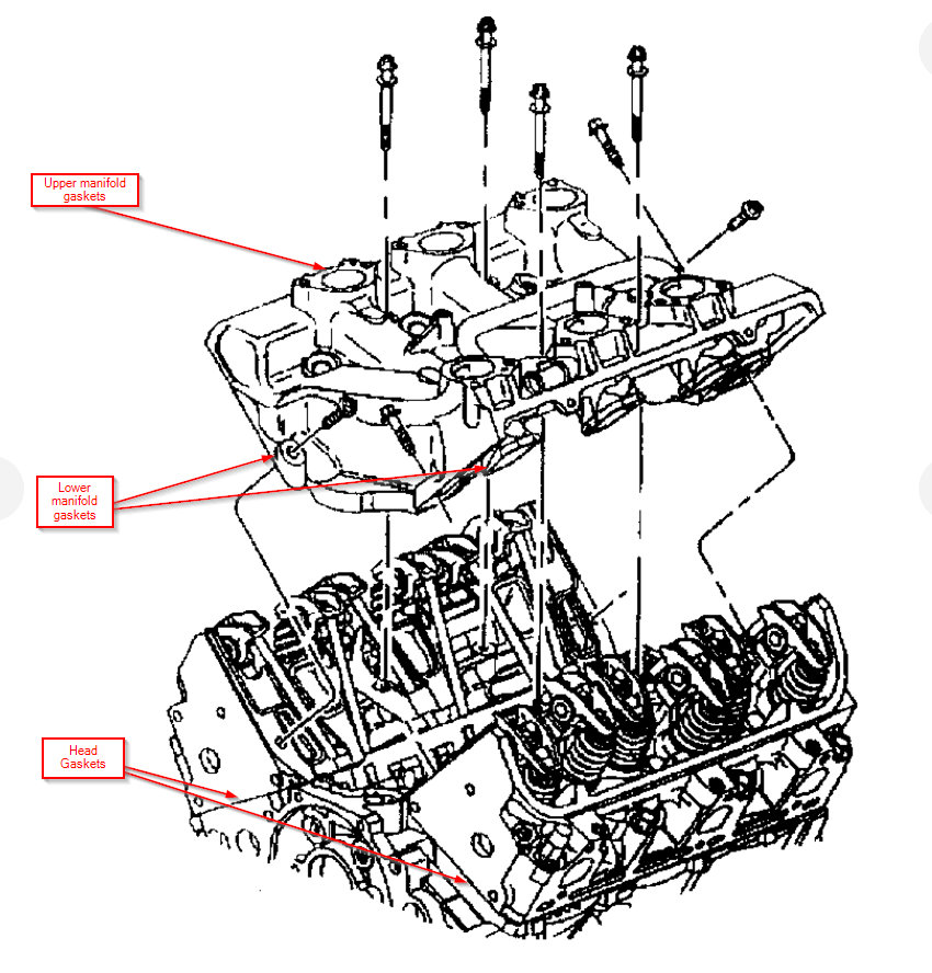

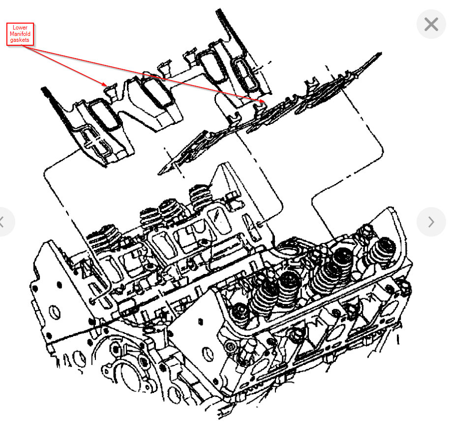

I took it to a shop and they told me it needs a bottom head gasket. And it's going to cost $900. I've heard of head gaskets and valve cover gaskets. But I wasn't aware that there's a top and bottom head gasket.
Does it sound like their making this up?
Aug 2, 2021 at 10:24 AM
That is a new one on me. You only have one head gasket on each side. However, you have a lower manifold gasket. Did they give you an estimate? Did they say how they confirmed it?
Take a look at the info below on this and we can go from there. I suspect they are just not calling the gasket the correct name.
