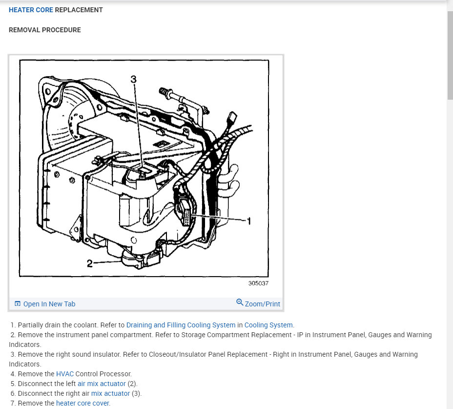

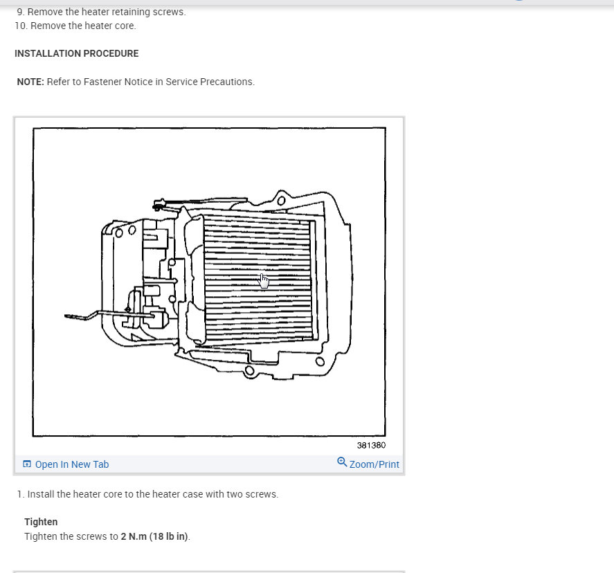

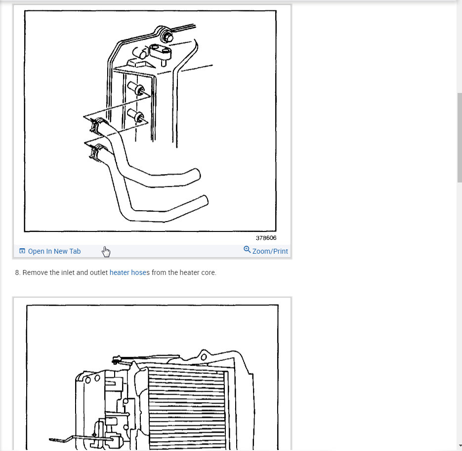

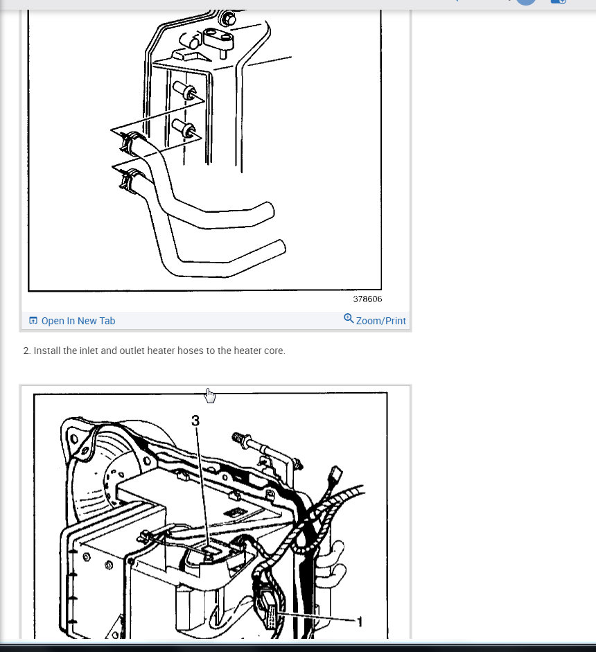

Have the checked the heater box for coolant leaking from the heater core?
