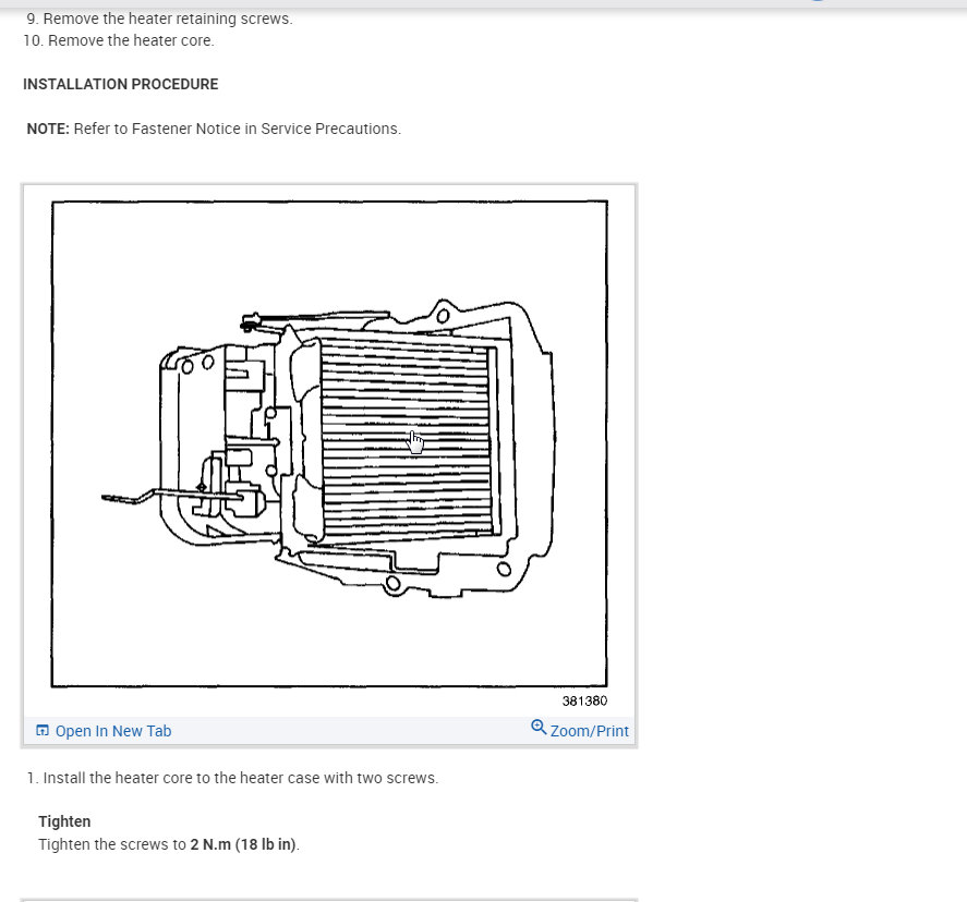

I just had a problem with coolant leaking and it seems like we've done everything. mechanic has pressure test at the system and still can't find the leak. is there something else we can check?
Nov 25, 2019 at 5:49 AM
Have the checked the heater box for coolant leaking from the heater core?
https://www.2carpros.com/articles/radiator-pressure-test
How much coolant are you loosing? The other thing we need to check is the oil to make sure it is not mixing with the oil.
https://www.2carpros.com/articles/coolantantifreeze-in-the-engine-oil
Let me know what you find and we can go from there. Thanks
