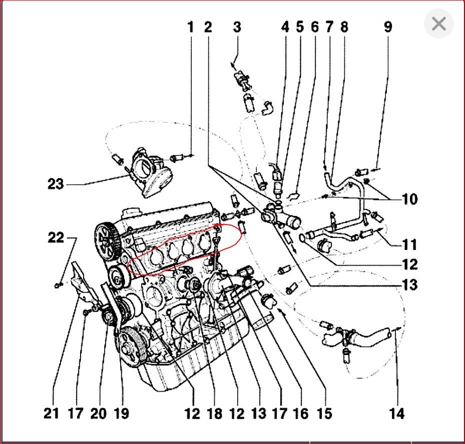

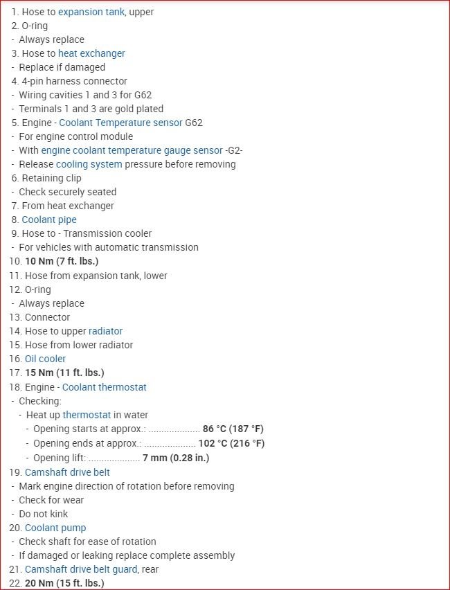

Found my coolant leak but having trouble finding the parts or exactly what the parts are called so i can do a better search. The leak is on the firewall side of motor and right below exhaust manifold.
May 30, 2019 at 1:05 AM
Hi Gtsievers,
I attached the diagrams that show the engine view. I circled where the exhaust manifold would be in red. Do you see the component that you are referring too? If not, can you get a few pictures of it from some different angles so I can try to identify it?
Thanks.
