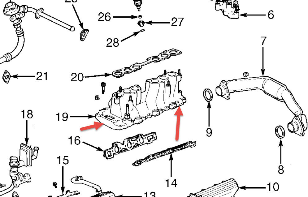

I was under the impression it was a coolant leak try to let us know what kind of fluid in the future. it still cold be a head gasket or maybe an oil line if any in back and possibly the china wall gasket to intake. see picture arrow at front would be same at rear where arrow points there. it cold also be the crossover pipe or o-ring where it attaches at back of engine leaking a pressure check would show that as its coolant.
