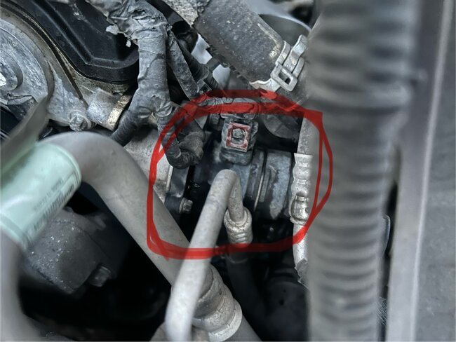

Hey Ken, I pulled off the front clip and I was able to get in there better and find out where the coolant leak is. I have attached a photo. It is this black piece that cracked. What is this piece that I need to replace?
Thank you very much for your help.
Feb 25, 2025 at 12:16 AM
  • 55,694 POSTS

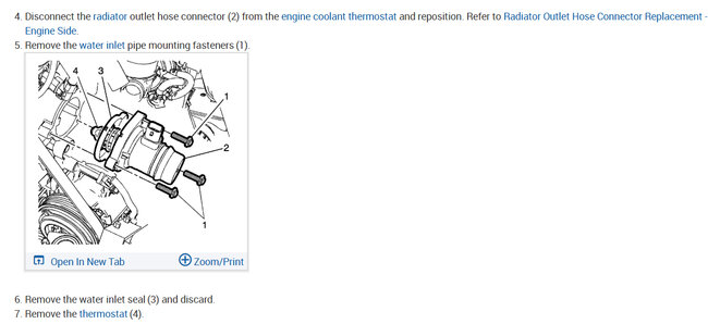

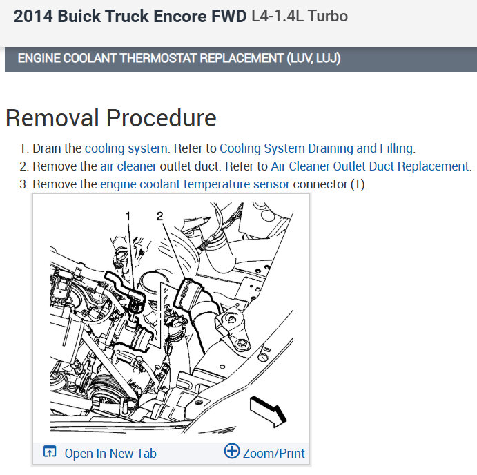

This looks like the thermostat housing, here is how to change the part out which will fix the problem. Don't over tighten the mounting bolts.
80-inch pounds to tighten the bolts.
Check out the images (below). Let us know if you need anything else.
