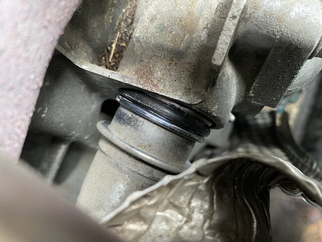

So, I had to fill my car with water after putting a new belt on to drive down the road and get coolant for my car and when I went to fill it was leaking behind the exhaust manifold to the left of the thermostat. I’m not sure what part this is to be able to fix it, but I’ll provide a video to show.

Have you had any chance to shoot a video or take some pictures? The location you refer to has a few lines there that can leak. Seeing the location would help.

It’s the inlet suction hose right behind the exhaust manifold.

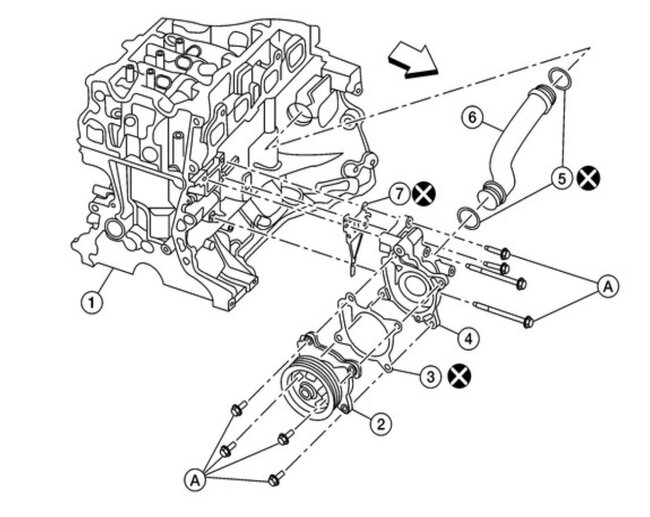

You mean #6 in the image? That has O-rings on the end, but if it's leaking in the middle, it possibly rusted through. Replacement is basically drain the coolant, remove the water pump housing itself and then you can get to the pipe. Remove it, be sure the seals are on the new one and reverse the process.

The old one is leaking because it’s not fully in the thermostat housing. I just changed the belt and took the water pump out to see what shape it was in. Now it’s really leaking. So, I’m not going to have to take off the manifold to reinsert it?

Did you remove only the pump or the pump housing that bolts to the block? The pump should only have 4 bolts (item 2) and comes out the front of the housing. In your case you will need to remove item 4 from the side of the engine. Then you can remove the pipe, check/replace the seals and re-install it with the pipe ends fully seated. It's a tight fit but can be done with the manifold on. Pull the alternator and you should be able to get to the 4 bolts.

The tube could be rusted through causing a leak or misalignment. Either way you need to remove the coolant tube to inspect or reinstall. Please use the image Steve has featured above.

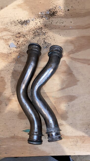

I got the tube off; it was horrendously bent. I don't know how but I am ordering a new one. Thank you guys!

Hmm, in that location I'm not sure how it would get bent unless someone had it off before and installed it wrong. However, you found it and are fixing it. Be sure to install the new one the correct direction. The bent end goes on the water pump end.

Yeah, I’m not sure. Me and my buddy tried installing back on both ways and it was still not flush on either side to the pump.

In use it should only fit with the formed end facing the pump. I've seen them bend from rust and if they were installed wrong. They are sort of protected in there. But the new one should solve that. I would take some time and clean out any crud from the seating areas and use a light film of silicone lube on the rings just so they slid into place without rolling. Don't use regular oil or grease as that will damage the seals.

You guys can guess which is the new and old one.

That's got a bit of a curve... The new one should seal it a bit better.

Held coolant! So I owe you dinner sir ;)
