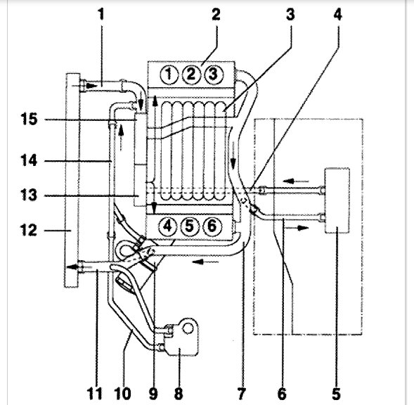

So, coolant won't stay in my reservoir leaking coolant from in front of my car, so I detached the upper hose from the reservoir I believe that hose run through the engine and pour water down it and some after it's leaks out front in front of the car. need help.
Sep 23, 2023 at 9:17 AM
  • 110,236 POSTS
I attached a picture below of the hoses related to the engine cooling system. If you have a leak from the reservoir, the one hose runs to the upper radiator hose. It could be leaking at that point. See pic below.
Also, if you haven't already, I recommend pressure testing the cooling system. When the engine is cold, make sure the coolant is full, and then, using a pressure tester, pressurize the system. If there is a leak, you should be able to locate it when it is pressurized.
