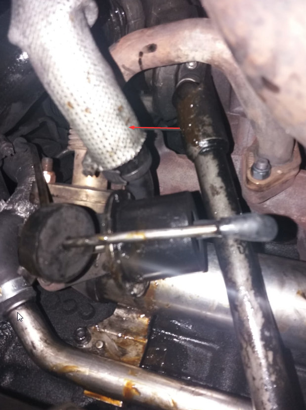

NIGEL ROBINSON
See photo leak coming from here.
Jul 16, 2020 at 6:21 PM
It looks like there is some spraying of coolant going on there but it appears this line would be the cause. However, it is a little hard to tell. What we should do is clean it all off and then just pressurize the system and start checking again. If you run the engine I doubt you will have much success finding the exact spot because it will be very hot. By pressurizing the system, you will be able to feel around the parts to find the exact spot.
Jul 17, 2020 at 10:36 AM
