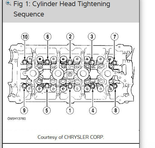

pressure check system for a head gasket leak or chemically check either way is okay. auto parts sells chemical. was head gasket put on up side down? is radiator same temperature all over if any cold spots it is bad. is head warped or was checked?

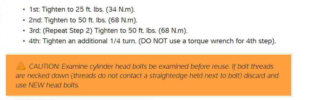

the radiator caps are probably made to supply the oem's stant has been a name brand one for years. However you say it never overheats until it is out of water. where is it going? that is why a pressure check. to see if there is an internal leak. yes there could be air as well you are supposed to bleed it once it is warm until liquid comes out. head gaskets do not need to leak into cylinder they can leak outside to the exhaust manifold and unless it is a large leak you will not see it. was head tightened in four steps like it is supposed to be? was torque sequence followed? I do not know any of that just that it is overheating.

Torquing sequence was as per your attachment.
