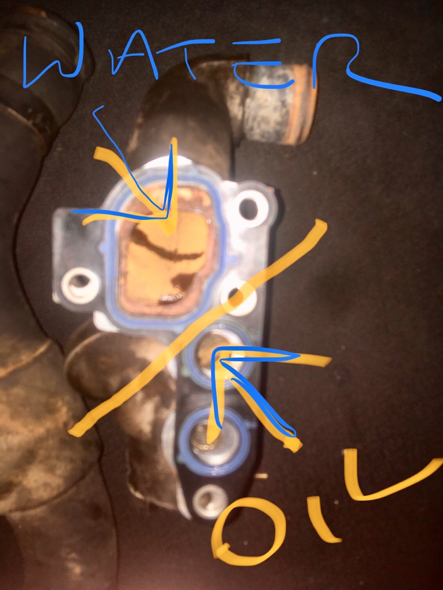

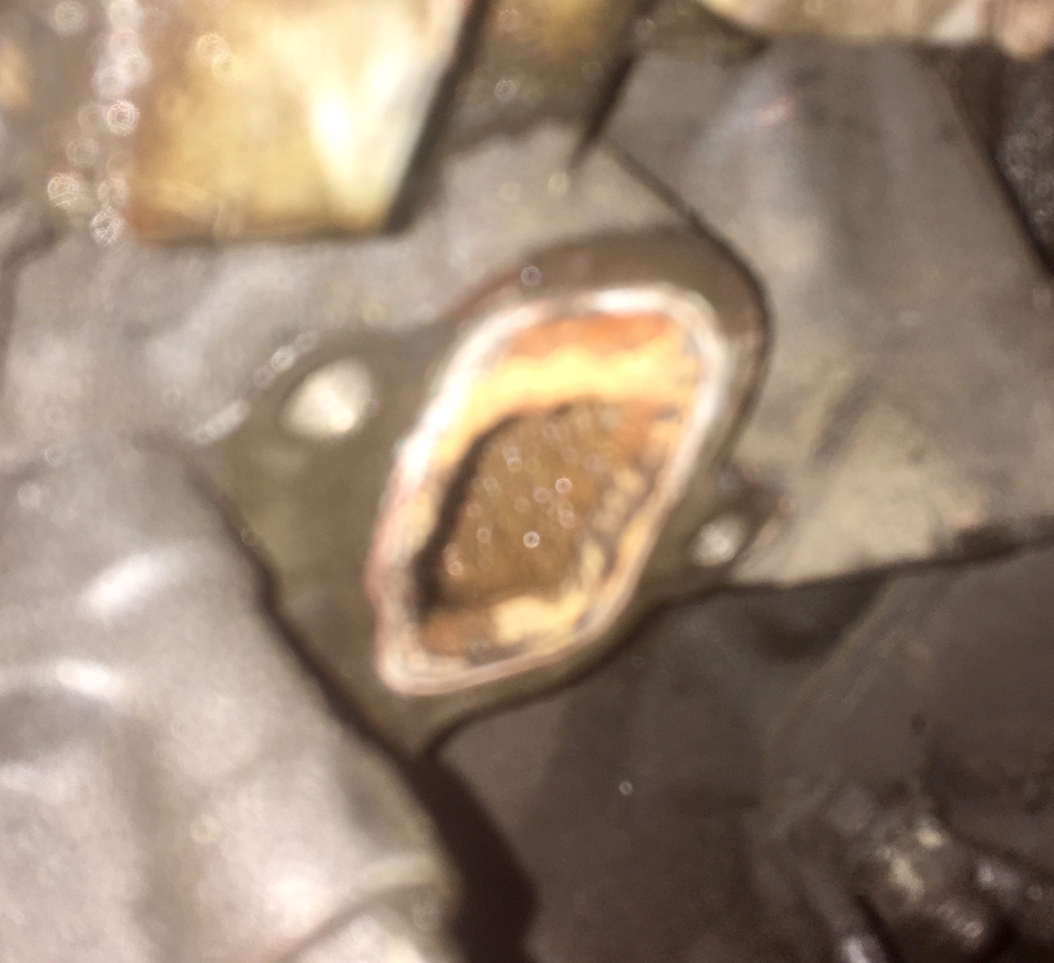

Okay, so I was going to drop the oil pan today and started to loosen the bolts. While looking up there I decided it would be easier to take off that oil filter housing and have a look at it. Well I guess the oil filter and the lower radiator hose share the same housing. Took it off and noticed a break in the gasket along aside the mountain of rust. I know, it will never happen again. I bypassed the housing and poured water directly into the block and sure enough nothing came out of the oil pan plug hole, thank goodness! Was close to scrapping the motor or replacing the block. So I’m assuming if I replace the gasket, we’re good. I added some pics sorry for the blurriness, phone on camera is messed. I’m going to get the gasket, new oil and antifreeze tomorrow. II will let you know the final result. Thank you again!
Nov 9, 2019 at 10:15 AM
Good find.
Easy fix. Make sure you change the oil several times to be sure the coolant is gone.
