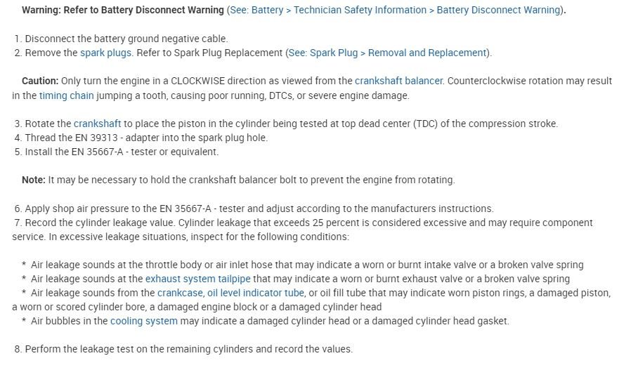

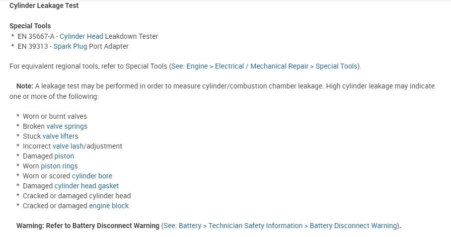

The coolant in the oil could be from a failed head gasket from overheating. I would have a leak down test performed to verify.

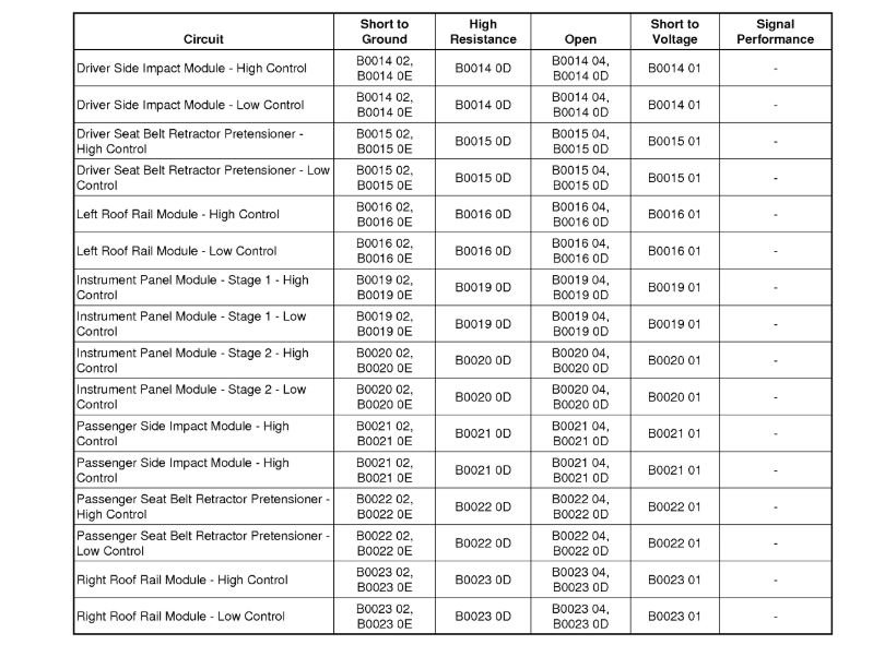

As far as the airbag light, there is a fault code stored and I need that code to narrow the area of failure. The ESC also has a fault code stored as well.
