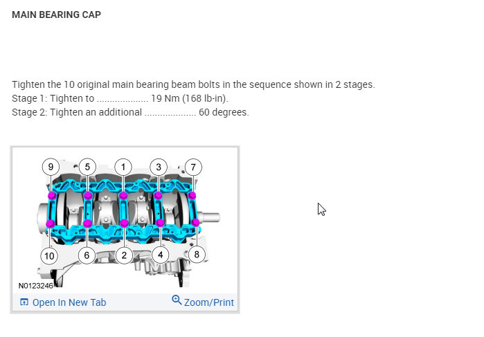

I recently pressure tested and schemed both my block and cylinder head because my engine had overheated and started mixing coolant with oil. After scheming and pressure testing my block and cylinder head i bought a new gasket set.. The engine was assembled, while running it we noticed that the coolant still mixes with oil.. Even though a new gasket was installed... What could be causing this to occur? Could you also assist with torque settings for main and big end bearings?
Oct 15, 2019 at 4:47 AM
More than likely the head is warped so the head and block cannot actual seal to keep the coolant and oil separate. I would remove the head again and straight edge both the head and block to see if there is distortion.
I attached the main bearing cap torque specs. Let me know if you have questions. Thanks
