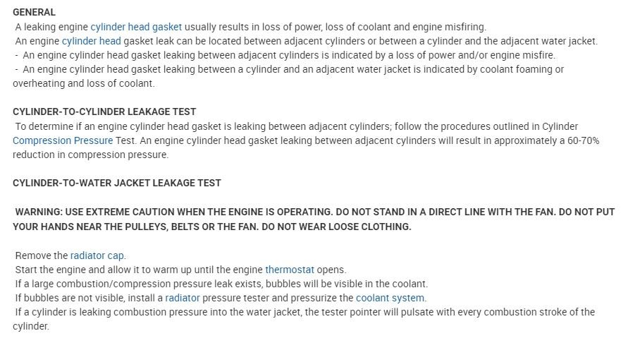

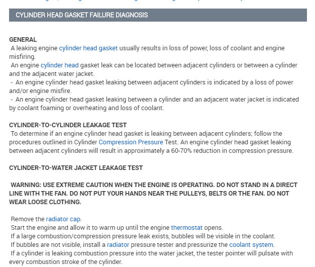

Just because it is not overheating doesn't mean it is not a head gasket issue. Unfortunately these signs do point to a head gasket issue and not anything to do with the thermostat. That may just be a coincidence.
Here are some guides on how to determine if this is the issue:
https://www.2carpros.com/articles/coolantantifreeze-in-the-engine-oil
Run through this info and let me know what you find and we can go from there. Thanks

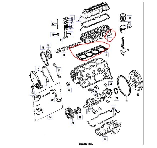

Good evening,
Just to add to the question, GM had issues with the 2.5. The back bolt on the cylinder head on the driver's side is a stud. They had issues with that bolt stretching and the head gasket leaks coolant into number 4 cylinder.
The remedy was to remove the head, replace the gasket and to replace the bolt with an updated bolt.
