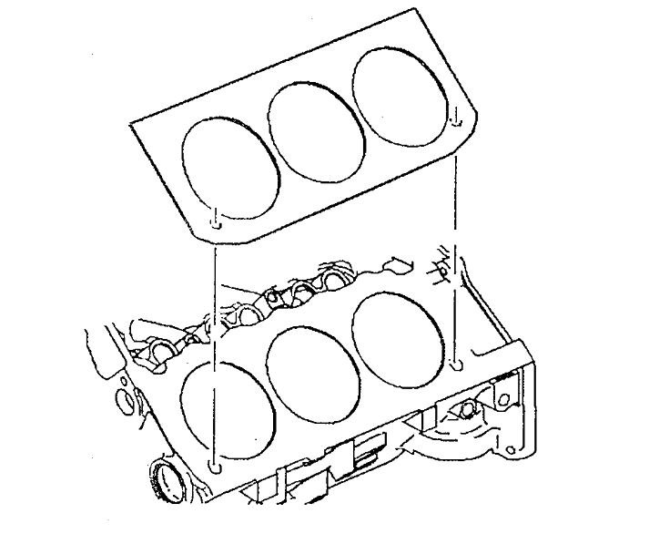

I would address this as soon as you can. Coolant in the oil damages the main and rod bearing and will result in engine failure if left alone.
https://www.2carpros.com/articles/coolantantifreeze-in-the-engine-oil
1. Inspect the cylinder head gasket and the mating surfaces. Inspect for leaks, corrosion and blowby.
2. If the gasket failed, determine the cause. Gasket failure is caused by the following conditions:
- Improper installation
- A loose or warped cylinder head
- Missing, off location or not fully seated dowel pins
- Low torque on cylinder head bolts
- Warped case (block) surface
- Scratched surfaces
- Excessive inlet manifold torque
- Cracked engine block tapped holes
