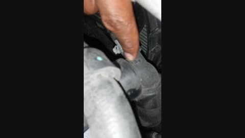

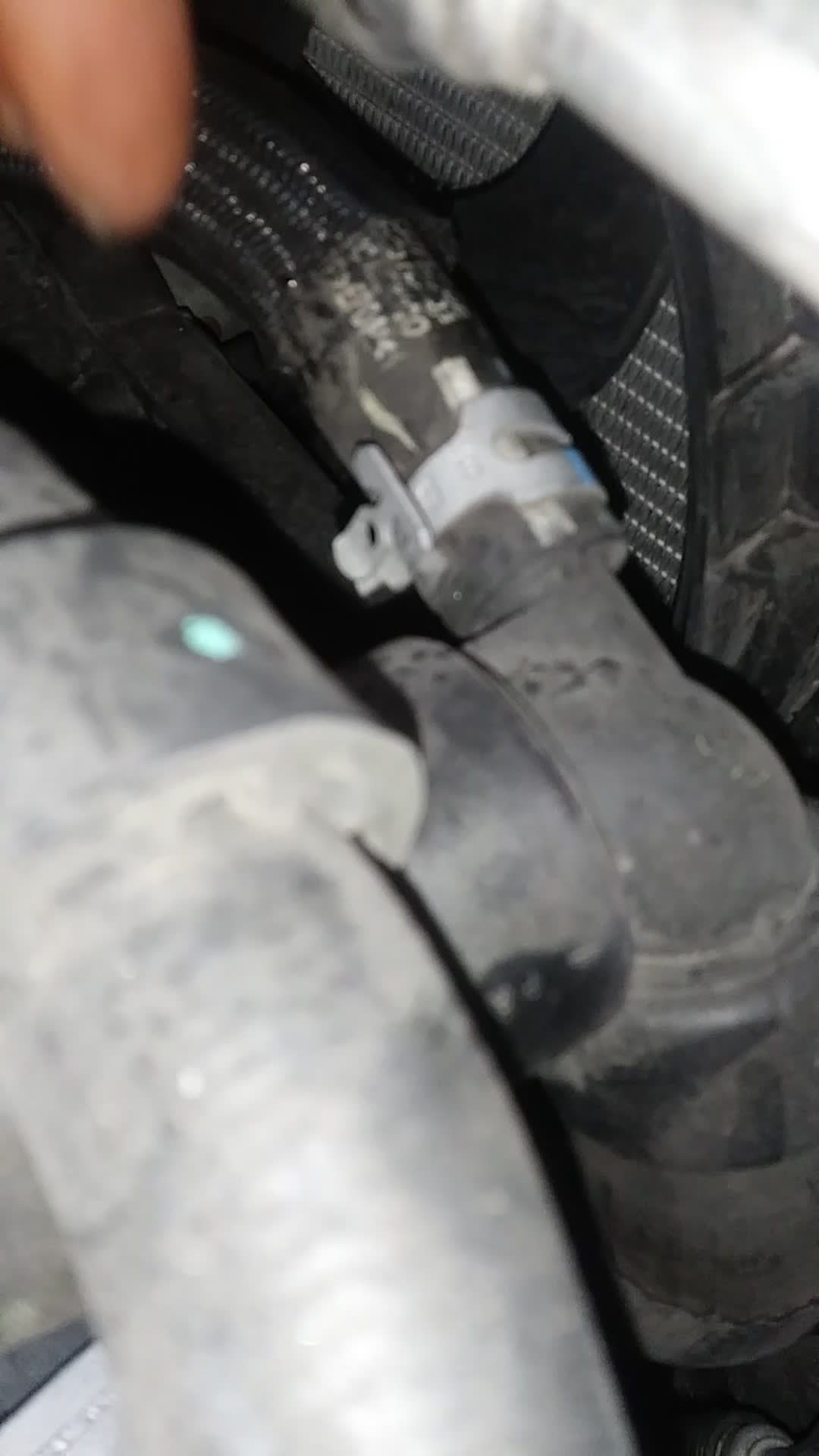

Can you please shoot a quick video with your phone so we can see what's going on? that would be great. You can upload it here with your response.
Jun 25, 2019 at 6:24 AM
MAX STONE
This is the hose. I uploaded pictures also, don't know if they went through. Thanks for the help also.
Jun 25, 2019 at 9:23 AM
  • 55,399 POSTS

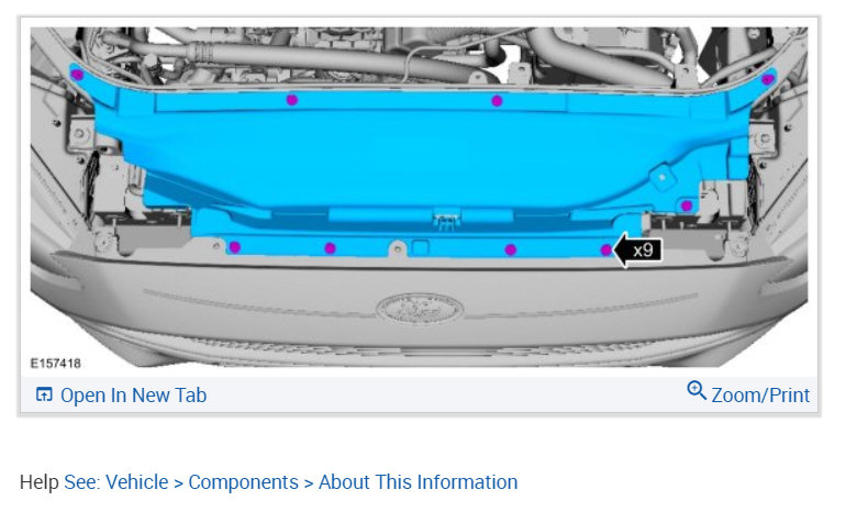

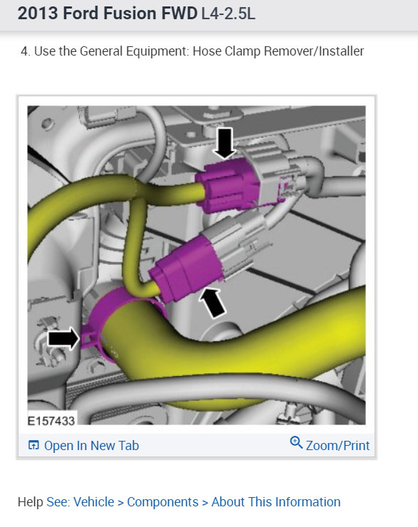

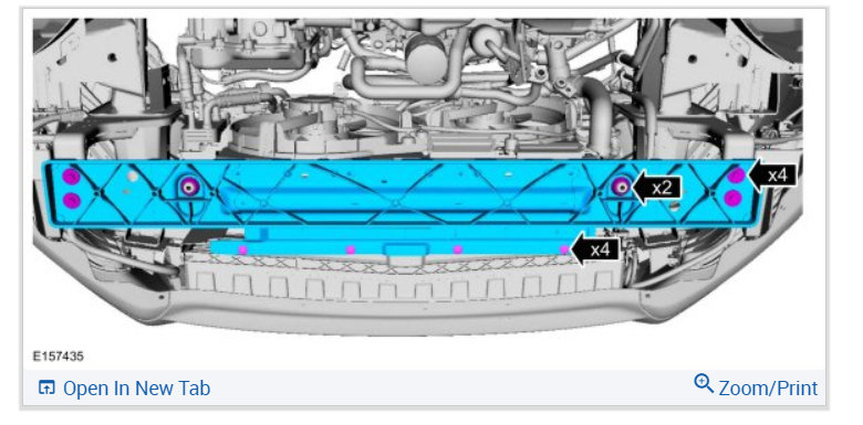

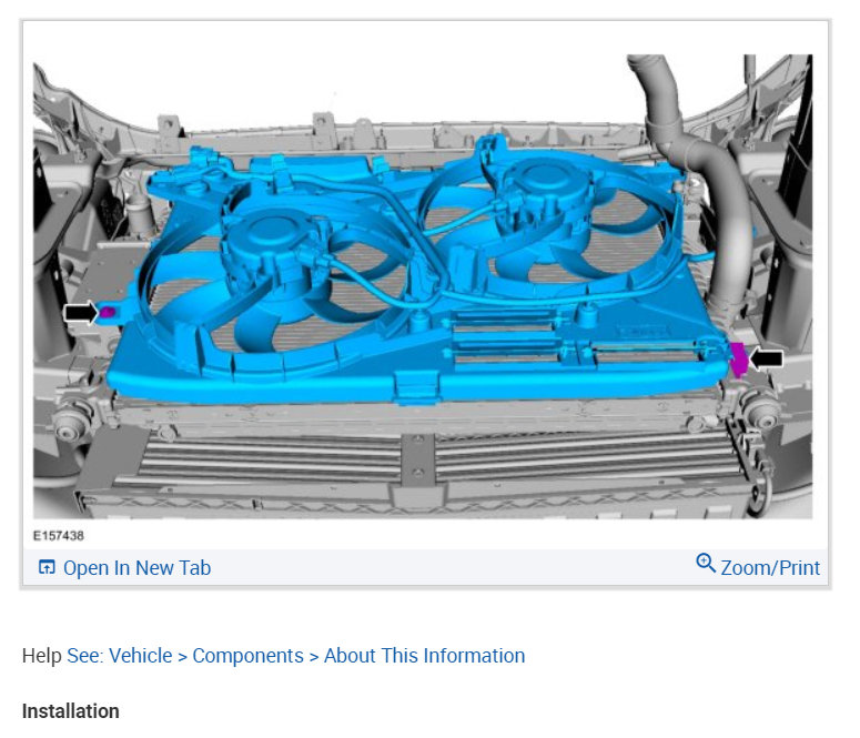

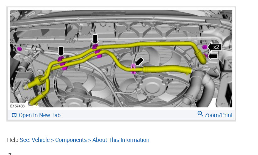

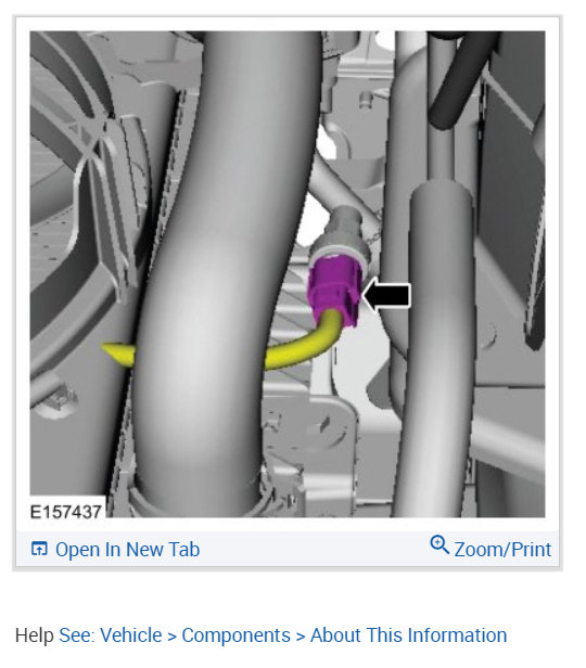

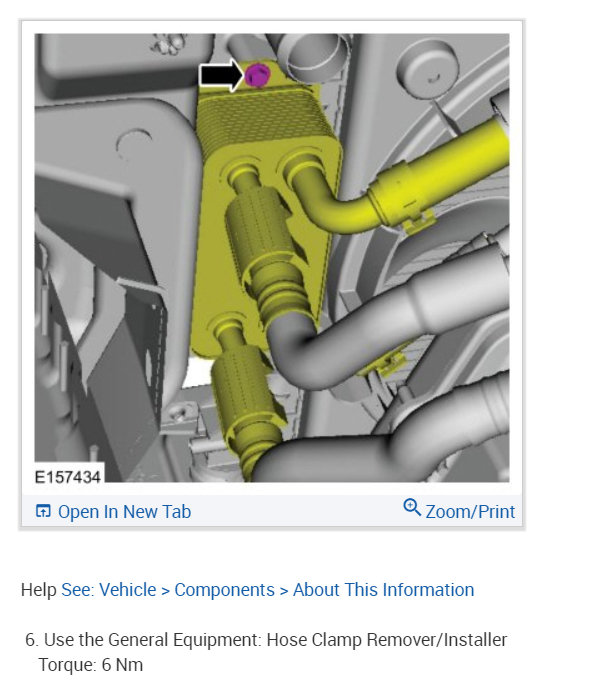

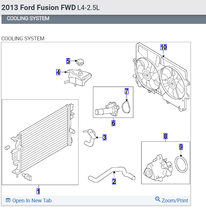

Thanks for the video. that looks like the coolant hose to the oil cooler. here are the prices and times to the cooling system and instructions and diagrams below to show you how to do the job:
PRICE
Radiator
Lower Hose
3 - Lower Hose
DG9Z8286D
25.93
Radiator
1 - Radiator
DG9Z8005K
199.80
Upper Hose
2 - Upper Hose
DG9Z8260DB
20.67
Cooling System
Cap
5 - Expansion Tank Cap
DG9Z8100A
6.13
Expansion Tank
4 - Expansion Tank
HG9Z8A080B
69.88
Gasket
7 - Gasket
3M4Z8255A
21.56
Thermostat
6 - Thermostat
3M4Z8575B
60.49
Includes: Thermostat Housing.
Water Pump
Gasket
9 - Gasket
1S7Z8507AE
10.75
Water Pump
8 - Water Pump
4S4Z8501D
40.53
Includes: Water Pump Gasket.
Cooling Fan
Fan & Motor
10 - Fan & Motor
DG9Z8C607D
265.49
Includes Fan, Motor And Shroud.

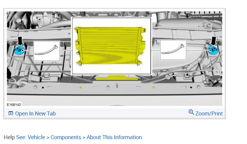

Thanks for all the help. It was the bottom hose in the 4th diagram. Even the pats guy at ford had to come out and look at it a couple of time. It was $25.00 and change with the tax and took about 20 minutes to change. The shop wanted $174.00 to change it. That included to gallons of antifreeze at $35.00 (only needed one) and $46.95 for the hose.
