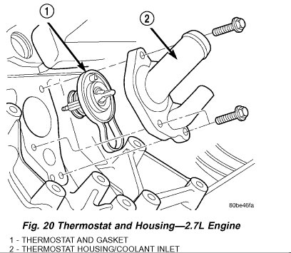

I just bought this car and when they drove fifty miles to bring me the car. I looked inside car and thought that since the temperature gauge was about straight across and the red is way up top I was not sure if it was getting hot or not. I drove it a couple times around twenty to fifty miles and had to pass with just a little extra gas not excessive and it seemed to steam a little when got home. It runs and sounds fine but the temperature gauge goes now 1 to 2 lines over line which is the first line but indicator has traveled over half way. Oil looks fine and cannot see radiator cap just overflow.

Hi and thanks for using 2CarPros.com. The problem you mentioned could be a few things. Since, however, you just purchased the vehicle, you are most likely not familiar with the maintenance which has been done in the past. What I would suggest is to flush the cooling system and replace the thermostat. Here are general directions for flushing the cooling system:
https://www.2carpros.com/articles/coolant-flush-and-refill-all-cars
Additionally, as preventative maintenance, I would suggest replacing the thermostat. Here are the directions for that and should be done at the same time you flush the system since the coolant will already be drained. Picture 1 is the thermostat and housing.

Disconnect hoses at thermostat housing.
Remove thermostat housing bolts.
Remove thermostat and housing.
INSTALLATION
Clean gasket sealing surfaces.
NOTE: Install thermostat with the bleed valve located at the 12 o'clock position.
Install thermostat and gasket into the thermostat housing.
Fig. 20 Thermostat and Housing - 2.7L
Install thermostat and housing to cylinder block. Tighten attaching bolts to 12 Nm (105 in. lbs.) .
Connect hoses at thermostat housing.

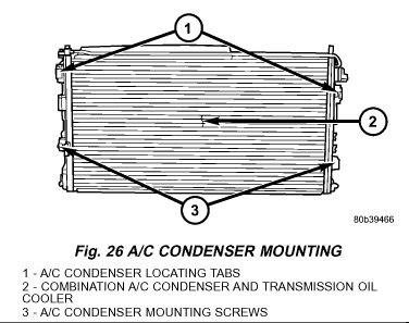

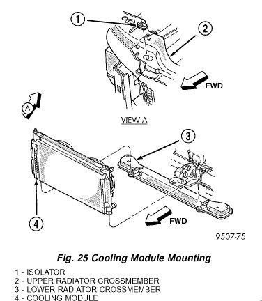

If you find the radiator to be bad, here are directions to remove and replace it. I've attached pictures for the process. Pictures 2 and 3 are related to these directions.

Fig. 25 Cooling Module Mounting
Remove upper radiator crossmember.

Fig. 26 A/C Condenser Mounting
Remove the air conditioning condenser attaching screws located at the front of the radiator. Disengage AC condenser from radiator. It is not necessary to discharge the air conditioning system to remove radiator.
Radiator can now be lifted free from engine compartment. Care should be taken not to damage radiator or condenser cooling fins during removal.

Slide radiator into position and seat the radiator assembly lower rubber isolators in the mount holes.
Attach air conditioning condenser to radiator. Tighten mounting screws to 5 Nm (45 in. lbs.) Install transmission oil cooler tube support bracket and attaching screw to left side of radiator. Tighten mounting screw to 5 Nm (45 in. lbs.) .

Install upper radiator crossmember.
