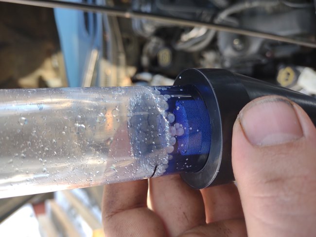

As I'm driving the car, if I'm under a heavier load the cars coolant temperature gauge will rise. If I stay in the throttle long enough it will rise to around 3/4 staying under the red, but not actually overheat. If I lift off the throttle it almost immediately returns to just under half on the gauge in less than 10 seconds. The coolant pipes aren't any extra hot. The heat stays warm. The fans are on high during the instance. It won't happen until the car has actually gotten to operating temperature. The gauge doesn't rise while it sits, and it doesn't rise quickly while warming up. There's white marker in engine bay says "hg 178642" The water pump and belt looks recently replaced. Thermostat has been replaced. It doesn't use any coolant or bubble when the gauge rises.

I think you are on the right track with some of the things you have checked.
This is normally one of two causes. Clearly, we could have other things going on but the most common causes of this are a head gasket that is starting to fail, or you have an air pocket.
So, let's start with checking the head gasket just to be sure. So that means we need to start with using the chemical test that is shown in this guide:
I doubt you will find the other signs if this only causes an issue when you are accelerating so we need to get the engine hot and then rev the engine while using this blue chemical to see if you are getting any change in the color to show there are combustion chamber gases.
If there are not any then we need to bleed the system and make sure there are no air pockets.

The coolant looks very clean, I've drained quite a bit doing the thermostat once and the gasket again a separate time. But a flush can't hurt. I bought the blue chemical and the block tester and tried that for a few minutes with the chemical staying blue. Then I had an idea to get the bubbles out. I used the big yellow spill free funnel and filled it about halfway with coolant and gave the car some revs with the heat all the way on. Some bubbles came out at first, but the coolant gauge still acts the same.

Okay. That is great info and a great result.
