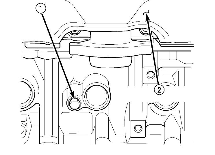

I know but where are the drains on the block or are you talking about pulling freeze plugs out?
Oct 12, 2018 at 9:05 AM
There are small plugs about the middle of the block on each side. They are pipe plugs around 1/4 or 5/16. They are the drains for the block. I do not have a picture of them or I would post.
Oct 12, 2018 at 9:09 AM
CORY2427
  • 293 POSTS
Are they underneath the truck towards oil pan or are they on side of the block?
Oct 12, 2018 at 9:11 AM
They are on the side of the block down low by the oil pan.
Found a picture.
