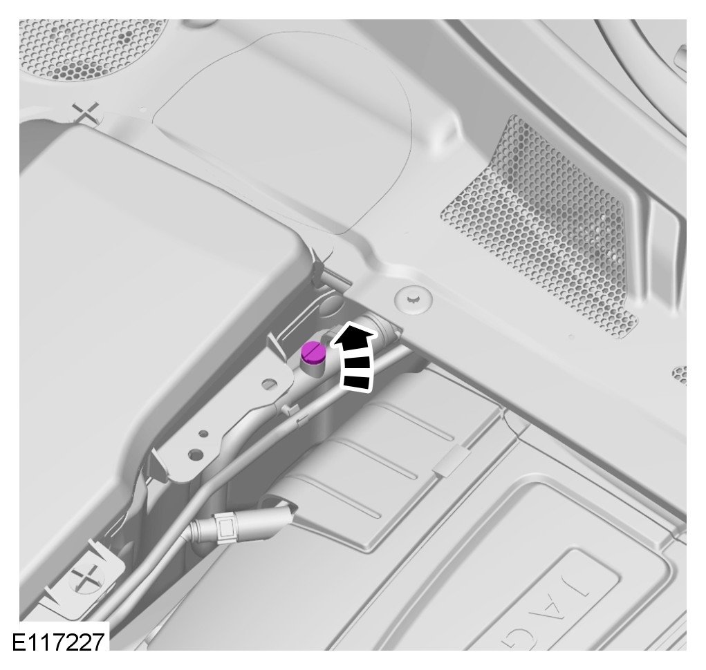

How to drain and refill and is there a bleeder for the air?
Nov 19, 2017 at 10:16 AM
JIS001
  • 3,412 POSTS
Remove the coolant bottle cap off. There should be a plastic screw plug at the bottom of the radiator. Loosen just enough to where you see it draining. The sides of the block you should have plugs also you can unscrew to drain.
Here is the fill procedure and posting an image of what appears to be the bleeder screw:

Fill the cooling system, keeping coolant to the upper level mark of the expansion tank until a steady stream of coolant is seen running from the coolant hose bleed point.
