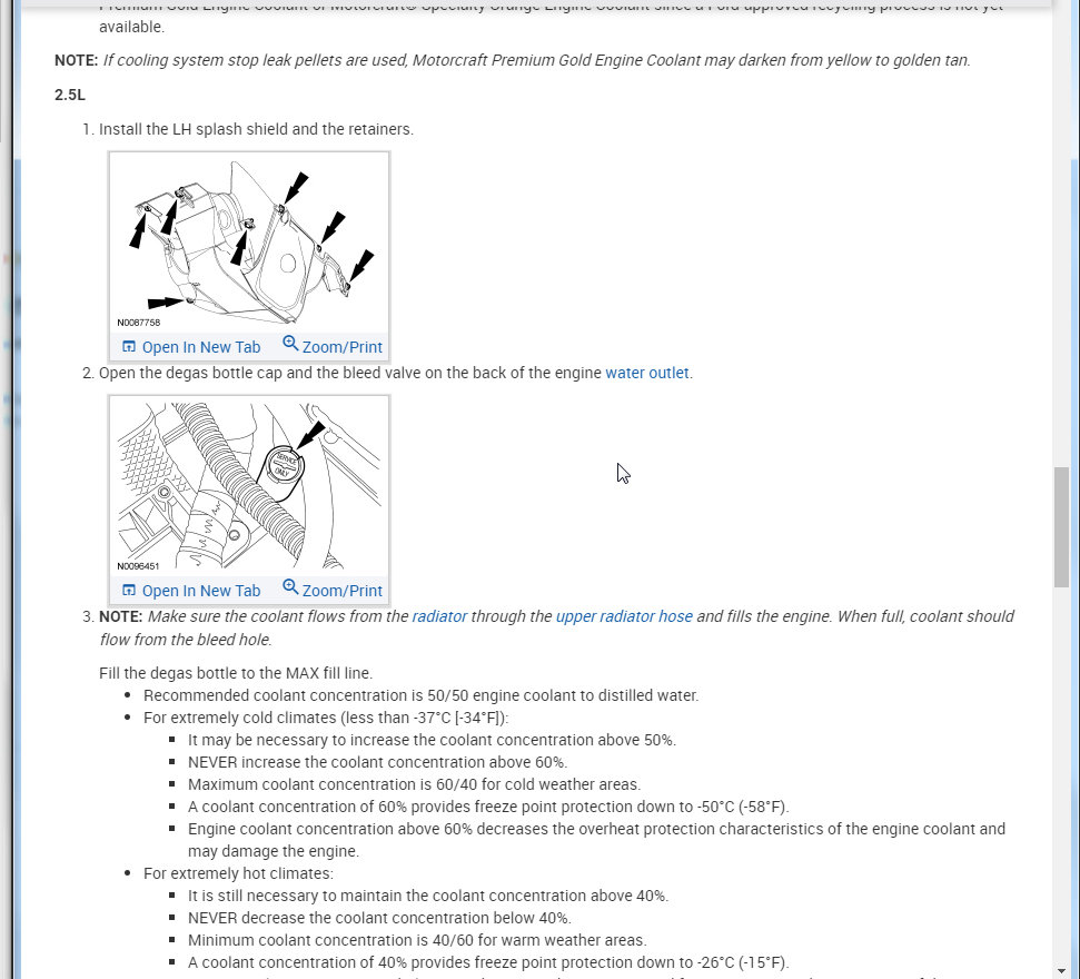

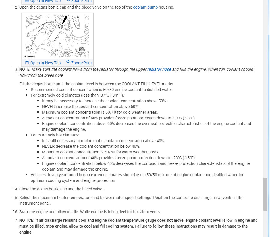

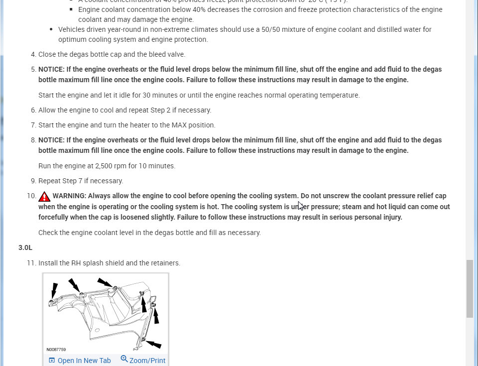

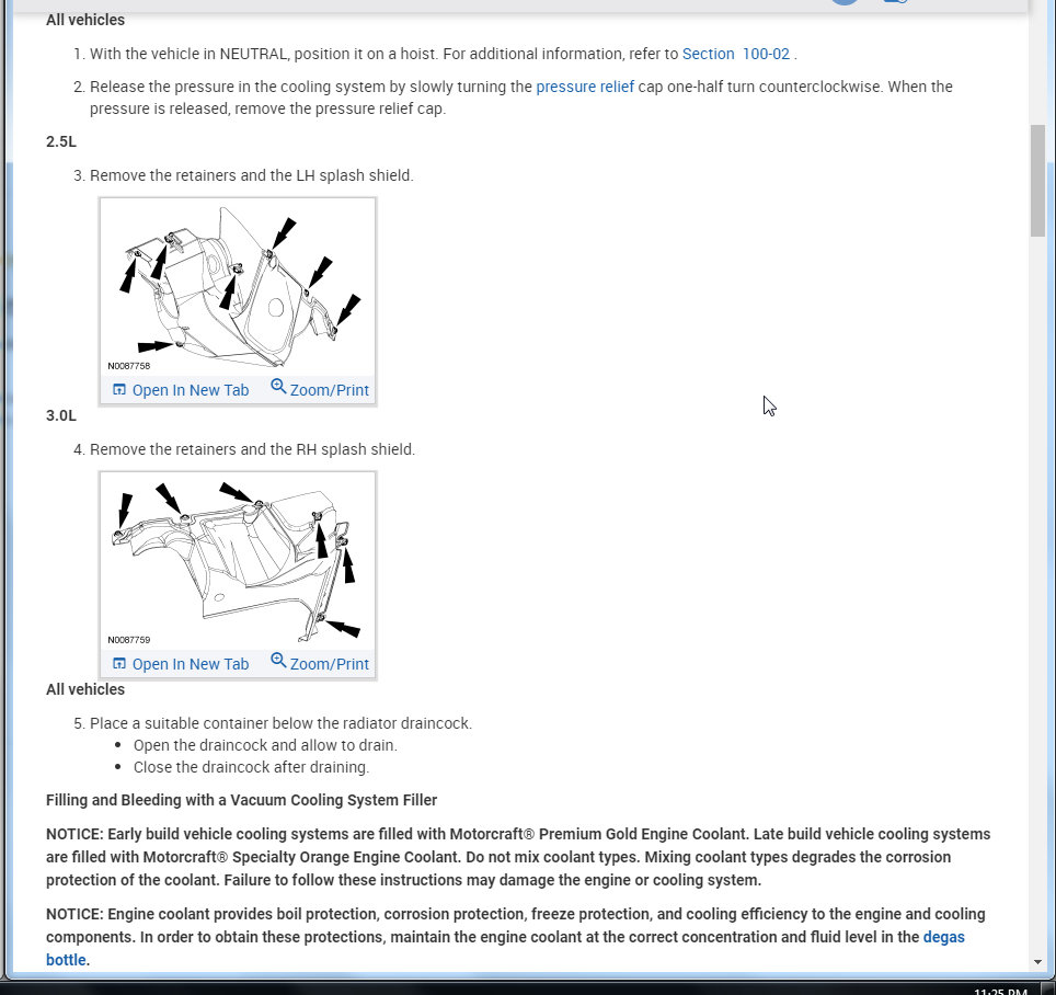

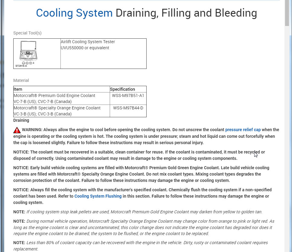

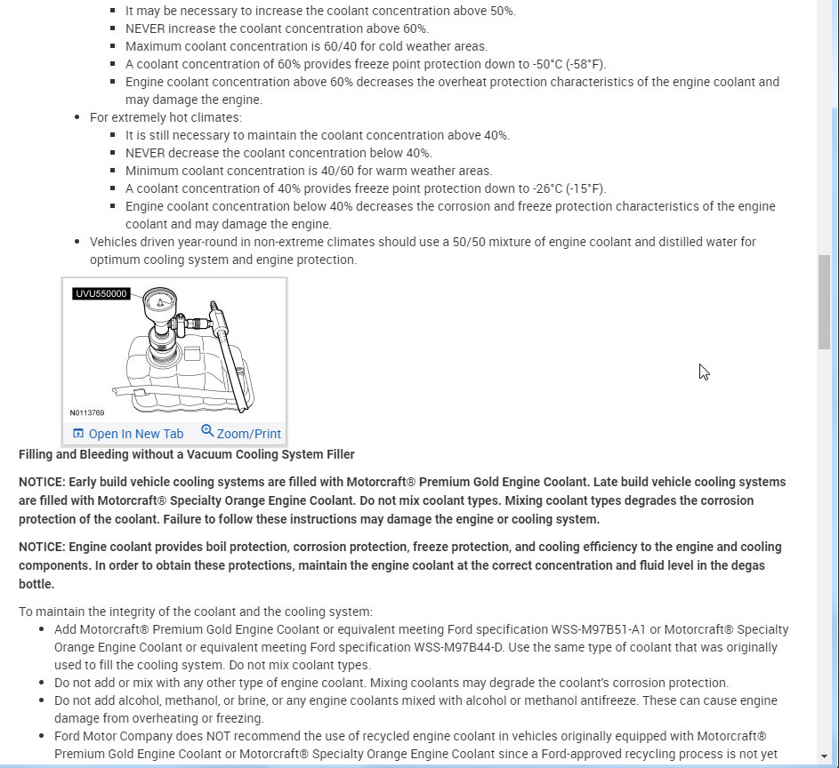

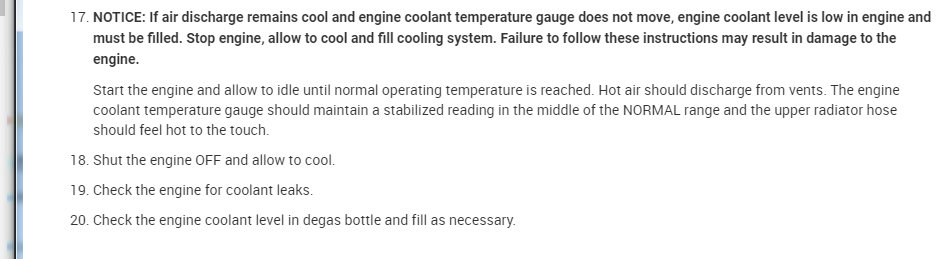

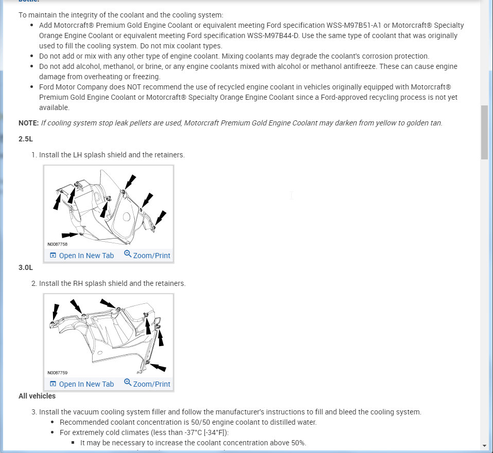

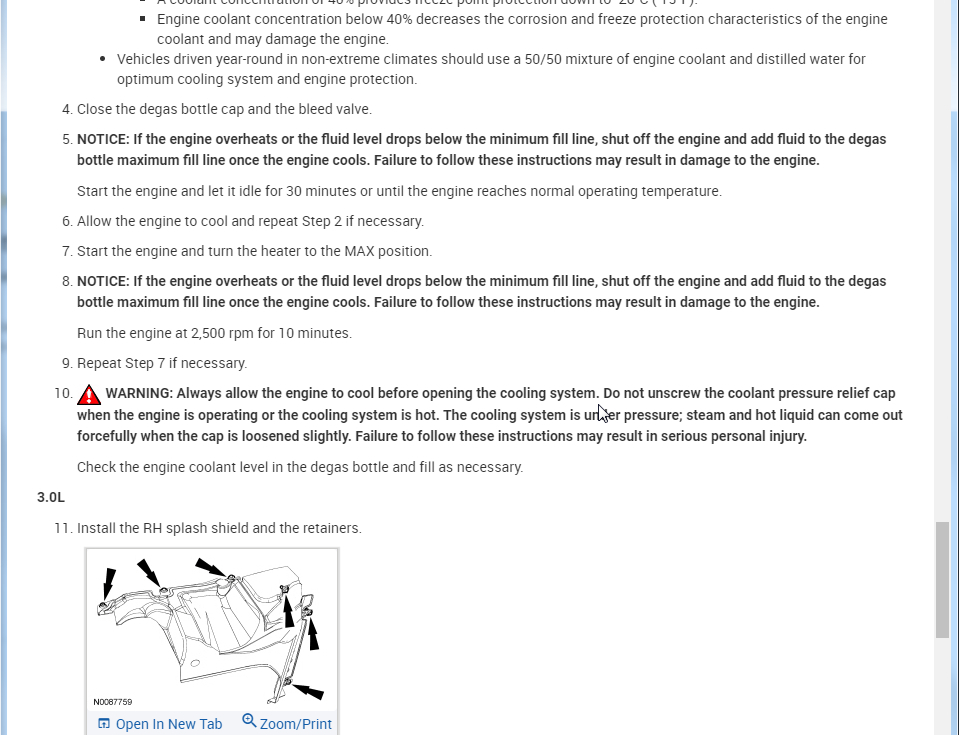

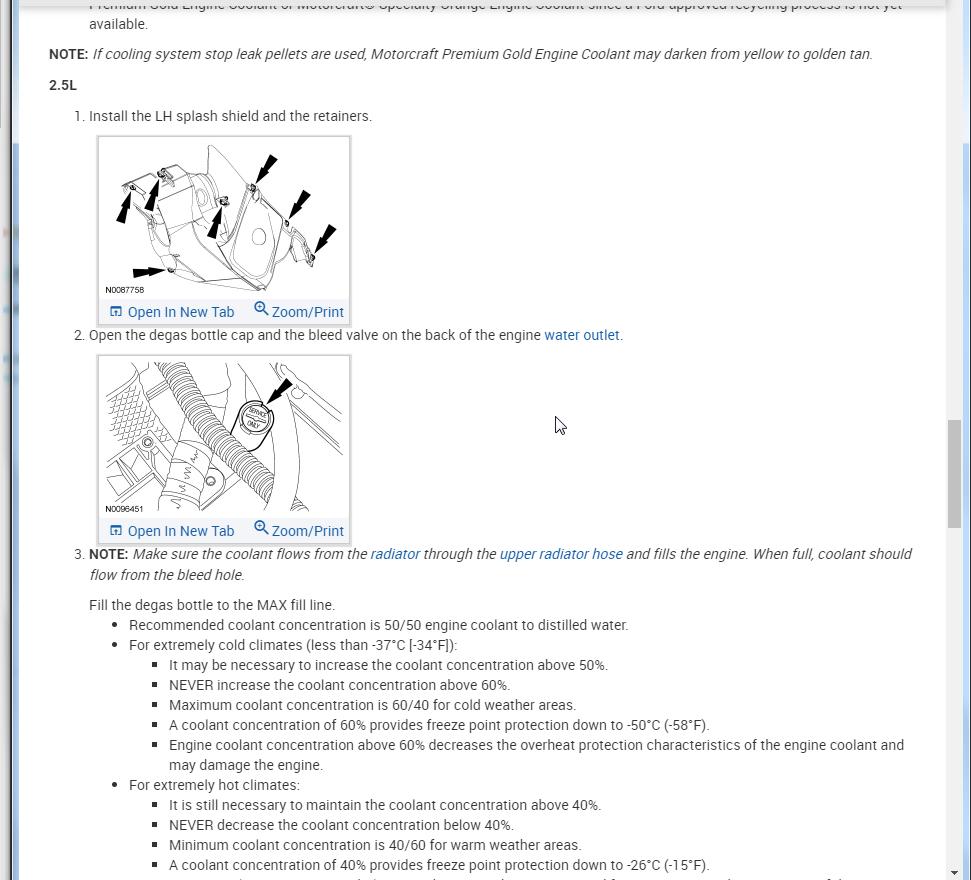

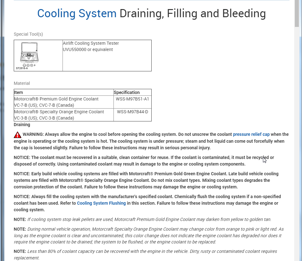

Fans come on high speed and have never done this before ever. So it’s possible My cooler is degraded and needs flushing. I will take temp data while the fans are on, then flush coolant system and wash down and clean radiator of any debris and see if the Delta-T comes down. Does my coolant system require air bleeding? I have read that some ford engines create air pockets when refilling system. I don’t have a radiator cap on cooler it all goes through the reservoir. I will post the results after I do the flush. Thanks for your input. David
Sep 4, 2020 at 9:25 AM
I attached the entire cooling system process including the bleed procedure because you do have bleeder valves. Let us know how it turns out. Thanks
Sep 4, 2020 at 1:28 PM
1BIGEYE
Thanks for the cooling data guidance. After flushing/bleeding system and cleaning coolers it didn’t make any noticeable difference. Actually the issue is getting worse. The fans go into high speed and extreme high vibration. The temperature is normal and no change in engine RPM's. The fans cycle on and off every 5 minutes. I am not sure what makes the fans go into this high speed and high vibration mode of operation. I checked the fan mounting brackets and based on how it’s designed, I didn’t see any bushing degradation that would contribute to the vibration that is happening when these fans go into this high speed mode of operation. Is there a fan speed controller integrated into this fan design? Next step looks like I need to replace the fan assembly. I have seen a couple videos on how this is done. Any additional guidance or input would be greatly appreciated. Thanks for your support. David

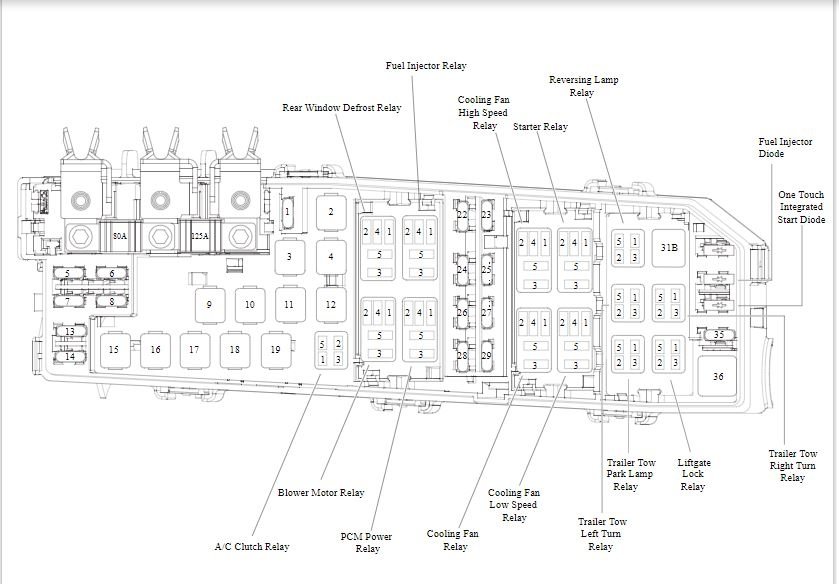

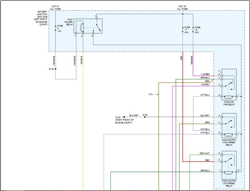

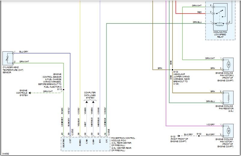

It sounds to me light you cooling fan relay is sticking. below is the electrical diagram for that circuit and the fan relay location.
Let me know if this helps and if you need any other assistance.
Tom

The vibration is not normal. That could be the motor itself causing this issue.
The high and low speeds are normal based on the temperature of the coolant . The signal for that comes from the coolant sensor and the ECM will command high or low based on that input.
