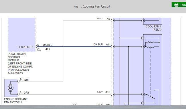

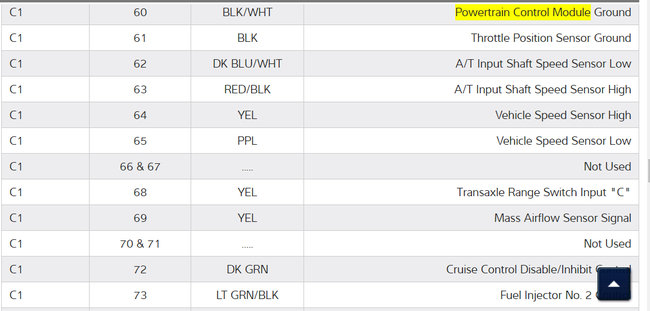

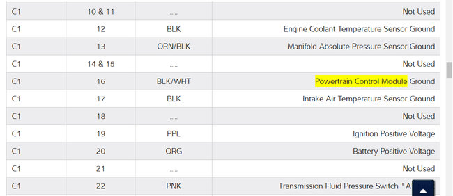

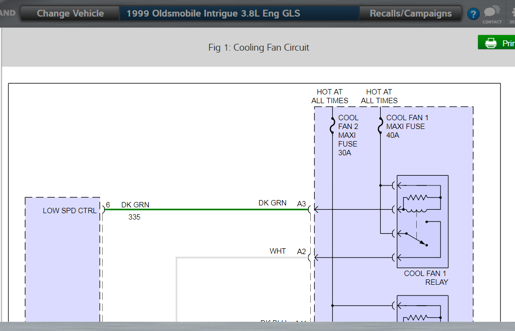

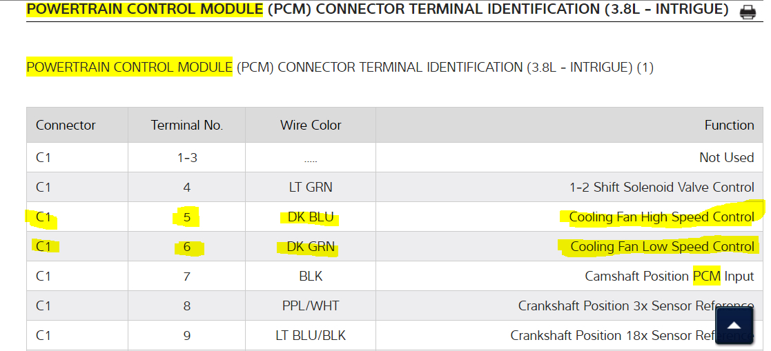

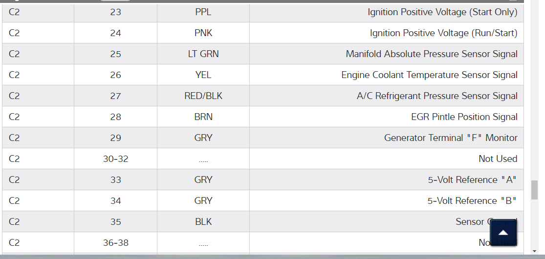

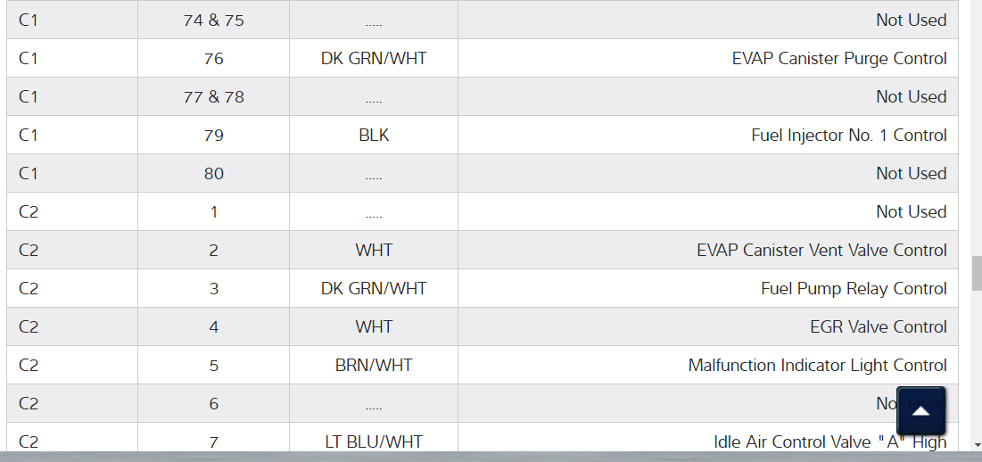

Coolant fans do not come on, not even by unplugging coolant temperature sensor. I replaced coolant temperature sensor, tested three fan relays, both max fuses, both fan motors, they are all working. checked as many wires and connectors as I could. what could I have missed?
Apr 14, 2019 at 11:54 AM
SCGRANTURISMO
  • 4,897 POSTS
Hello again,

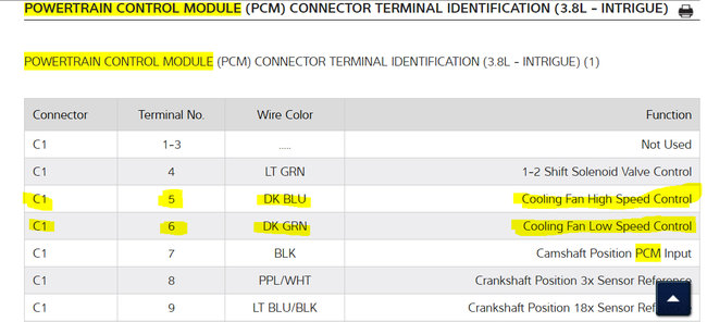

The only other component in the cooling fans circuit is going to be the Power-train Control Module (PCM). You can check the two wires and the PCM connector for any corrosion or unwanted resistance, but other than that I would have to say, by process of elimination, the PCM is bad. Let us know what you are able to find out, please.
Thanks,
Alex
