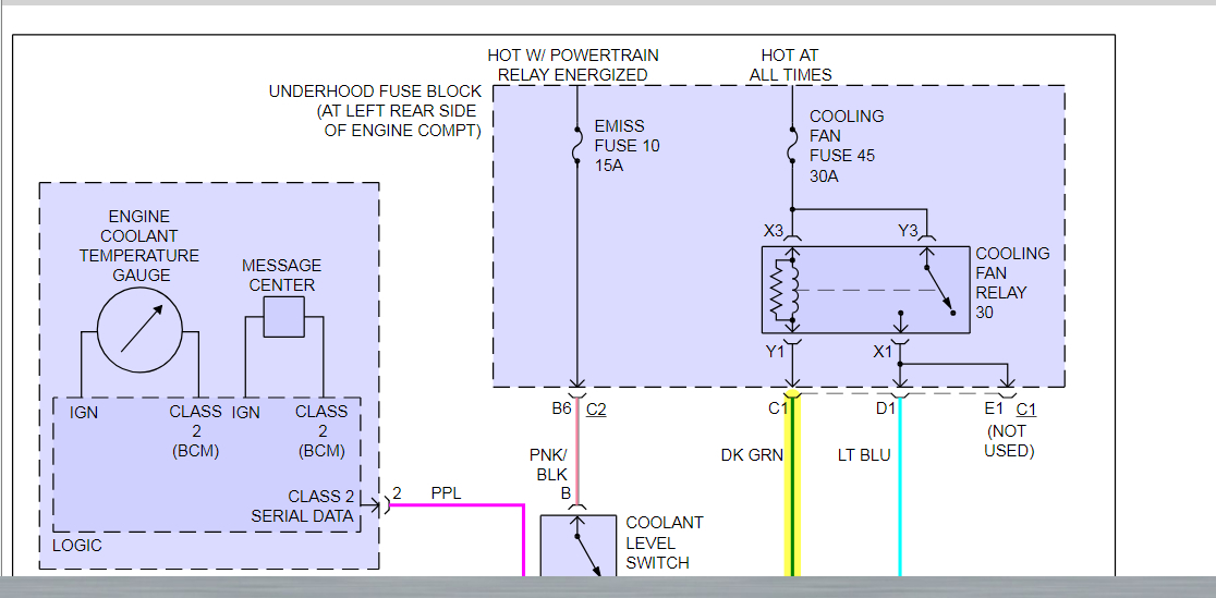

My fan turns on within thirty seconds after starting and stays running until I turn off. Also the temperature gauge always reads cold. I changed the temperature sensor and the problem was fixed for about a day, then the issue returned. I replaced the sensor again and still having the issue. I checked the relay switches in the fuse box but no issues there. Any advice on troubleshooting my issue will be appreciated.

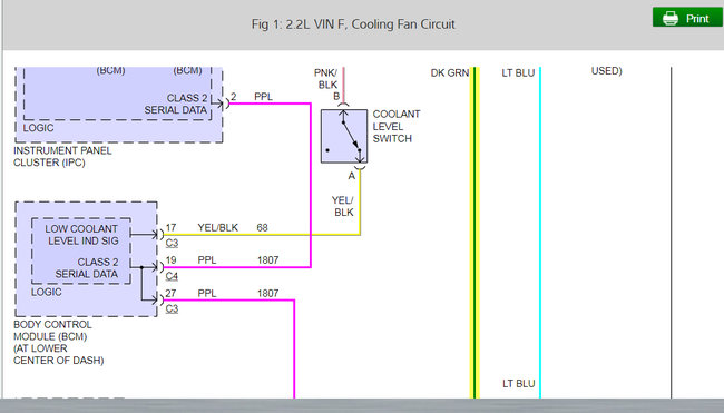

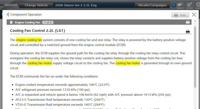

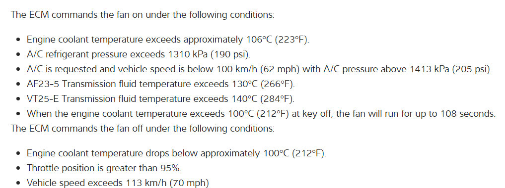

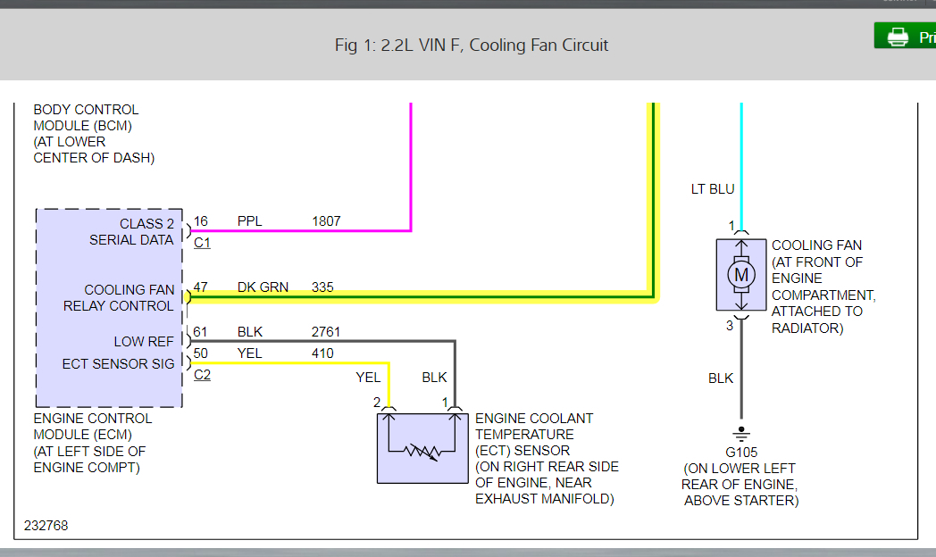

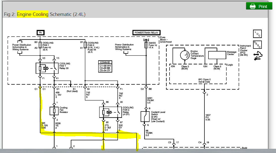

This sounds to me like you could possibly have a short to ground on the ground wire from pin #47 of the Engine Control Module (ECM) to the Control Side of the Cooling Fan Relay Connector pin #C1. I have included a description of the engine cooling fan circuit as well as your vehicle's cooling fan circuit in the diagrams down below. I have hi lighted the wire to check for you, it is the dark green wire. Look for bare wire that is grounding out or damaged insulation. Please get back to us with what you are able to find out, please.

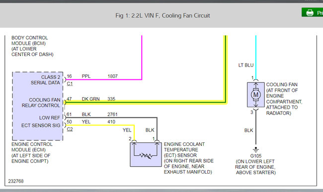

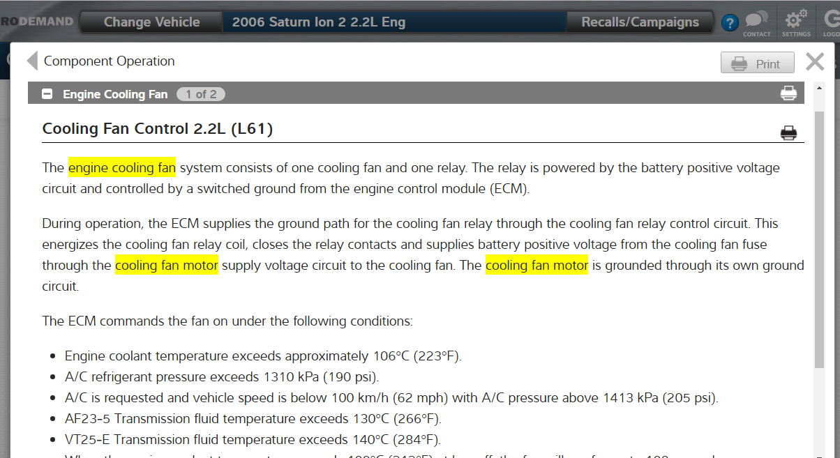

Double check the dark green wire again. This is the wire going to the ECM. When the ECM wants the turn the fan on, it's through this wire that provides a ground path to the electromagnetic coil to energize it and send battery voltage to the fan. Get back to us with what you find out please. And no, I don't think you will need to reset the Keep Alive Memory (KAM) in the Power-train Control Module (PCM) by unhooking the battery.

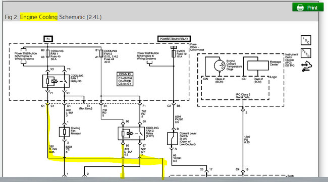

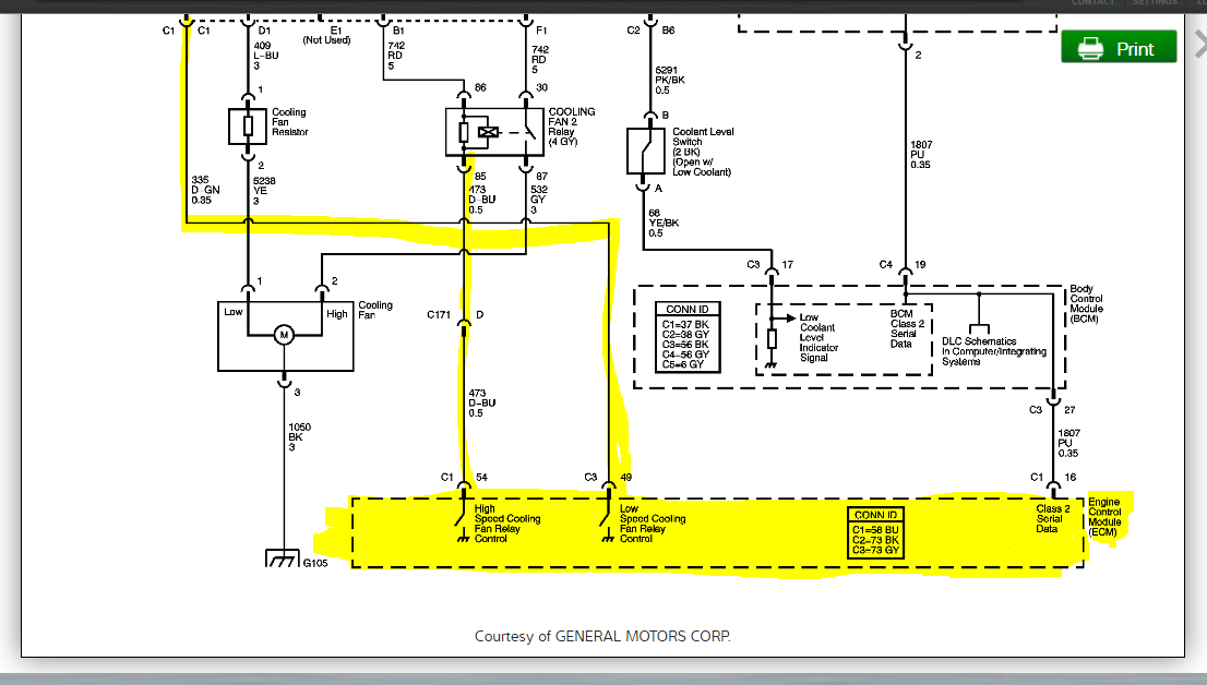

This could also be a problem with your vehicle's Engine Control Module (ECM). It provides the ground to both the high and low speed fan relays control side of the relay which energizes the coil and pulls the switch closed allowing battery voltage to reach the cooling fan motor. I have included in the diagrams below the Engine Cooling Schematic from Saturn with what I am talking about highlighted for you. Again, please let us know what you find out or decide to do.
