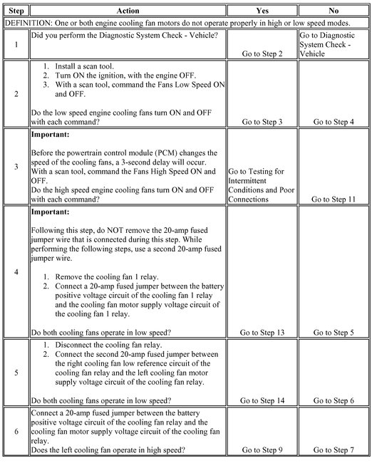

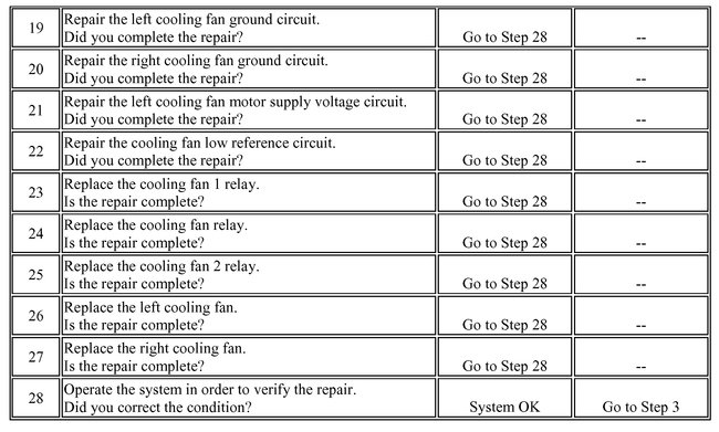

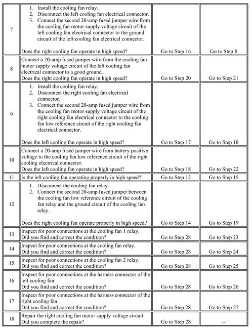

With that, I have attached diagnostic flow charts. There are three of them that walk you through a process, but you need a scanner to perform the test. If you do, take a look through them.

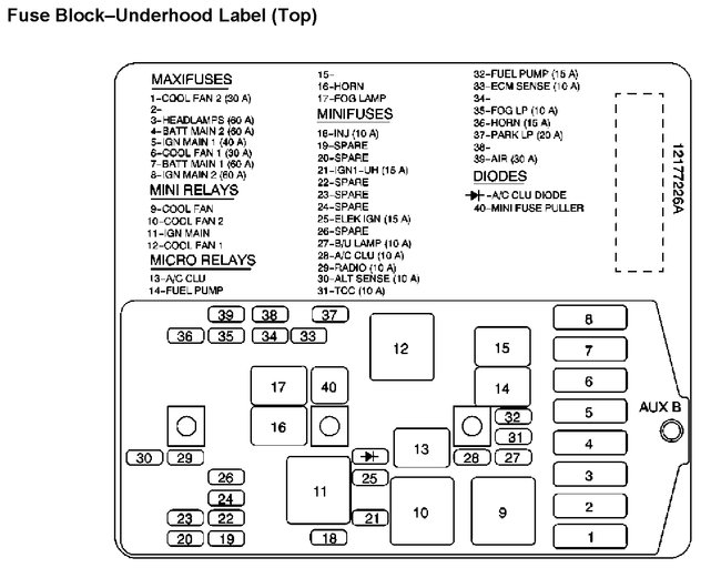

If you don't first check fuses 1 and 6 in the under hood fuse box. See picture 4. If they are good, then remove the fan relays. There are a total of 3 of them. (relays 9, 10, and 13.) Picture 4 shows the lay out of the fuse box under the hood.
