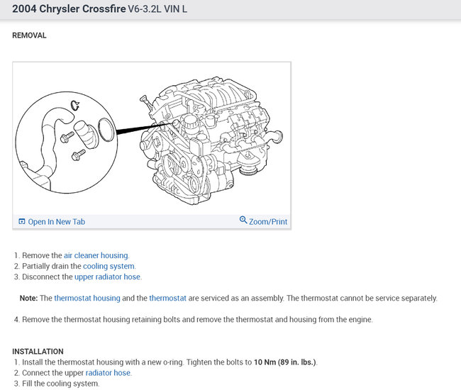

Coolant fan at various times and more frequent lately will make excessive noise and seem to be stuck in high mode sometimes even when I first start it. I'm not overheating so what's the fix? Is there a way to test the engine coolant sensor or tell if the thermostat is stuck open? Or a way to tell if the fan controller module is bad. Keep in mind that I really do know about vehicles and reading meters. The car runs fine but that noise!

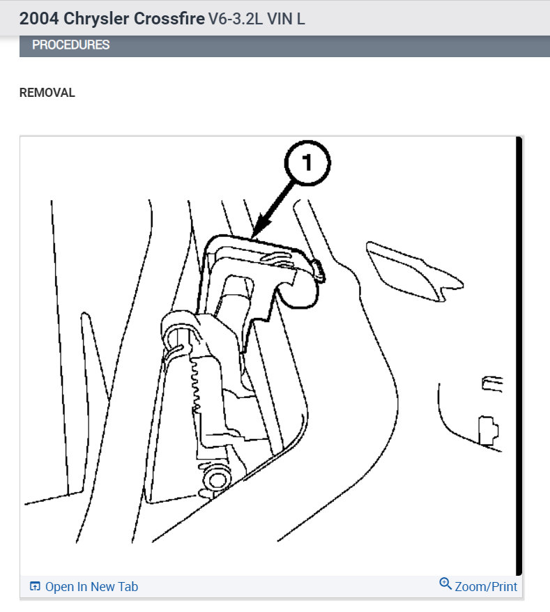

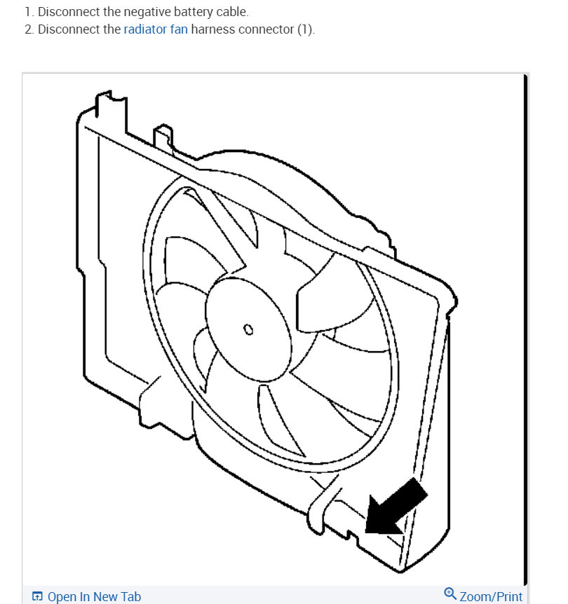

The noise is telling you the fan is going bad, which is common. We should do a CAN scan which is easy, you can get a CAN scanner from Amazon for about $30.00. here is a video to show you how and a link to a scanner from Amazon:
https://youtu.be/u-4syLc-ifQ
and
https://amzn.to/3OpAotj for the scanner

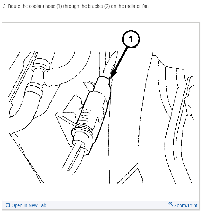

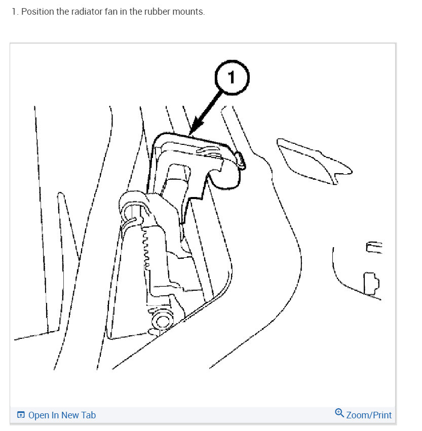

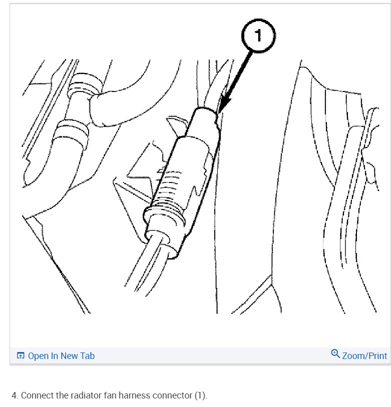

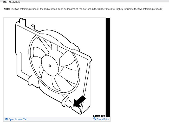

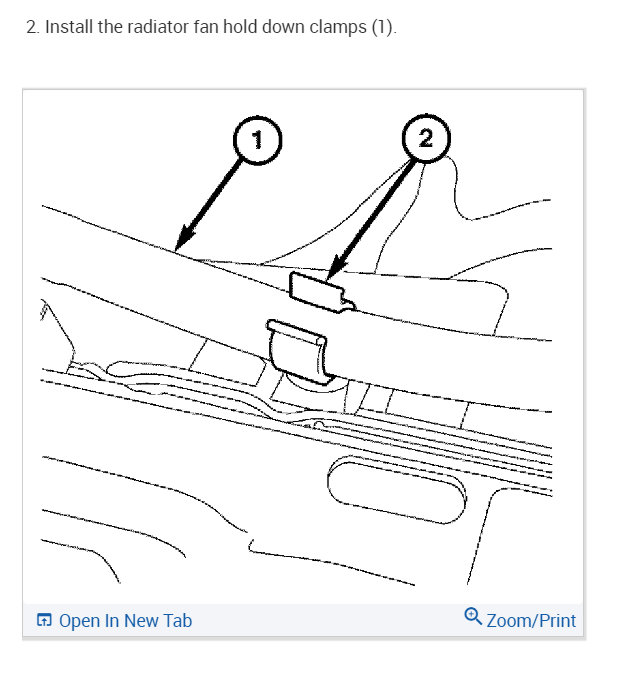

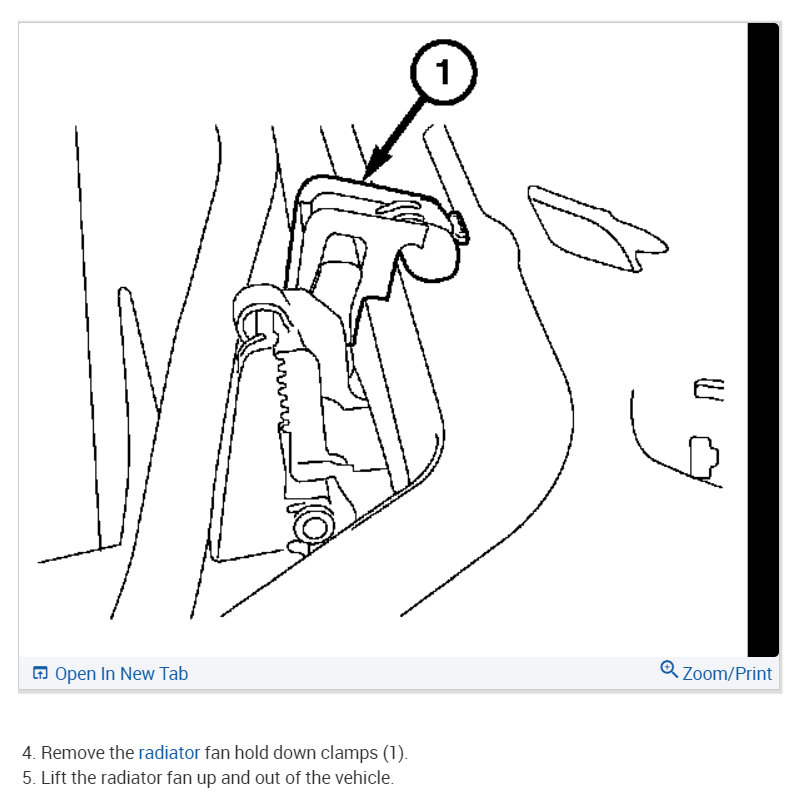

This will tell if the fan controller or coolant sensor is bad, I would replace the fan first to see if that fixes the problem. Here is a generic guide and the specific instructions in the diagrams below to show you how on your car:
https://www.2carpros.com/articles/replace-electric-fan-motor

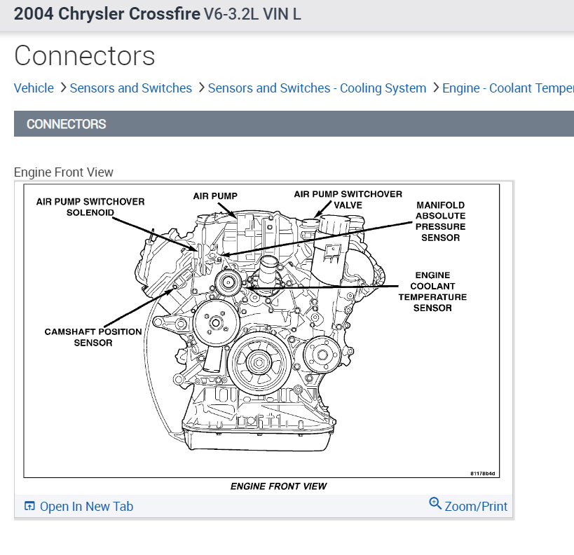

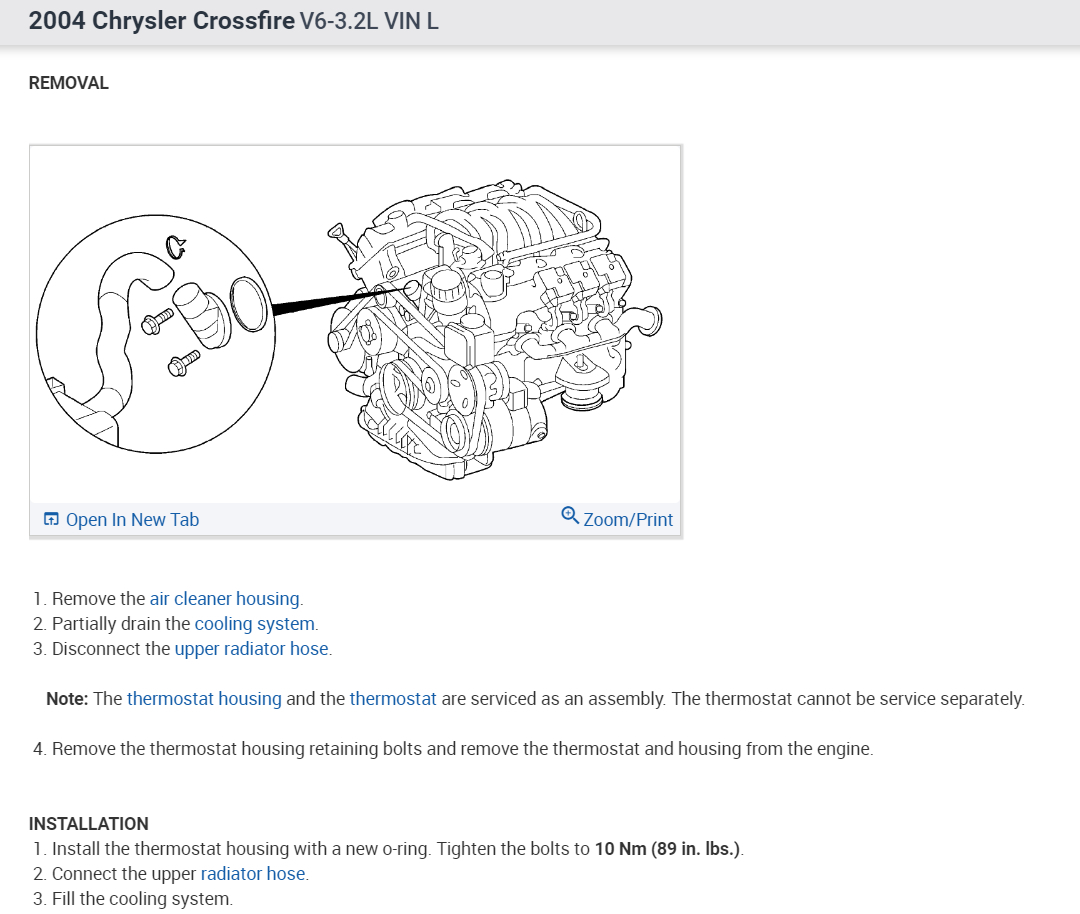

It also threw a P0128 code, and the temperature gauge seems lower than usual which led me to believe it was the sensor, or the thermostat stuck open.
Jul 3, 2022 at 2:31 AM
  • 55,224 POSTS
Yep, both will do it, here is the location of the sensor and thermostat so you can check it out. Check out the diagrams (below). Please let us know what happens.
