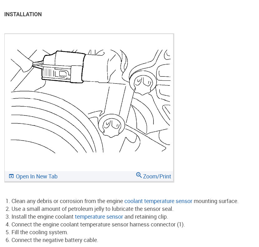

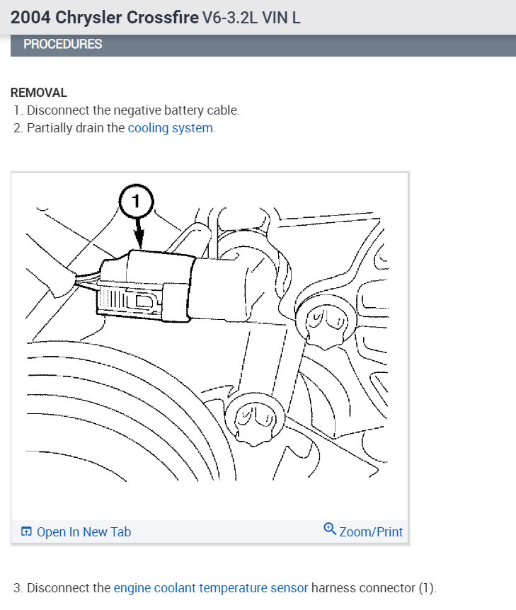

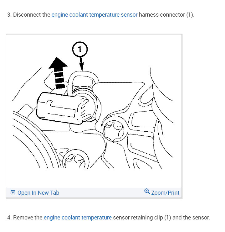

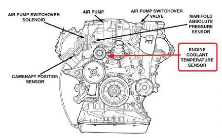

where is the engine coolant temperature sensor located on this 04 crossfire?
Jun 11, 2010 at 4:13 AM
BLUELIGHTNIN6
  • 16,542 POSTS
Hello Your vehicle's engine coolant temperature (ECT) sensor is located at the front of the engine, pictured below. Also check out the diagrams there are more instructions on how to replace it
