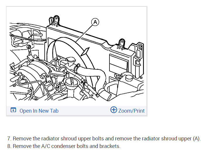

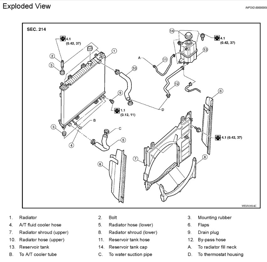

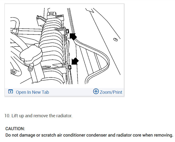

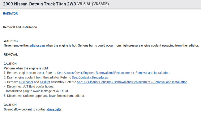

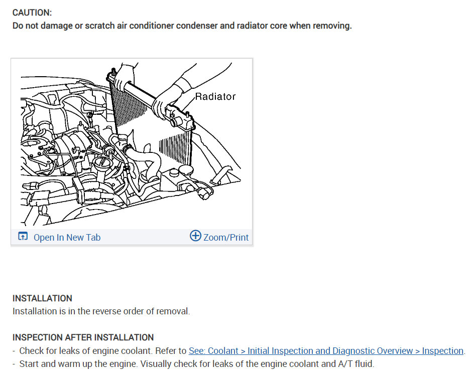

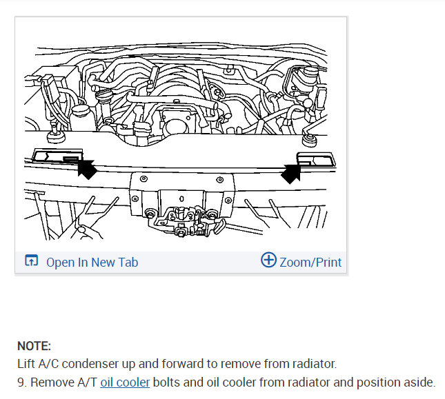

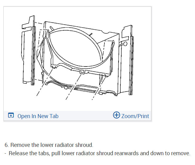

So, it looks like the radiator cap is not supposed to hold pressure, this is done by the reservoir cap. If you upload an image of the leak I can tell for sure. To me it sounds like the radiator itself does have a crack which can be difficult to see.
Here is a generic guide to help you step by step with instructions in the diagrams below to show you how on your car:
https://www.2carpros.com/articles/how-to-replace-a-car-radiator
Check out the images (below). Please upload pictures or videos in your response to the problem so we can see what's going on.

Nice, here is a guide to help you with the pressure test:
https://www.2carpros.com/articles/radiator-pressure-test
Please go over this guide and get back to us.

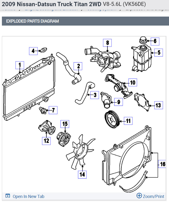

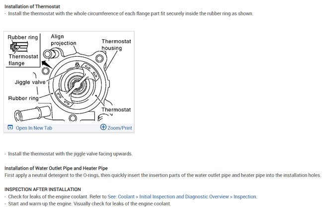

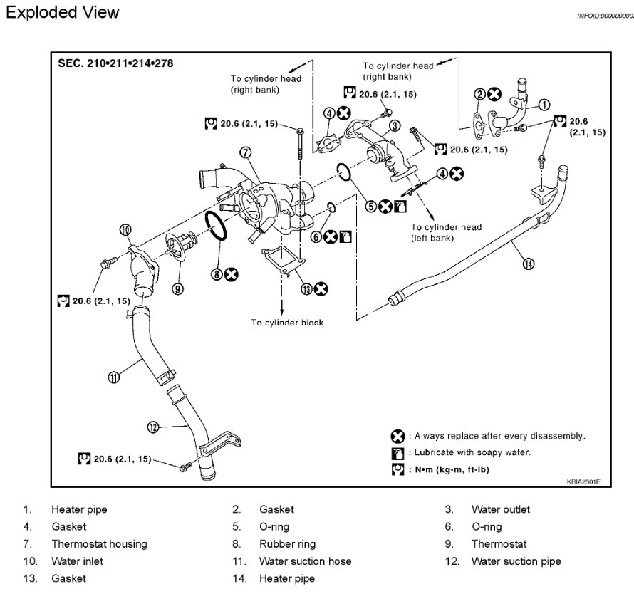

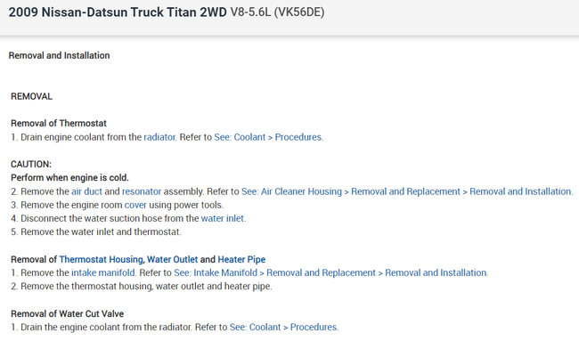

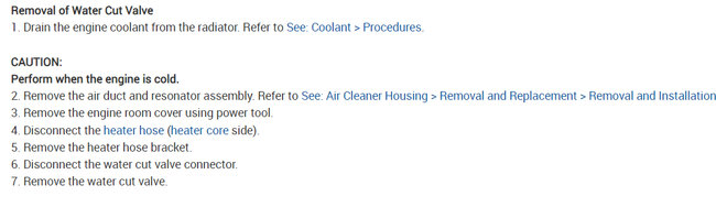

Yep, good call, radiators are not too bad price wise. Please let us know if you need any more help to get you through the repair job. Take your time and you will get through it. Please keep the coolant away from animals. It says you need to remove the intake manifold to replace the thermostat FYI. Please start a new question for the intake r&r instructions.
Here is how to change the thermostat to help you as well. Check out the images (below). Let us know if you need anything else.
