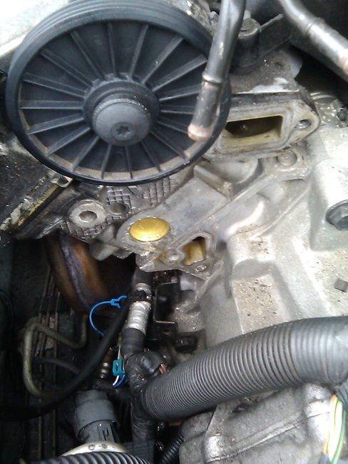

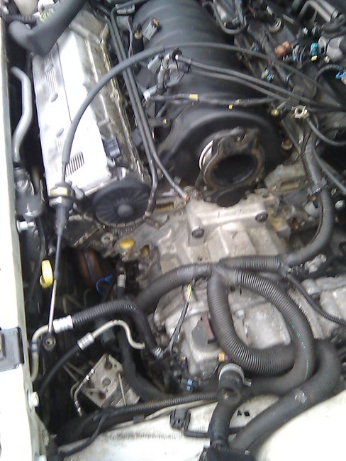

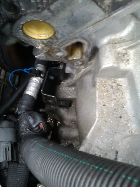

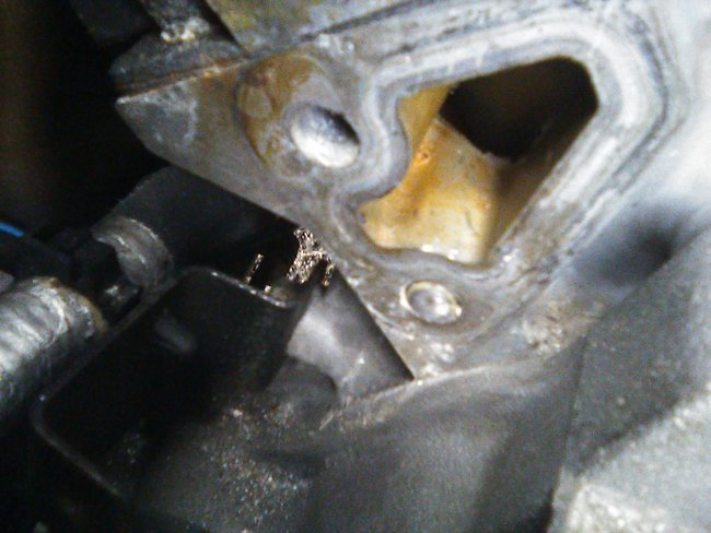

Removing bottom 4 bolts on coolant crossover housing. On front back bolt by transmission broke bolt flush with block coming out. I can only use a wrench on it. The car is not in a place to remove motor, transmission or both I need a way to get it out. The coolant crossover housing gaskets was leaking.

It's sitting in a parking lot, owners said I can't pull motor or transmission.

Someone ask if I tried welding a bolt or nut to it. Would that possible work or waste of time or make a bigger mess?
Saturday, January 18th, 2020 AT 4:42 PM
  • 52,797 POSTS
In the position it is located, no, it will not work. You have to work with what you have. Drill a small hole in the bolt and then drill larger to 1/4 inch.
