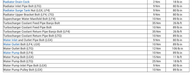

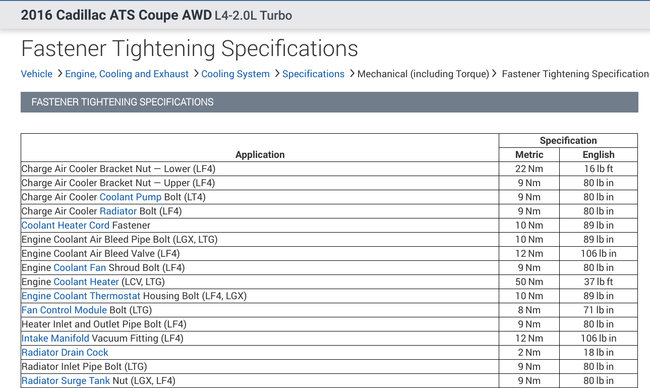

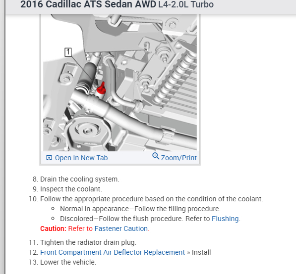

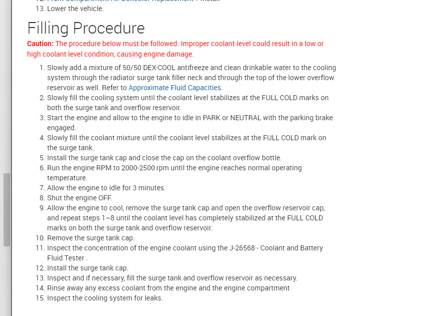

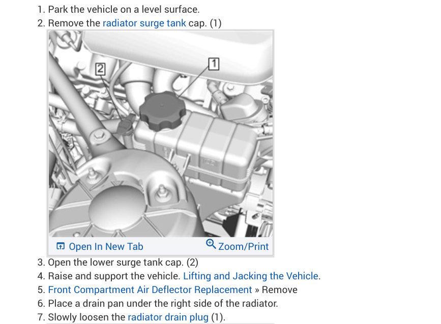

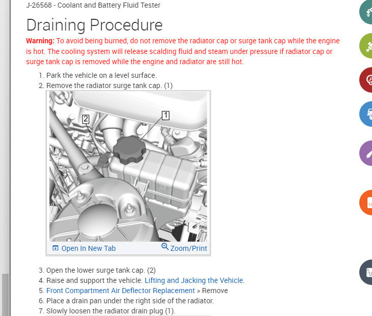

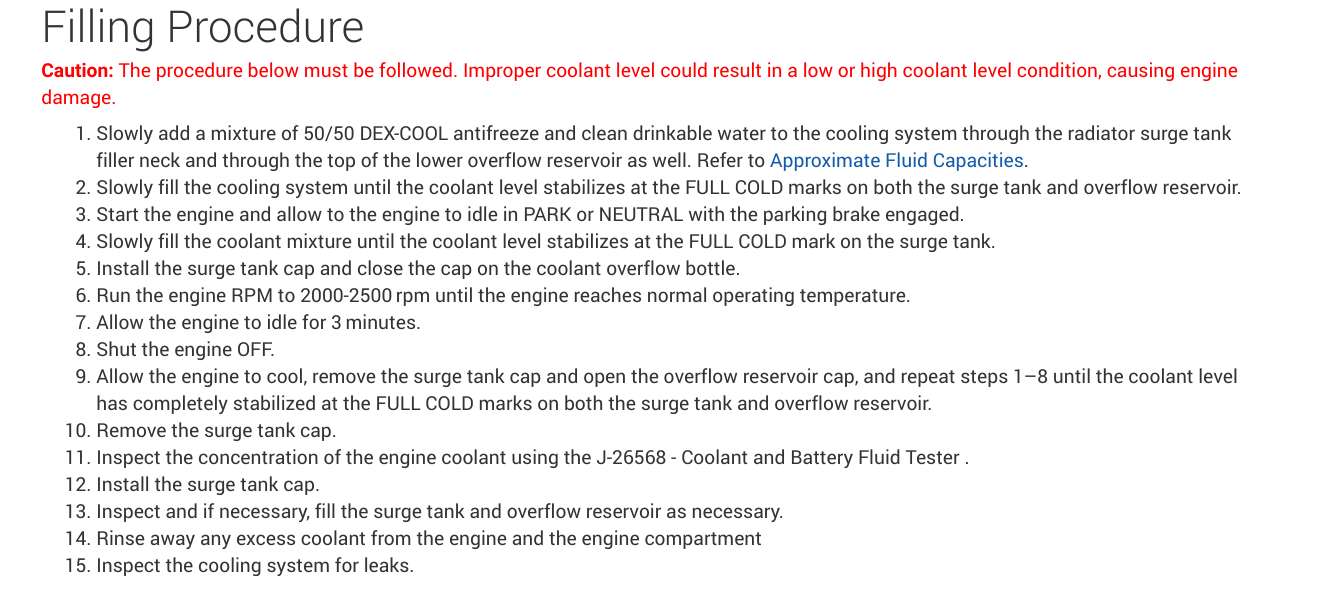

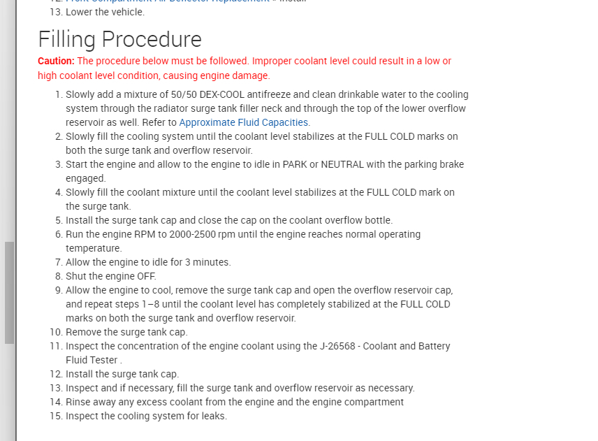

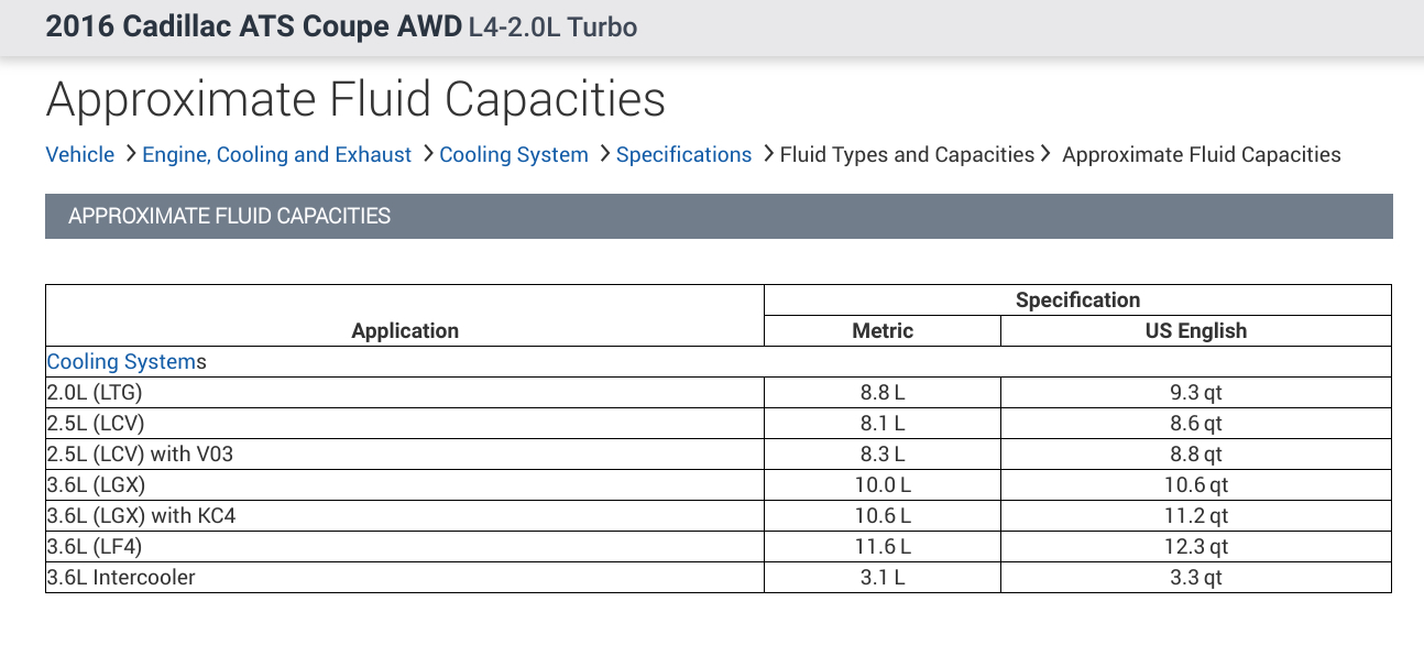

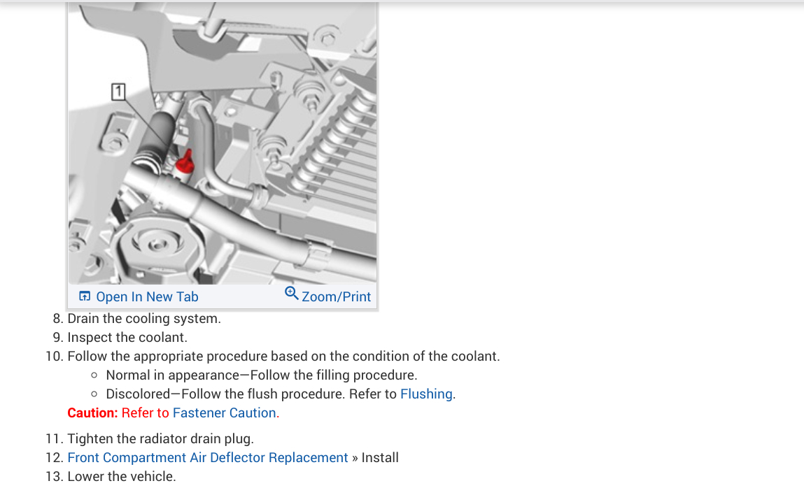

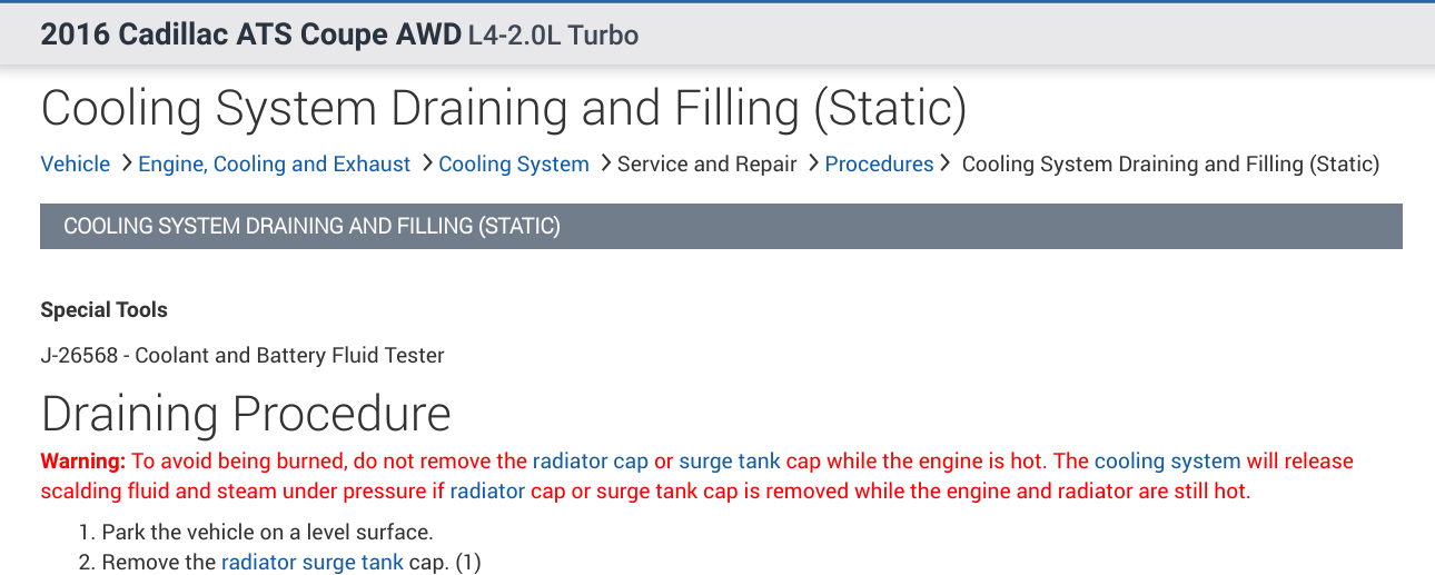

I just purchased this ATS. I want to replace the coolant. Would you please explain to me the proper steps in draining and replacing the coolant on this vehicle. I have previously obtained information from regarding changing the coolant on my Cruze, as it was the first closed/pressurized system I did and appreciated the information to prevent air bubbles from forming in the coolant system. Thank you in advance for your expert advice.
Mar 12, 2020 at 11:10 AM
SCGRANTURISMO
  • 4,897 POSTS

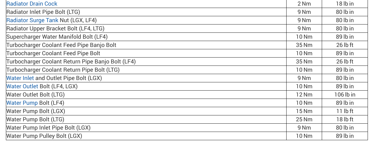

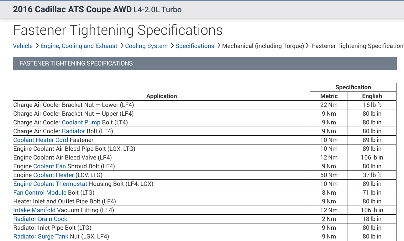

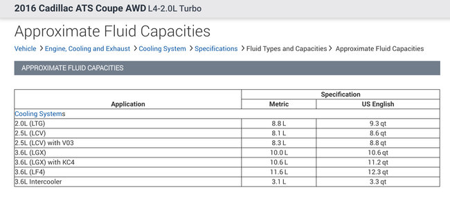

I have provided the information that you requested, the guide from the vehicle manufacturer for the draining and filling of your vehicle's cooling system in the diagrams down below. I also included the coolant capacities and fastener torque values for the cooling system as well. I hope that this helps.

Thank you so much. The information you sent is excellent and will enable me to change and replace the coolant correctly. I am very appreciative of the 2CarPros site and you being part of it.

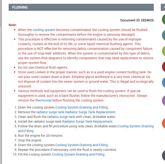

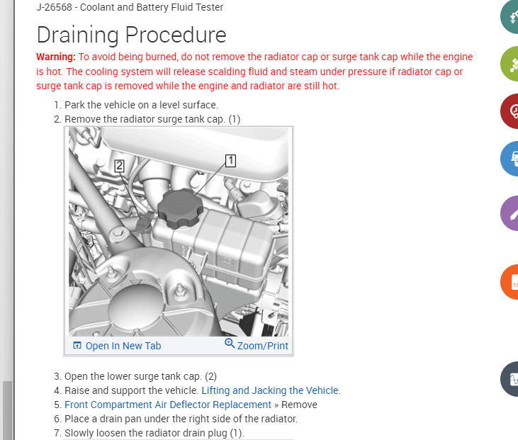

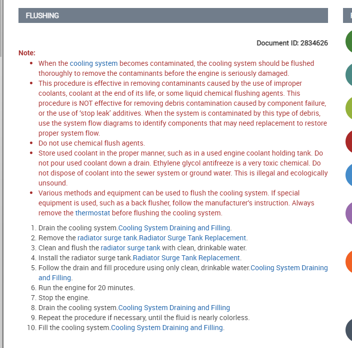

Hi there. Can you post the procedure for the system flush if the coolant is discolored?
Apr 23, 2022 at 6:20 AM
Sure. We also have a couple of guides that will help with this:
https://www.2carpros.com/articles/coolant-flush-and-refill-all-cars
Please see the info below from the manual that will give the specific detail you may need as well.
