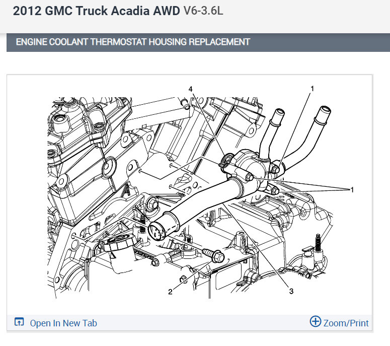

Coolant boiling but engine not overheating and decreasing became low in system after discharge at accumulator. What can cause and what to do?
May 13, 2024 at 9:13 PM
  • 55,402 POSTS

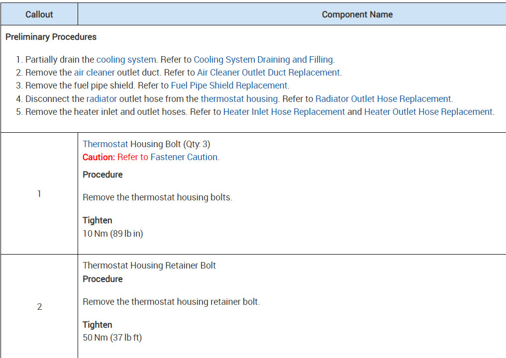

If the coolant is boiling then the engine is overheating, I would make sure there are no leaks and replace the radiator cap to start. How long does it take for the coolant to boil? If in a short drive, you could have a stuck thermostat which is common.
Here is a guide to help us:
https://www.2carpros.com/articles/engine-overheating-or-running-hot
Here is a generic guide to help you step by step with instructions in the diagrams below to show you how on your car.
Check out the images (below). Please upload pictures or videos in your response to any problems so we can see what to help you with.
