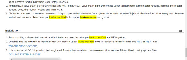

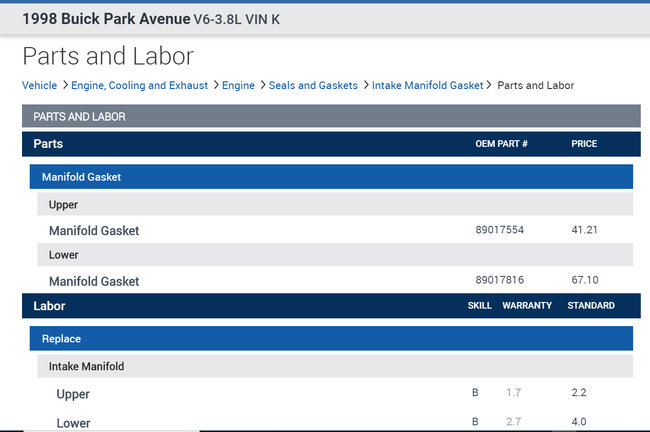

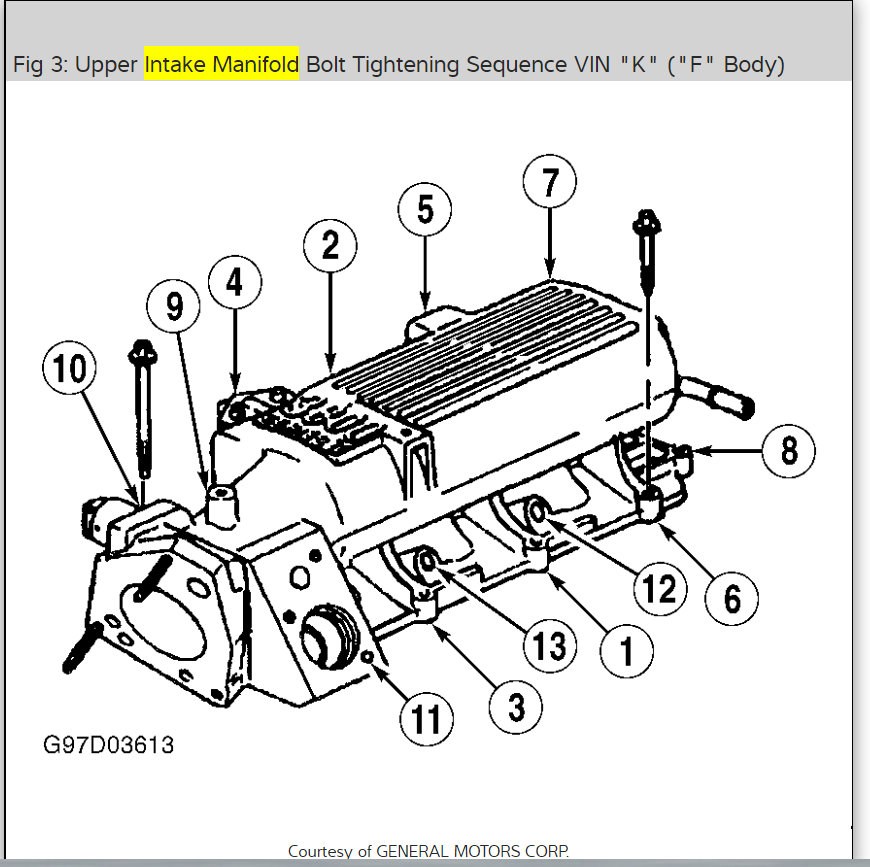

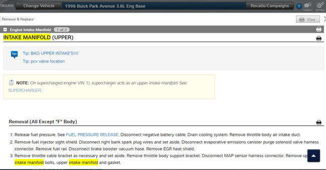

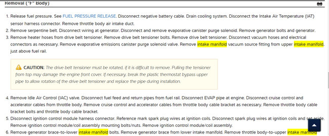

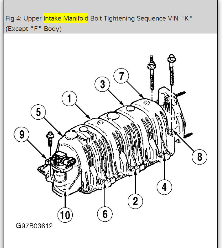

If the coolant isn't getting in the spark plug holes, or messing with any sensors or such, I guess it would be okay to drive like that as long as you kept I real good eye on your coolant level and Kept it filled up. Eventually the gasket will degrade enough that it will require replacement. In the diagrams below I have included step by step directions on how to replace it yourself if you wanted to. I also have sent along parts price and labor estimate for you if you decide to shop around to have a shop replace it for you. Either way, please get back to us with what's going on.
