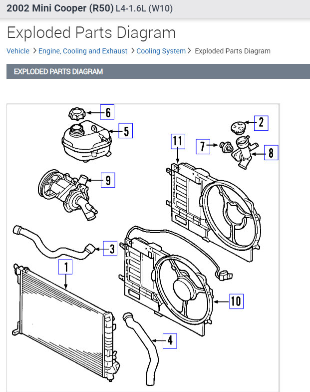

The coolant level needs topping up every other day.
Two days ago, the coolant reservoir was completely dry and water on road in front of the car. Refilled, and coolant stayed up to level for a day. I checked the oil cap, no gunk and no white smoke and car doesn't overheat.
The heaters are spot on. some days the coolant reservoir goes completely dry, other days it just gets low and has to be topped up,

Coolant can leak from a number of places. It could leak from the water pump, radiator, any of the hoses, thermostat housing, the radiator cap.
The best course of action would be to do a thorough inspection of the trouble areas to find the leak.
Take a look at this helpful guide. It covers the typical coolant leak areas and what to look for.
https://www.2carpros.com/articles/car-is-leaking-coolant
Let me know what you find or if you have any questions.

When you fill the coolant park your car is on level dry ground and try to see where the coolant is leaking out of, you may need to pressure test the system to find the leak. this guide can help us:
https://www.2carpros.com/articles/radiator-pressure-test
