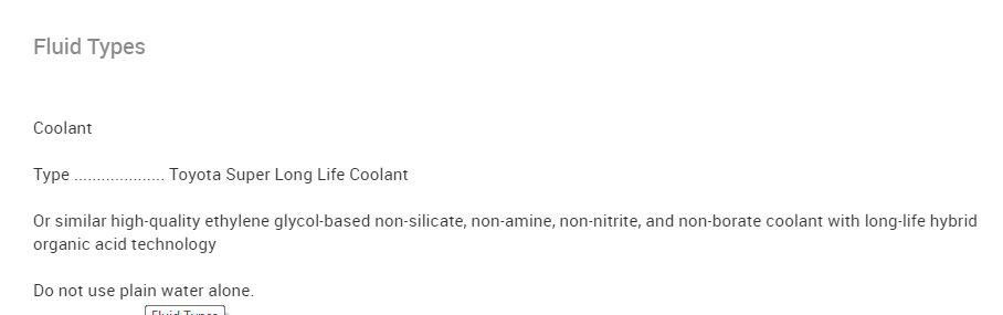

I just put some prestone 50/50 all type make and model car coolant in my car. now I am reading i shouldn’t have?

Hi David,
Your coolant type is called Hybrid Organic Acid Technology or HOAT. You must use this type of coolant so look on the bottle and see it is HOAT coolant.
If it does not say it is HOAT coolant, then you will want to get that out ASAP because it will not mix properly and could congeal.
The color of the coolant doesn't matter so much even though the dealer will give you a hard time if the color is not correct and you are having issues that would be covered under warranty. It looks like you may still have some warranty left based on age and mileage so I would recommend you get it drained and filled with the recommended fluid either way. If it is not HOAT fluid then you need to do it sooner than later.
Lastly, just make sure it says that it is HOAT fluid and not HOAT compatible because that is different.
Let me know if you have any other questions. Thanks
Jun 27, 2019 at 4:16 PM

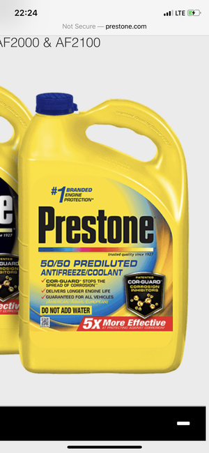

DAVID MORENO
This was the coolant I used! How urgent do I need to get it drained?
Jun 27, 2019 at 8:25 PM
DAVID MORENO
This is the coolant I used! Should I get it flushed tomorrow as soon as possible?
Jun 28, 2019 at 9:01 AM (Merged)
Okay. Sorry for the delay but I ran over to the auto parts store yesterday and read the bottle and the all makes does not specifically say what it is. This means it is not specifically HOAT coolant.
Prestone says it will not cause any issues however,if you do and the dealership finds this coolant then they more than likely will deny the claim and Prestone more than likely will not pay either because they say it does not cause an issue. This leaves you stuck in the middle.
According to prestone, it will not cause an issue but this coolant is called OAT, Organic Acid Technology. It is said to be compatible with all other types of coolant but the OEM says to use HOAT. This is what I would use.
I would suggest making plans in the near future to just have the entire system flushed and factory coolant installed. Once you are out of warranty, then you can decide to trust Prestone but I would stick with what Toyota recommends because they know your engine better than anyone else.
