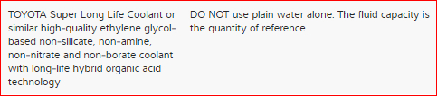

Are all coolant brands the same? Can it be mixed? That is, you put coolant brand X to your car coolant reservoir and put coolant brand Y for refilling? Thank you

I have attached a picture of your vehicles coolant requirement. It will be pink in color. Check out the diagrams (Below). Please let us know what happens. Hope this helps and thanks for using 2CarPros. Danny-
