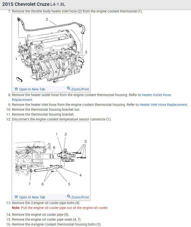

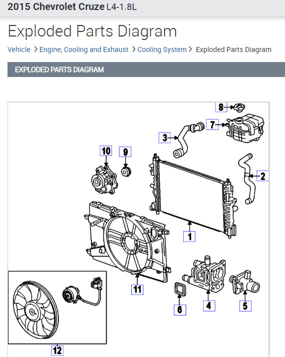

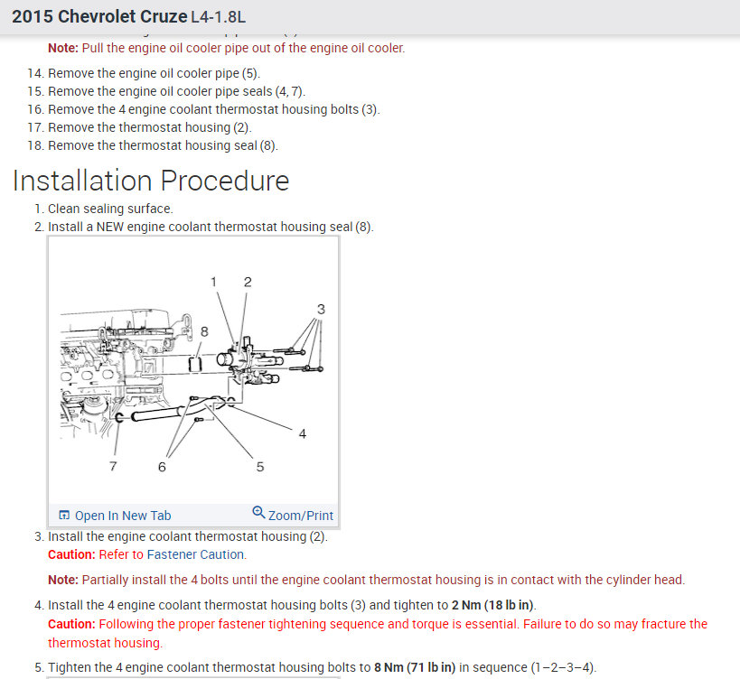

Recently my engine coolant has been disappearing and putting the cooling fan to work. When I open the coolant reservoir the coolant suddenly reappears at a boiling temperature. What can be the issues to this ?
Sep 21, 2021 at 8:37 PM
SQM
  • 6,383 POSTS
It sounds like your engine might be overheating.
When you get the overheated coolant on the reservoir, where does the temperature show on the gauge?
Have a look this article, it goes thru the typical overheating issues:
https://www.2carpros.com/articles/symptoms-of-an-overheating-engine

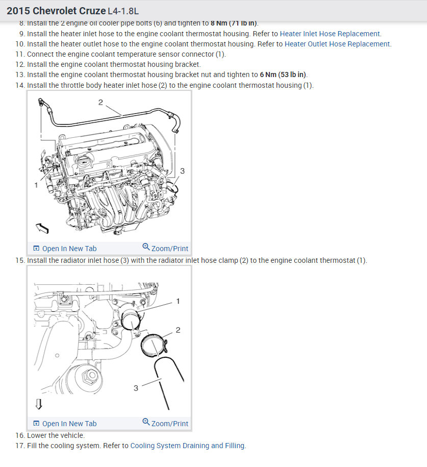

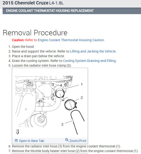

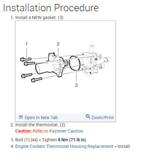

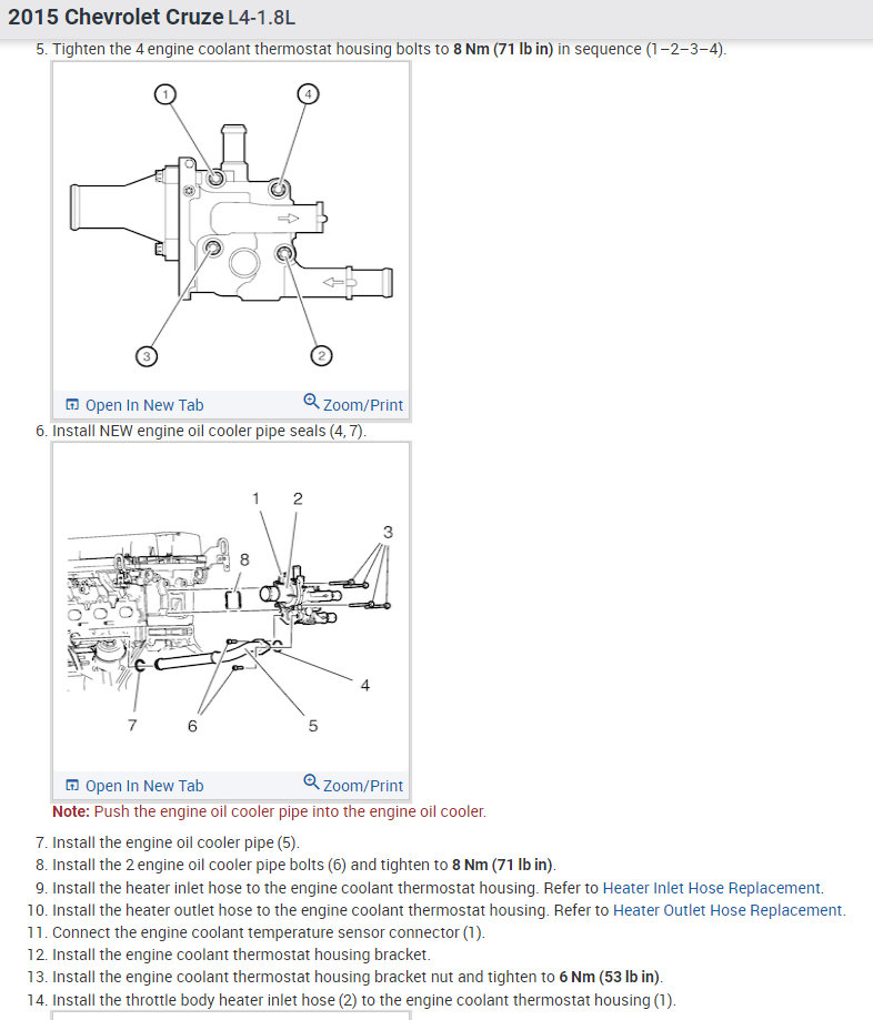

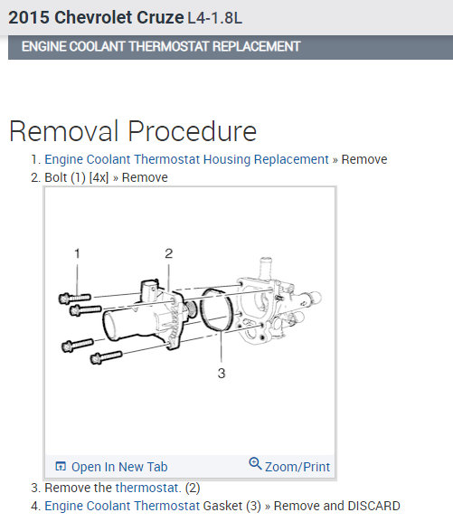

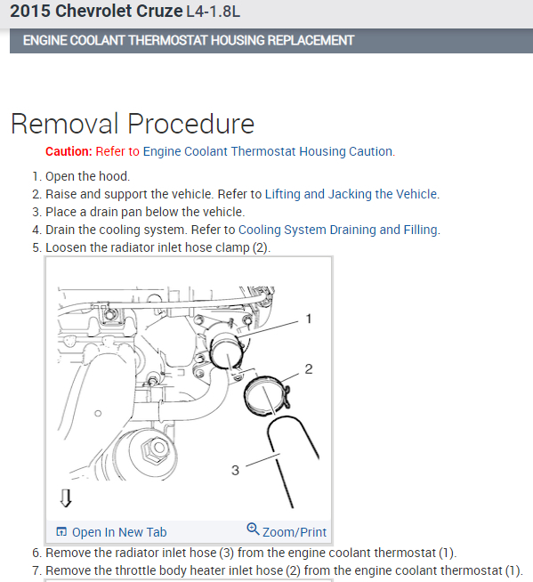

One of most common issues for overheating is a stuck closed thermostat. When this happens it won't allow the coolant to flow through the engine and can back up the coolant to the reservoir.
https://www.2carpros.com/articles/how-an-engine-thermostat-works
Please let me know what you are experiencing.
