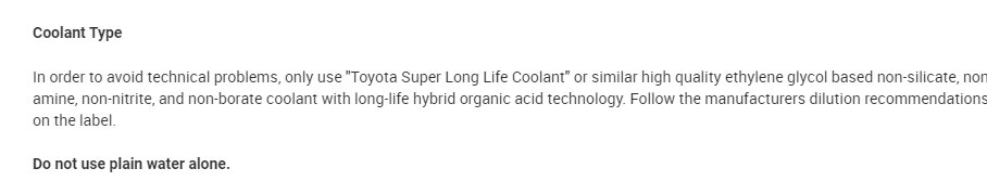

can i use this type of pink coolant?
https://www.napaonline.com/en/p/AORACT002
instead of Toyota super long life coolant 2.
sllc2
Jul 10, 2020 at 12:38 PM
Looks like this is compatible according to the coolant company. I am always hesitant trusting them but this one looks pretty safe. Especially since the manual says to use the Super Long Life coolant or similar high quality coolant then I am sure you will be fine. I would just make sure the bottle of coolant says it is HOAT coolant. If not, I would reconsider.
I attached all the detail that this coolant needs to be if it is not the super long.
Let me know if you have other questions. Thanks
