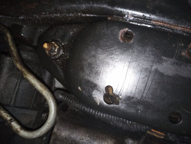

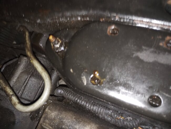

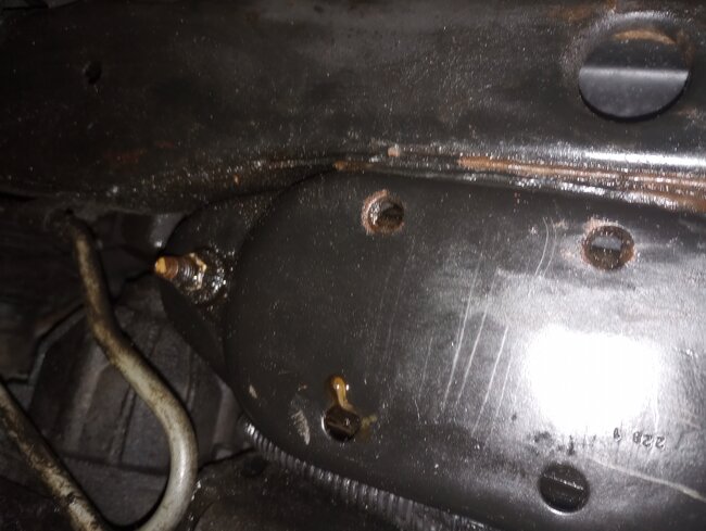

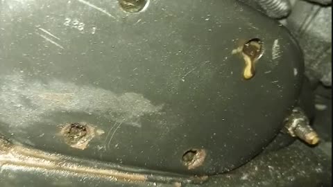

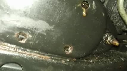

Thank you, I used universal coolant after flushing all the blue out, now my question is do you have any idea what this is leaking? I saw this while I was under the car looks like oil. But it also looks muddy for some reason, any ideas?

That appears to be engine oil. If you notice it uses oil, I have a favor to ask. Because it is a different issue than the coolant, I need you to start a new post. We do this because it makes the thread more helpful to others. I hope you understand. If that is the case, here is the link to start a new post:
If you feel it is something other, let me know.
