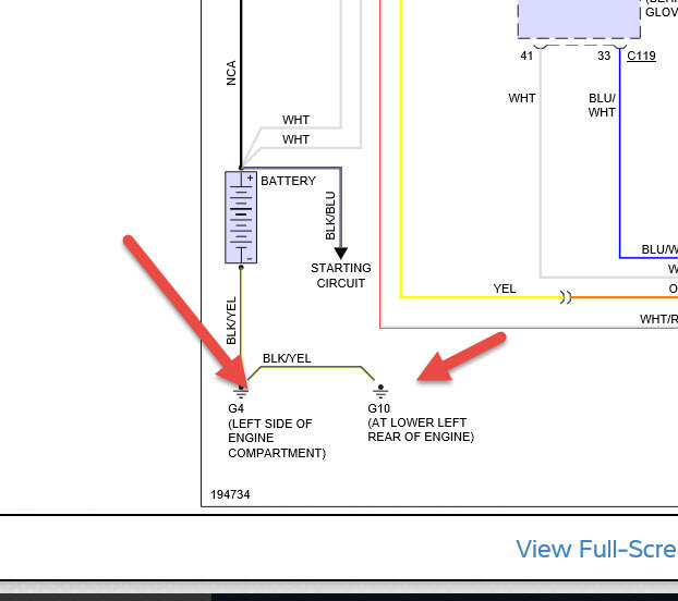

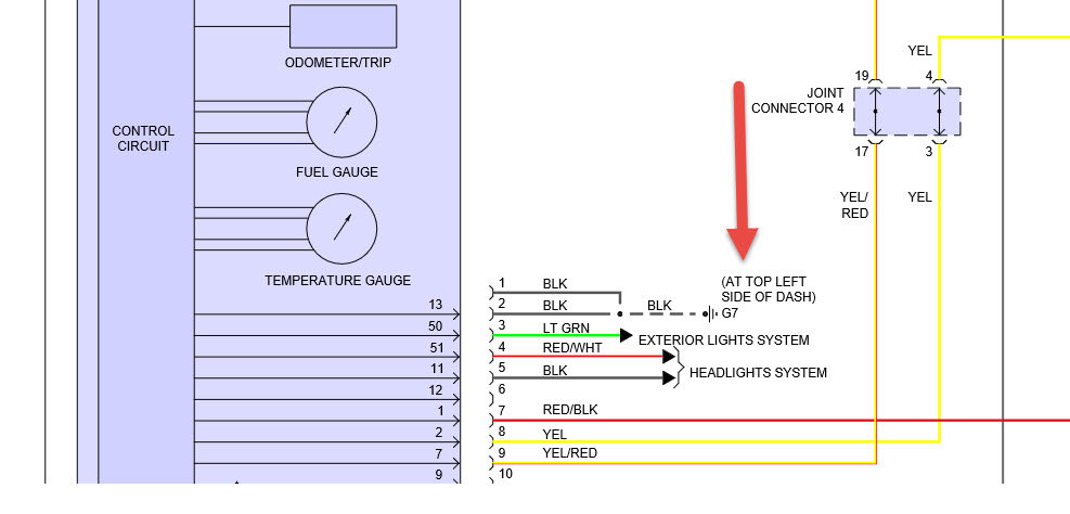

My gauges for my hot and cold goes all the way to the hot almost instantly I don't lose any coolant but I turn on the heater and in a few minutes my gauges goes back to normal between the hot and cold checked my coolant it is good have any ideas?

check ground wires for dash and check to make sure there is a good connection at cluster. also check he yellow wire in engine compartment for wear and may be touching engine block . if you have that then put tape or auto conduit on it.
